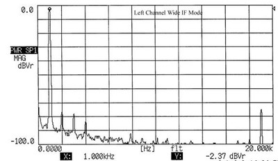

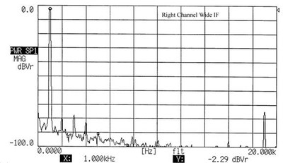

The first two plots below show the 20 kHz response to a 100% modulation signal in the left channel, then right channel, in wide IF mode. This plot shows the harmonics, the averaged noise floor, and 19 kHz pilot leakage.
Figure 1 – 1kHz, 100% FM modulation, left channel, wide IF mode.
Figure 2 – 1kHz, 100% FM modulation, right channel, wide IF mode.

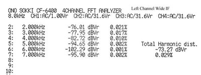

Figure 3 – Harmonic Distortion table from 8 kHz BW FFT spectrum, left channel, wide IF mode, 0.029%.

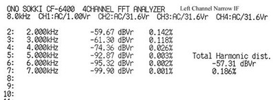

Figure 4 – Harmonic Distortion table from 8 kHz BW FFT spectrum, left channel, narrow IF mode, 0.186%.
Figure 5 – Separation in Right channel, wide IF mode, 67 dB.

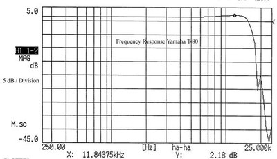

Figure 6 – Frequency Response from 250Hz to 25kHz. Response was plus 0.4dB at 12kHz, minus 3dB at 17kHz, -25dB at 19kHz.

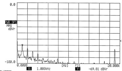

Dan asked me to look specifically at the noise floor of his modified tuner, as he had made improvements in the ground scheme, as well as replaced many components like resistors with low noise types. Figure 7 shows the comparison of my stock freshly aligned T-80 versus Dan’s modified unit. The measurement was made in stereo, very similar to the way separation in figure 5 is measured – the 100% modulation 1kHz signal was applied to one channel, while the measurement was taken on the opposite channel (25 power spectra averages). As shown in figure 5 above, the remaining other channel signal (you don’t have infinite separation), pilot, distortion, etc. (plus noise floor) remain in the plot. For definition, I’ll call everything except the flattish noise floor “spurs”. For figure 7 below, I ignored all of those mentioned “spurs”, and simply looked at the averaged noise floor from DC to 20kHz. The FFT analyzer input setting was adjusted to a lower input level, so these very low relative levels could be seen. As in the above plots, the normal 100% output level was –2.29 dBVr. Remember, these noise floor numbers correspond to 20,000/800 lines = 25 Hz wide bandwidth FFT bins, and cannot be directly compared to wideband signal to noise ratios commonly seen in spec sheets (those numbers should also include some, but not all of the above spurs). But they do have merit for direct comparison of one tuner against another.
Figure 7 - Noise Floor, Bob’s Stock T-80 vs. Dan’s modified T-80
Overall, in listening tests, Dan’s modified tuner easily surpassed the stock Yamaha T-80 in all areas, with a better weight and articulation in the bass, more articulation in the midrange, and a slightly cleaner presentation in the highs. As the above data shows, with strong input signals, the averaged noise floor is also clearly better, from 4-9 dB better depending on the frequency. In general, it was one of the best sounding tuners that I have the pleasure of listening to in my system.
