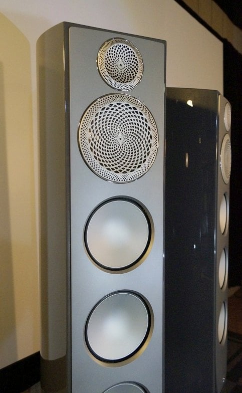

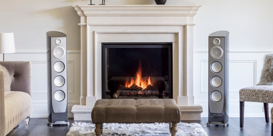

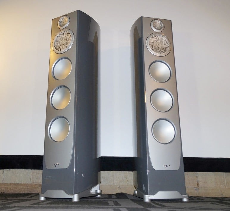

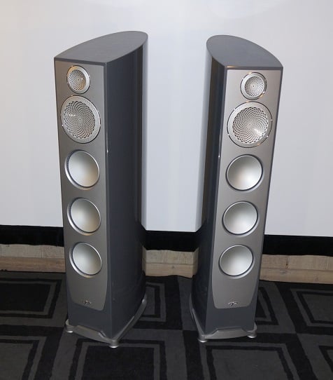

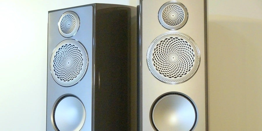

The Persona speakers look unique and are quite attractive for floor-standing speakers. They have a very modern feel with clean lines and curved cabinetry. The silver metallic gloss finish of my review model 5F speakers reminded me of an automotive aesthetic; more specifically like that of a Porsche. The automotive analogue of Porsche would seem to be apt, considering the pricing. The tweeter and midwoofer have in-built grilles that have a mesmerizing fractal swirl pattern. Supposedly this pattern serves a functional purpose, but we will discuss that in the design overview. The clean styling, smooth silver satin cones, and ornate grilles set the Persona speakers apart from any others. The grilles are bound to make the Persona speakers instantly recognizable among audio enthusiasts, so these speakers are certainly not going to be mistaken for another line or another manufacturer.
Persona_full_length2c    Persona_upper_drivers
The Personas are boldly styled, so they will not easily disappear into a room, especially in homes with more traditional decor. Guests will notice them. Certainly, those interested buyers are aware of that, and their appearance is likely a draw for their targeted customer market. There will be those who instantly rule out owning speakers of such an audacious appearance, but I personally think they are quite fetching.

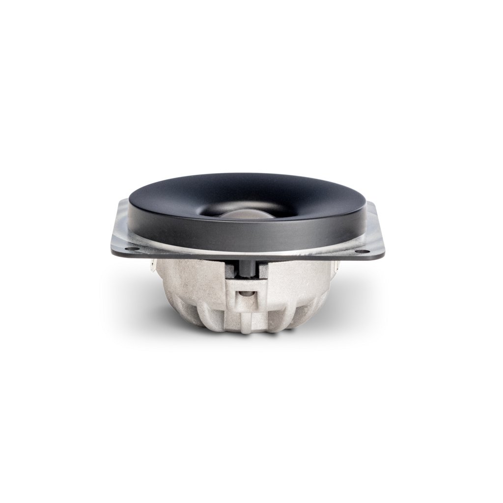

From a design perspective, the most striking feature of the Persona 5F is the use of beryllium for the tweeter diaphragm and especially for the mid-woofer cone. Beryllium is an expensive metal used in high-end speakers but mostly just for tweeters. It is rarely used as a cone diaphragm mainly due to the prohibitive cost. However, a relatively large speaker manufacturer like Paradigm can bring down the cost by producing much larger quantities of beryllium cones than what is normally made using this material.
Persona_tweeter  Persona_midwoofer
Persona tweeter and mid-woofer
A great explanation of the reason why beryllium is such a desirous material for driver diaphragms is found in this Audioholics article: Identifying Legitimately High Fidelity Loudspeakers: Speaker Diaphragm Material. For a brief and basic explanation, beryllium is a very light metal (30% lighter than Aluminum) and extremely stiff (4 times stiffer than Aluminum) with great damping. Other metals such as aluminum and titanium being heavier and less stiff bend and flex in rapid motions more easily than beryllium. This means that cones made out of aluminum and titanium lose their uniform motion at lower frequency oscillations than beryllium, or, to put it another way, aluminum and titanium cones will start to bend and flex at frequencies that beryllium is able to maintain its shape.

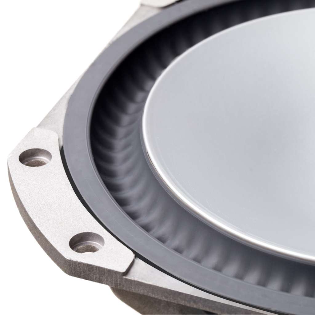

Persona_ribbed_surroundBeryllium’s ability to hold its shape for a greater frequency band is a big advantage for driver performance. When cones start to flex, this is called cone break-up, and it can have serious negative consequences for sound reproduction. What is normally seen when cones begin to breakup is a very erratic frequency response; large spikes of upper-frequency resonance that can sound pretty bad. For soft cones such as paper or polypropylene, the breakup resonances can be mild, but as a result of that material’s softness, they do not play high frequencies nearly as well as stiffer metal cones. What can be had with a beryllium cone is a driver that can play to relatively high frequencies without the intrusion of breakup. This is true for both the tweeter diaphragm as well as mid-woofer cone.

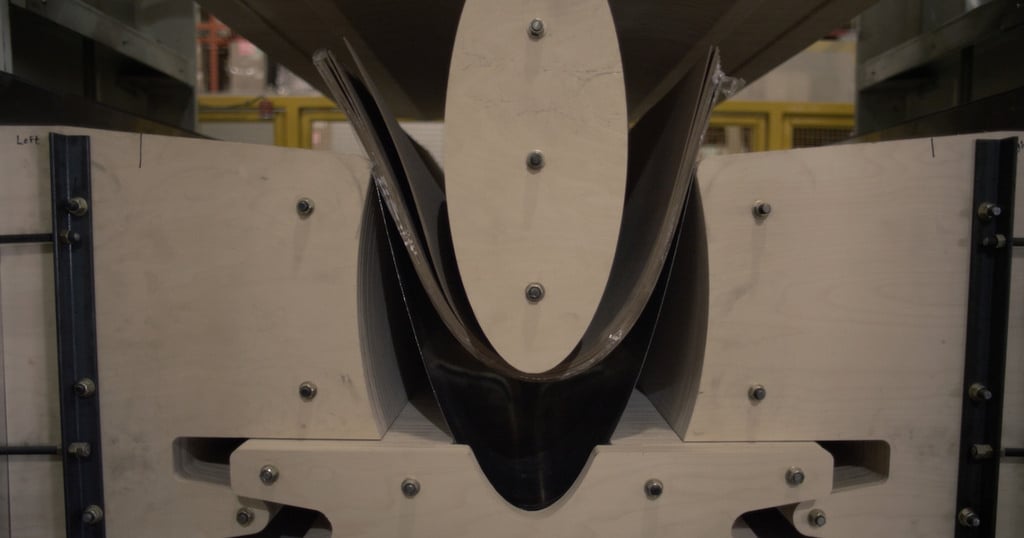

The special design features of the Persona 5F do not stop at beryllium diaphragms. While those might be the crown jewels of the Persona line, these speakers have a list of features and innovations. Paradigm has employed a patented ribbed surround that they call Active Ridge Technology (A.R.T.), which supposedly allows for more headroom than conventional half-roll designs. When typical surrounds are stretched at high excursions, particularly in the inward-stroke, deformations can occur from the high tension, and these deformations can cause distortion or even tears in the surround. This ridged surround design by Paradigm supposedly reduces these deformations by directing material stress to points that can better cope with it due to the shape of the surround. Paradigm claims that A.R.T allows 1.5 times the excursion for the same surround roll that results in a 3 dB increase in headroom. While I find Paradigm’s claims of a 3 dB increase in headroom from this technology rather optimistic, the idea is still interesting and could plausibly offer improvements over conventional surround design.
 Persona_cabinet_manufacturing
Manufacture of the Persona cabinet: layers of HDF being pressed into shape with adhesive
Paradigm has gone to great lengths in engineering a top-notch cabinet as well. The cabinet is essentially a rounded shell that attaches to the front baffle. The ‘shell’ is made from seven layers of high-density fiberboard glued together with a viscoelastic adhesive. Viscoelastic material is ideal for damping resonances and isolating vibration, so a cabinet design like the Personas should be very well protected against acoustic resonances. The cabinet is heavily braced as well. The rounded construction and sloping top and bottom pieces assure no parallel surfaces, which will help to reduce internal cabinet standing waves. Rapping on the enclosure sides does not produce any lingering hollow decays, so the Persona 5F passes the elementary knock test quite well.

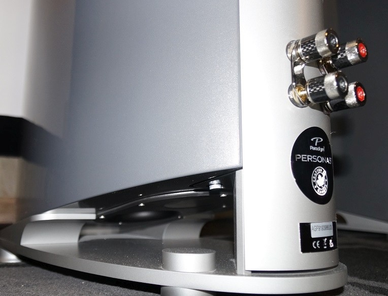

The Persona 5F is a ported speaker, and the port is cleverly hidden on the angled bottom of the cabinet. This does away with the need for a curved and therefore more turbulent and noisier port in order to achieve a lower tuning point, since the port runs along the length of the cabinet where there is more distance. The cabinet stands on a platform that the feet are attached to. The Persona 5F comes with rubber discs and spiked feet, so the user has a choice in style of feet.
Persona_portC
The 5F speakers have some slick-looking binding posts with a carbon-fiber weave on them. There are two sets of binding posts that can be connected using a nickel plate. The Persona 5F speakers are bi-amplifiable, so you can drive the bass section with a different amplifier than the mid-woofer and tweeter. In theory, this will help reduce intermodulation distortion.

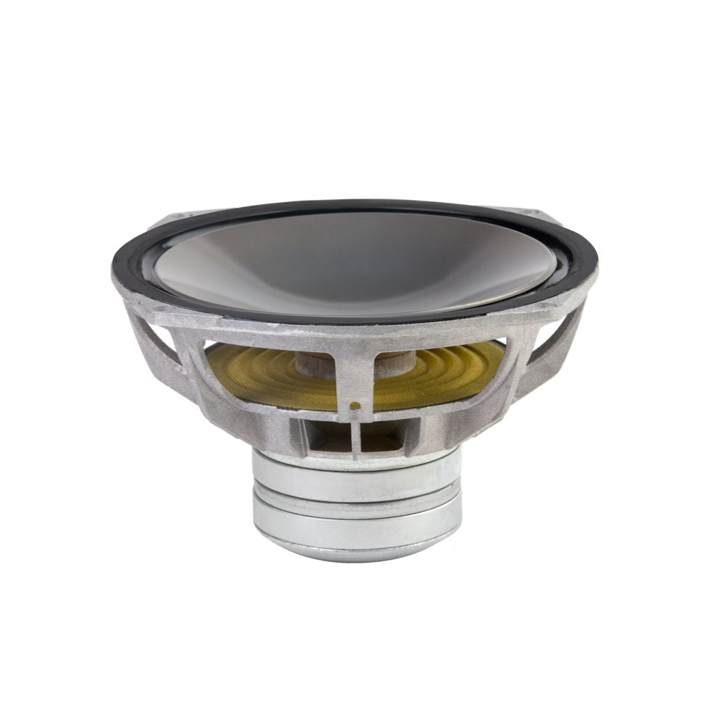

The bass drivers are crossed over low enough that they would not benefit from this type of device. To handle the bass, the Persona 5F uses three 7” drivers with anodized aluminum cones that Paradigm calls ‘X-PAL’ woofers. That should enable it to move quite a bit of air, although it won’t compete with a beefy subwoofer for deep bass output. For music frequencies of 40 Hz and above, it should be able to get very loud with enough amplification. The bass drivers hand over the frequency spectrum to the midwoofer at 450 Hz at a 3rd-order slope, and the mid-woofer takes over up to 2.4 kHz where it crosses over to the tweeter at another 3rd-order slope. In their promotional material for the Persona speakers, Paradigm boasts the use of large polypropylene capacitors in their crossover circuit which would be good for higher voltage allowance and a longer life than typical capacitors.

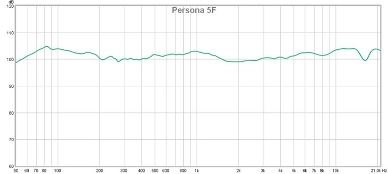

Paradigm Persona 5F Loudspeaker Measurements and Analysis

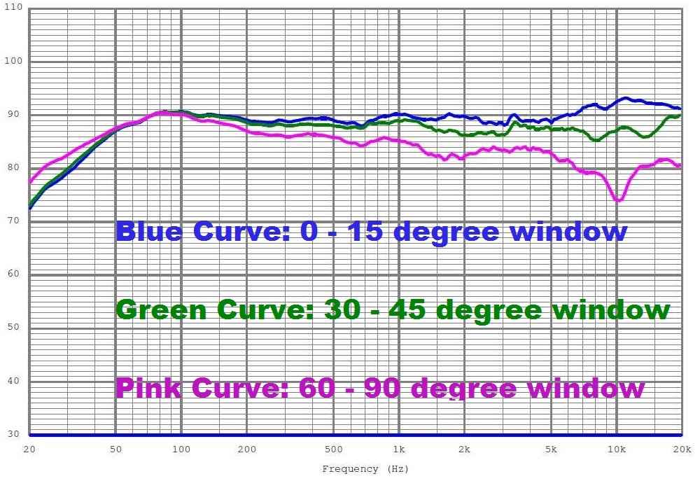

The Paradigm Persona 5F makes this section of my review a bit difficult. I normally do free-air testing of review units, but that means taking them out to my test site, propping them up on some kind of platform where I can get enough of a distance from the ground to be able to measure the frequency response without too much interference from acoustic reflections from the ground. It is not without risk to the review units. Since the review units I normally test are not terribly expensive, it is worth the risk to bring the reader a comprehensive report on the loudspeaker’s performance. The Persona 5F speakers are quite expensive and not easily manageable since they are somewhat large and almost 100 lbs. each. I decided to forgo regular free-air testing since there was a real chance of having the speaker sustain serious damage.
In lieu of my regular measurements, I have asked Paradigm if they could provide me with a frequency response from their own testing. Paradigm has the largest anechoic chamber in North America, and their measurements are bound to be extremely good. I then set out to confirm their response shape with close mic measurements of the Persona 5F drivers. Close mic measuring the drivers is not a great way to establish the overall response of a speaker like the Persona 5F, but it can give us a peek at the response of the individual drivers.
Paradigms_measurements
Paradigm Persona 5F frequency response
The above chart exhibits the frequency response of the Persona 5F as measured by Paradigm. They are windows of both horizontal and vertical response measurements taken at a two-meter distance in 15-degree increments and then averaged. We see the direct axis to 15-degree angle measures extraordinarily flat up to 5 kHz where we see a slight rise in treble centered around 10 kHz. The 30 degree to 45-degree window is still very flat with a slight drop around 2 kHz and a more significant drop after 5 kHz. This angle should provide a ‘warm’ sound, as opposed to a potentially brighter sound found around the direct axis. If you like a bright sound, these should be listened to facing the listener directly. If you prefer a more laid back sound, simply position them facing straight forward at a parallel angle, so that if the listening position forms a triangle with the speaker, the listener will be roughly 30 to 40 degrees off of the direct axis.
We can see from the frequency response windows that the Persona 5F speakers have a very wide dispersion. They will be able to cover a large listening area with a smooth, even sound.
The engineering in this speaker is serious: the Persona 5F responses are a demonstration of Paradigm’s extensive expertise and resources leveraged to produce a truly high-fidelity loudspeaker.
average
Paradigm Persona 5F frequency response averaged from close-mic measurements

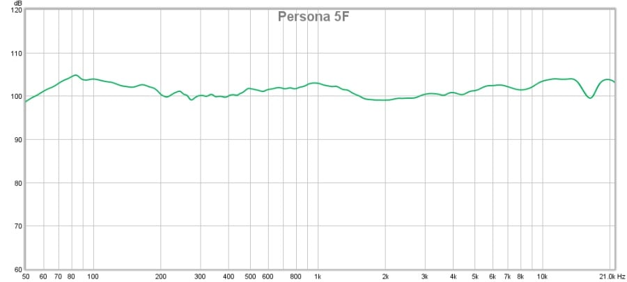

The above graph depicts my own measurements of the Persona 5F. It is an average of close-microphone measurements. I set the microphone one inch away from the tweeter, mid-woofer, and a bass driver, and measured sweep tones of the same voltage level. This measuring technique captures the response from the individual drivers. I then averaged the responses for the overall response. This is an imperfect measurement method and will miss significant aspects of the sound such as how well the drivers integrate into the far-field, phase issues, diffraction behavior, and so on. It can also exaggerate the low-frequency response, as it is doing on this graph. However, it can show driver misbehavior and reveal problems of that nature. No such problems were found in my measurements, and the dip around 16 kHz is probably just a phase cancellation due to the shape of the waveguide versus the distance of the microphone. If we pull the mic back a bit more, it disappears. The takeaway of this graph is that at the attractively flat response of Paradigm’s own measurements are certainly plausible and even probable were I to measure at a greater distance in more favorable conditions.

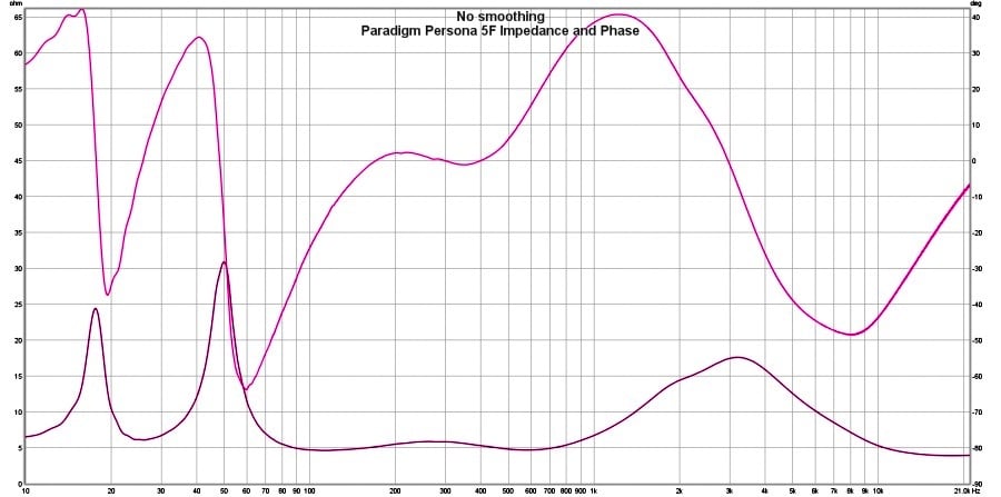

ImpedanceS
Paradigm Persona 5F impedance and phase measurements
The above graph shows the electrical impedance and phase of the Persona 5F speakers. This is not the most benign load on amplifiers, but it is not bad either. In the Persona 5F spec sheet, next to impedance, Paradigm simply lists it as being ‘compatible with 8 ohms.’ To put it bluntly, this is not an 8-ohm speaker. A large swath of most of the heavily used range in music and speech hovers around 5 ohms. That being said, most amplifiers should be able to tackle this load, although I would not want to try to drive these things with a cheap AVR (not that anyone who can afford these is going to drive them with one). Owners will want an amplifier rated for 4-ohm impedance loads to drive these speakers. The good news is there are no severe dips, and most of the steep phase angles occur at high impedance frequency bands. Again, we see the superb engineering that went into these speakers for having such a consistent electrical load; there are no nasty or heavily-taxing extremes shown here.
We can tell from the low-frequency saddle in this impedance graph that the port tuning of these speakers is in the mid 20’s Hz region. The bass from the Persona 5F drivers is real. Most people will be able to get by pretty easily without a subwoofer with these speakers.

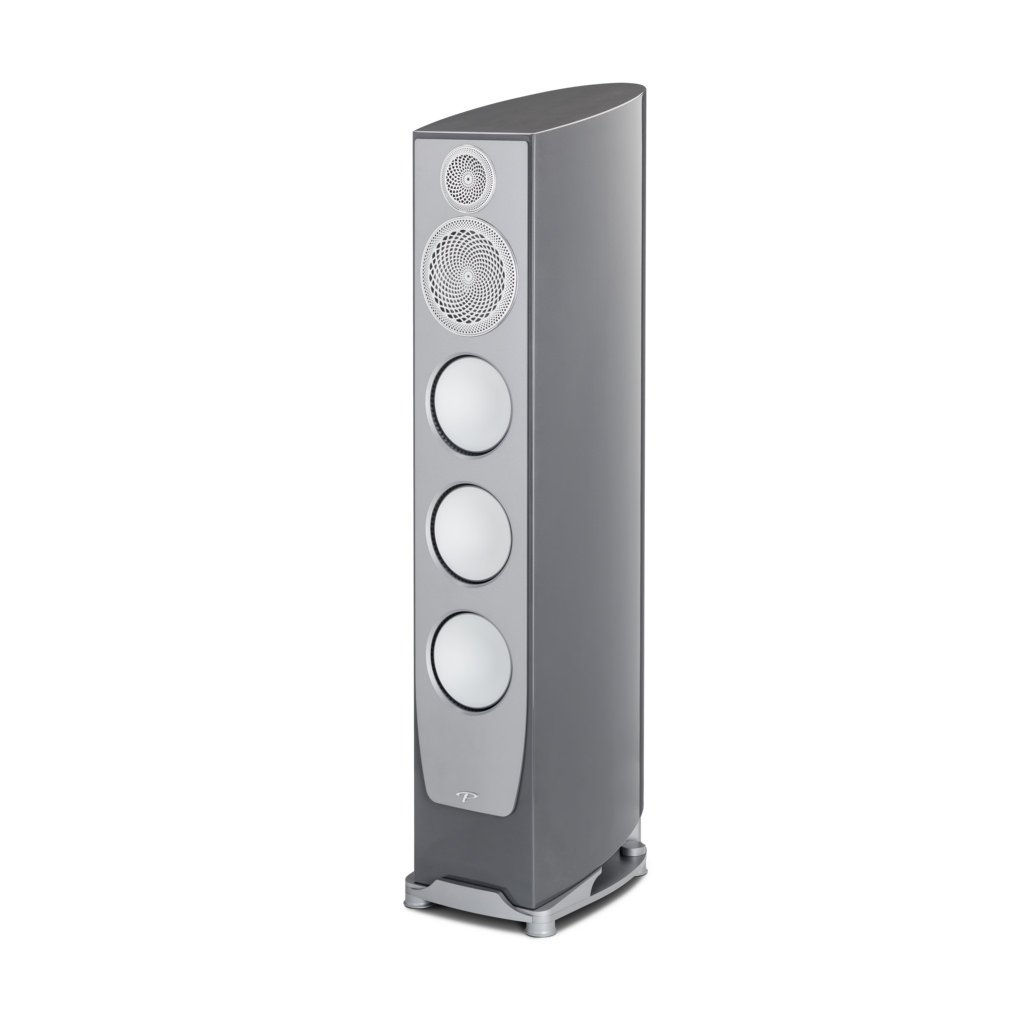

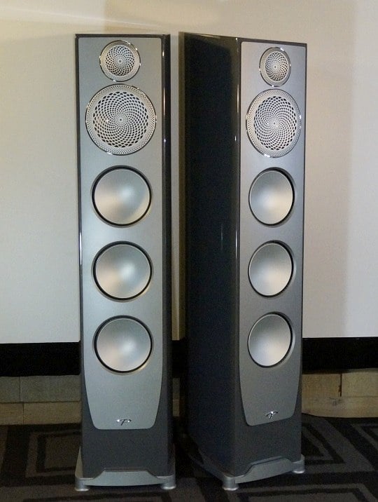

I really like the Persona 5F speaker, and that may be obvious to anyone who has read the review up to this point. Persona_pair_close5cIt is an outstanding floorstanding speaker: It sounds great, it is built well, it measures superbly, and it looks terrific. However, for the asking price, it had better tick all those checkboxes, because it is not an inexpensive speaker. ‘Expensive’ is, of course, relative; there are those for whom a pair of these would not be a considerable expense. But for most people, $17k is not a sum that can be spent on a whim. Furthermore, there is no shortage of solid loudspeakers around this price range: Monitor Audio, Revel, Kef, Focal, Bowers & Wilkins, Dali, Dynaudio, to name just a few. This naturally leads to the question: what does Paradigm bring to the game to distinguish themselves in this crowded market with these Persona 5F speakers?
One thing that sets them apart is that there are virtually no missteps in terms of sound. The upper treble is a tad hotter than perfectly neutral, but that can easily be equalized. This is not to say that the Persona 5F speakers are particularly forward or bright, which is not the case. They have a very good spectral balance and are simply a bit brighter than what might be termed a ‘warm’ sound signature. The midrange frequencies of the 5F speakers are easily the best of any speaker I have had in my home thus far. I cannot imagine a loudspeaker with more midrange clarity; in this range the Persona 5F were superb. The bass felt natural and not boosted or otherwise disconnected from the rest of the sound. It was powerful when it needed to be and extended quite deeply for a tower speaker of its size. The dispersion is wide and uniform, so they will have very good coverage across a large listening area instead of a single ‘sweet spot.’ The Persona 5F speakers have enough dynamic range to handle a good sized room too. They can get loud and have no problems doing so, and their imaging and soundstage is also terrific.
Persona_emblemC
the detail and clarity of the Persona 5F midrange was eye-opening.
Their build quality and appearance are excellent, as one would expect at this price point. As I noted before, their styling is reminiscent of a high-end luxury car. The designs of the grilles on the mid-woofer and tweeter are distinctive and very telegenic. Aesthetics are a very subjective matter, however, and those looking for speakers that will fit in a traditional decor will be looking for wood finishes or at least muted color schemes, will not find the Persona speakers to be aesthetically compatible with their decor. But I do think most people will find them to be very appealing to look at.
