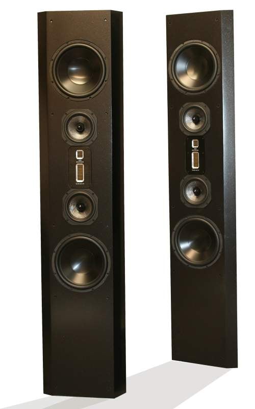

Lifestyle speakers. For many audiophiles, the phrase invokes visions of soundbars or tiny cubes with mediocre sound quality. Bill Dudleston and the folks at Legacy Audio might hope to change a few minds with their latest creation: the Legacy Audio Theater Tower. Not to be mistaken for your average lifestyle speaker, the Theater Towers are massive loudspeakers measuring a whopping 78" tall by 14.5" wide and tipping the scales at 200 pounds. Am I out of my mind calling these lifestyle speakers? Perhaps, but it’s also worth considering that these speakers are only 10.5" deep and are designed to be placed up against your wall. In other words, while they're certainly imposing loudspeakers, the Theater Towers demand little in the way of effective floor space compared with even your average rear ported stand mount loudspeaker, let alone a monster like Legacy's Aeris.
Now if you've followed Audioholics' coverage of Legacy in the past, you might guess that the Theater Towers aren't exactly inexpensive. Listing at $12,000/pair in a base black finish, with optional finishes and custom designs potentially running the price up to $18,500, these won't be mistaken for budget models. Nonetheless, while the cost is high, you get a full range speaker complete with high power internal bass amplification and a full blown 4 input x 8 output DSP.

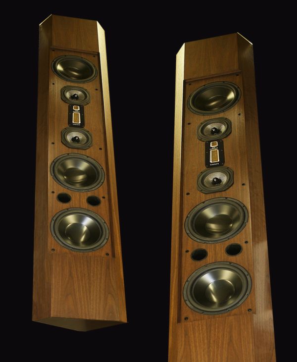

Legacy Theater Tower Custom
For a few more bucks, Legacy will give you an upgraded finish, not to mention various customization like a third woofer for added low end capability.

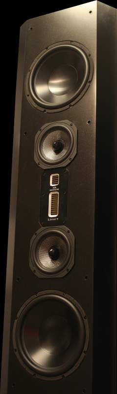

Legacy Audio Theater Tower Closeup
Needless to say, a pair of 12" subwoofers and 7" mid-woofers can move a fair amount of air.
