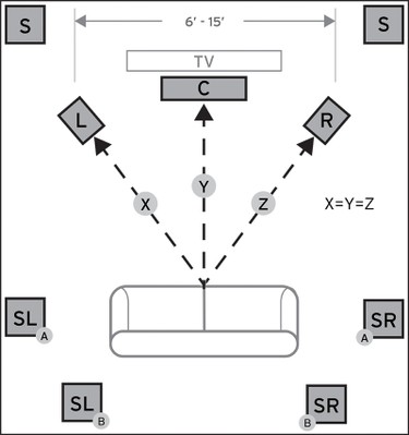

- Try to avoid placing the primary three front speakers on the ceiling. If they have to be above ear level, angle them down using a device such as the Auralex MoPAD or a proper mounting bracket that can support the speaker.
Integrating main loudspeakers into a home will always involve at least some compromise. Even a dedicated home theater or two-channel venue will mandate some give and take, maintaining balance between sound quality, aesthetics and other variables. It's important to maintain placement symmetry, proper positioning and calibration of the critical front three LCR speakers to ensure the best home theater experience possible.
7.2 Speaker Layout Scheme - Courtesy of Klipsch
Notice this system features dual subwoofers for better bass response across all seats.
For more information, see: Optimizing Front LCR Speaker Placement
