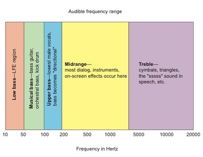

Now is a good time to present a few basic definitions for the sake of this conversation. We’ve talked a lot about bass, midrange and treble, so let’s define more precisely what we mean. Sound waves that vibrate or oscillate through the air are measured in cycles per second, or Hertz (named after German scientist Heinrich Hertz), commonly abbreviated as “Hz.” The frequency of sound waves audible to humans range from 20 Hz in the bass to 20,000 Hz (20 kHz) in the treble. (Well, women and young children can hear that high; a middle-aged man is lucky to make it much past 13-14 kHz. Your grandfather needs his hearing aid because his ears are toast by 3 kHz. That’s why he’s always saying, “Huh?”) See figure 1 for an explanation of what we generally refer to as bass, midrange and treble, expressed as Hz (LFE stands for “low-frequency effects”).
Audible Frequency Range
As you can see, the midrange—from roughly 200 Hz to 3,000 Hz—is where most of the “action” takes place. If an audio device can cover this range with reasonable accuracy, then people will regard it as doing a pretty good job of conveying intelligible information. Most TVs, phones, AM radios, PA announcement speakers in supermarkets, etc. cover this frequency range. It’s a wide enough frequency range that people can easily understand what is being said or recognize musical melodies, but it’s nowhere near wide-ranging enough to be considered high fidelity.
For that, the audio device—in this case, speakers—must be able to reproduce far deeper into the bass and reach much higher into the treble. However, the range of frequencies covered by an audio device is just part of the story. Just as important—even more so—is the concept of flat, accurate frequency response.

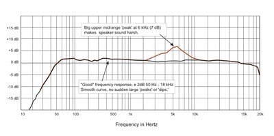

Now it’s time for another hard part: Frequency responses are almost always shown as a graph. This graph is known as the “Frequency Response Graph.” (Clever, no?) You have to know how to read a graph, no excuses. If you paid attention in Mr. Kelleher’s 6th grade class, great. If not, you’ll be sorry now.
Now look at figure 2. The black line is a speaker with excellent frequency response. The frequency response curve (so-called because a speaker’s frequency response curves, or drops off, in the low bass and high treble) is pretty flat (“flat” is good, because it means the device is accurate with very little up or down variation), with no serious peaks or dips. For speakers, ± 2 or 3 dB is considered very good. Electronic equipment (receivers, CD players, etc.) should be within ± .5 dB.
The red line in Figure 2 shows a speaker’s frequency response with a big 7 dB peak (so-called because the graph looks like a mountain’s peak) in the upper midrange around 6 kHz, which will make it sound harsh and irritating.

Figure 2—Speaker frequency response curves—Good and Peaked

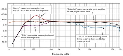

Figure 3 shows what speaker frequency response curves look like that correspond to various subjective descriptions.
Learn these terms and learn how they look as frequency response graphs, and you’ll be on your way to a meaningful understanding of loudspeaker sound.
Subjective descriptions vs FR
Figure 3—Subjective descriptions shown as frequency response curves

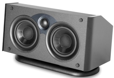

Center Channel Speakers
Center channel speakers are critically important in home theater systems because typically 50-75% of a movie’s sound track is handled by the center channel speaker.
To evaluate the center channel speaker, it’s best to listen two ways:
1. Play music through it and evaluate its sound like any other speaker, using same standards we outlined previously. Chances are, you’ll only have one speaker to use, so set the receiver to “mono” so the single center speaker receives all audio channels.
2. Use the center as the left or right speaker of a stereo pair, with one “main” speaker as the other speaker in the pair. Use the receiver’s balance control to go L to R to see how tonally similar they are. They will not be identical twins, but they should be at least close relatives. Then evaluate them as a stereo pair. Is the image stable? That will tell you if their radiation patterns are similar enough. Do they sound “right” as a pair? That will tell you if their tonal signatures are similar enough. A similar tonal signature is absolutely essential for the front stage image to be believable as sounds pan across the front three left/center/right (LCR) speakers.
