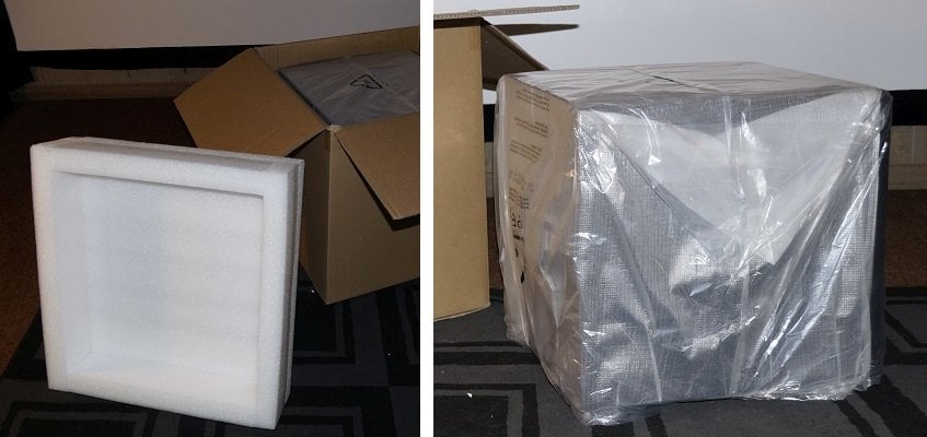

Unpacking and Setup Guide

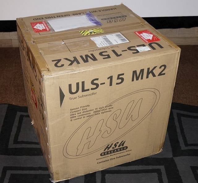

The ULS-15 mk2 showed up in a large box proudly sporting the Hsu logo. The external packaging is serious, with both packing tape and heavy-duty staples holding the box shut. There is certainly no danger of the subwoofer falling out, as I had to use pliers to pull out the staples in order to open the box.
Inside the box, removing a light foam cover reveals an inner box and some heavy cardboard corner protection pieces. Inside the inner box we see a large heavy-duty foam top and bottom piece neatly sandwiching the subwoofer. The subwoofer itself is wrapped in an internal layer of a soft foam-ish plastic cover and an external layer of a heavier plastic covering, presumably to protect it from liquids and moisture. The packaging overall consists of double-boxing, double foam insert shock-absorbtion, both tape and staple sealing, and double-bagging. This is the best packaging I can recall seen on a subwoofer. I guess Hsu really hates dealing with shipping damage claims.
The included Owner’s Guide is well done if not exhaustive. It has a lengthy trouble-shooting section and contains lots of tips and advice about optimizing subwoofer performance as well as basic instructions for subwoofer novices. It is also available on the ULS-15 mk2 website product page as PDF file. One thing that might be easy to miss for those who are unpacking the ULS-15 mk2 is the Hsu demo disc that is shipped in the packing list envelope. This CD contains a handful of tracks of classical music that makes for excellent demo material, and also a number of different subwoofer test tones. The demo disc is a nice touch, and the first track, the Saint-Saëns Organ Symphony excerpt which contains a powerful 16 Hz fundamental from a pipe organ, is a real corker for subwoofers.

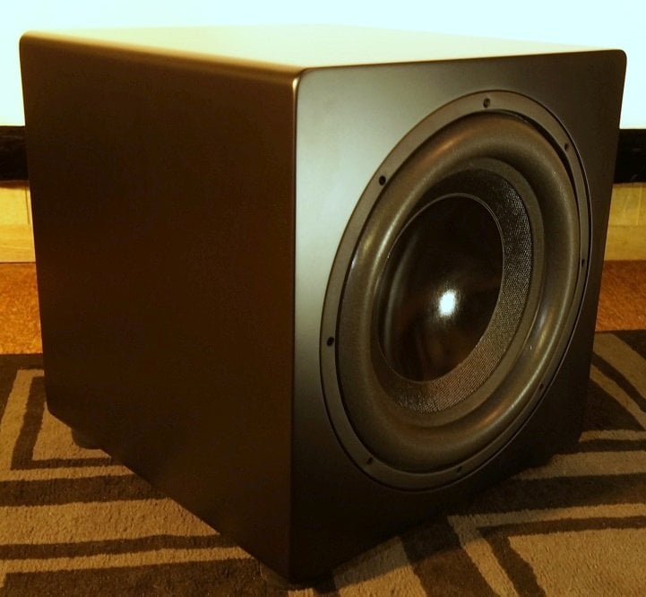

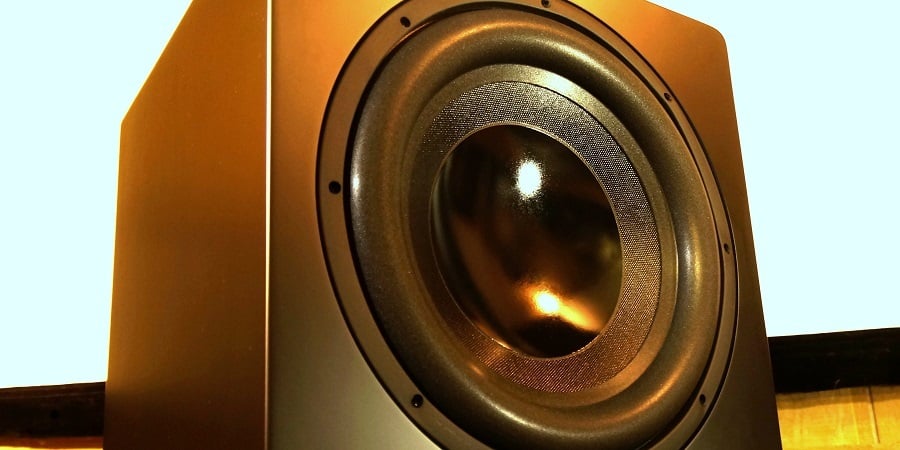

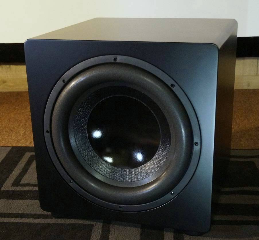

Appearance

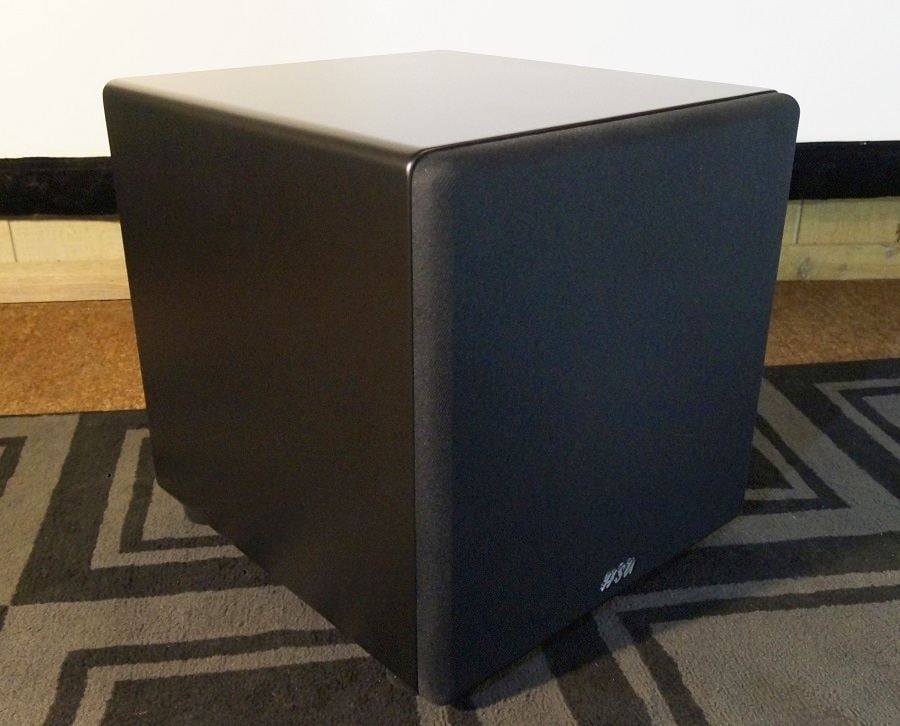

The ULS-15 mk2 does not look dramatically different from the
original ULS-15, which sported a
conventional and tasteful appearance. The mk2 cabinet is the same, and the only
obvious visual difference is the cone. With grille on, they look identical,
except for markings on the plate amplifier. The ULS-15 mk2 comes in satin black
finish and also a real rosewood veneer for an additional $150. The satin black
of this review unit is a very smooth black that is not polished-level shiny but
certainly not a matte-black light sink either. It reflects light but in a
diffuse manner. The cabinet itself is essentially an 18” cube with rounded
longitudinal edges; this symmetry lend it a stylish simplicity that would make
for a great fit in modern decor, but its conservative demeanor lets it blend in
with more traditional interiors, especially in the Rosewood veneer. For those
who want minimalism, the grille makes the ULS-15 mk2 look nearly featureless.
However I prefer it with the exposed cone; the glossy woofer center and beefy
surround make the mk2 look poised to do some serious rocking.

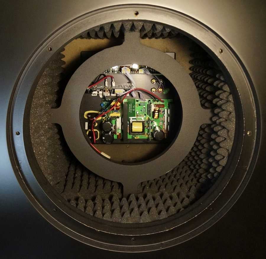

Design Overview
The 18” cube
cabinet is constructed with 3/4” MDF side-walls and a 1.5” front baffle. A
¾” window brace helps support the driver while reinforcing the side-walls at
the center length of the cabinet. The sidewalls are neatly lined with egg-crate
type foam for stuffing, which is a departure from the mk1 which used
fiberglass wall insulation for stuffing. The foam stuffing looks like it would
work well, while staying well out of the way of the driver and amplifier. The
feet are sturdy rubber rings that do well to protect the cabinet when setting
it down, although they make it awkward to move the sub by sliding. These
feet look like they would make use of a subwoofer isolation pad a moot point,
much like SVS’s SoundPath Isolation feet. Altogether the ULS-15 mk2 sports a
simple and sensible enclosure for a sealed subwoofer of this size. A higher-end
and more expensive subwoofer might sport more bracing and thicker walls, but
that would only add weight and expense for negligible returns. The ULS-15 mk2
cabinet construction is orderly and very pragmatic.

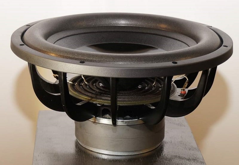

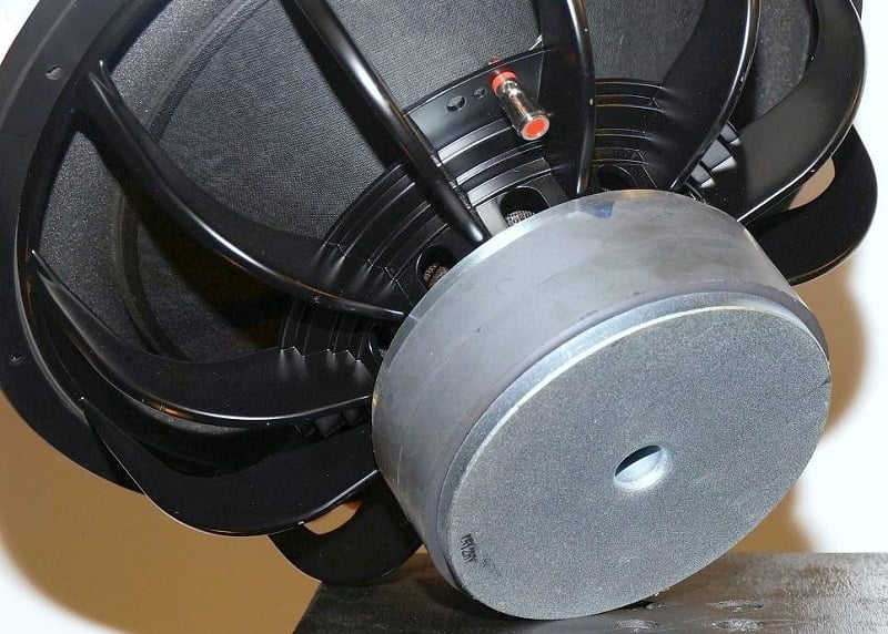

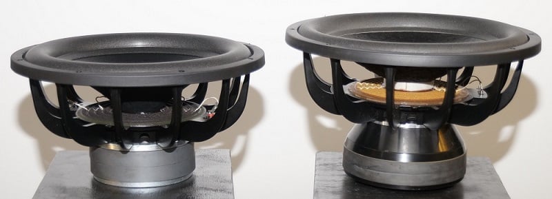

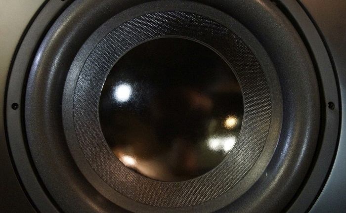

The biggest point of departure of the mk2 from the original
ULS-15 is the driver. The first ULS-15
used an underhung XBL^2 motor. A design goal of the XBL^2 design was greater
linear excursion due to a more uniform magnetic field for the voice coil to travel
in (for those who want to get into the details of the XBL^2 technology, here is a good starting point). Indeed, the
‘ULS’ stands for Ultra Linear Sealed, denoting the extraordinarily long linear
stroke delivered by the XBL^2 design. Another characteristic of the XBL^2
design is a wider-band driver than conventional topologies, since not as much
voice coil mass is needed, thereby greatly reducing induction. However, a
disadvantage of the XBL^2 design was a hefty penalty in sensitivity. Hsu
dispensed with the XBL^2 design in favor of a more traditional overhung design in
the mk2. While the XBL^2 design was an interesting approach in the mk1 driver,
the mk2 driver is no slouch. A stack of two hefty 1” x 6.75” magnets comprise
the bulk of the motor. The pole piece is
undercut for a better magnetic field symmetry, and multiple shorting rings
reduce induction effects which reduces even-order distortion. The mk2 uses a
12 spoke aluminum basket and a Butyl foam surround holds a
fiberglass-impregnated cone in place.

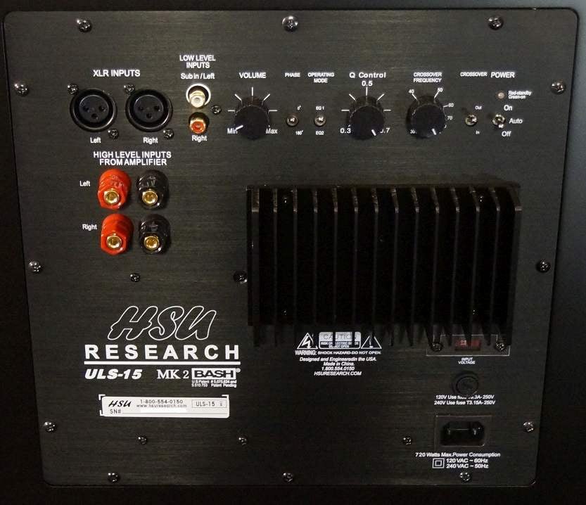

The amplifier is a 600-watt continuous BASH amplifier. BASH
amplifiers have been around for a while and combine the efficiency of Class D
amps with the fidelity of class AB amplifiers (although that is somewhat of an
over-simplification). The ULS-15 mk2 amplifier has a host of noteworthy
features. Balanced XLR inputs make it a good choice for higher-end and
pro-audio setups. Speaker-level inputs make it a good choice for setups with no
line-level outputs such as older receivers and integrated amplifiers. An
operating mode switch can set the frequency response flat down to 20 Hz in the ‘EQ1’ mode or a
more typical roll-off to sealed subwoofers with a shallow slope starting at 50
hz in ‘EQ2’ mode. A ‘Q control’ knob changes the slope of the response; lower Q
settings will make for a steeper rolloff and mid bass will be accentuated more.
There are also the more traditional features on the amplifier such as a 0°-180°
phase switch and a 30 Hz to 90 Hz variable low-pass filter. One nice touch is
the 120V~60Hz/240V~50Hz voltage selector which makes for easy use in electrical
standards around the world.

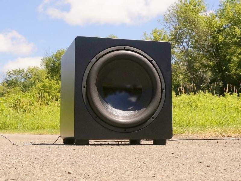

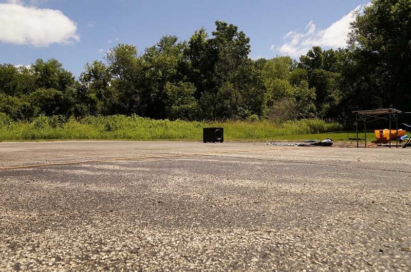

Outdoor ground plane testing of the Hsu ULS-15 mk2
The Hsu ULS-15 mk2 was tested using ground plane measurements with microphone at a 2 meter distance in an open setting with well over 100 feet from the nearest large structure. The sub was tested with woofer facing the mic. The subwoofer’s volume knob was set to maximum, mode was set to EQ2, Q control was set to 0.7, and the low-pass filter was switched off. Weather for testing was recorded at 74° F with humidity at 50%.

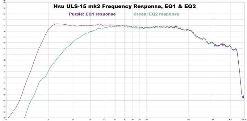

Looking at the frequency response, we can see that the ULS-15 mk2 has an extraordinarily flat response. The website product page for the mk2 states a 20-200 Hz, +/- 1dB, and this is essentially correct, at least for the EQ1 mode; this is an especially remarkable response for the fact that it accomplished with an analog amplifier. The EQ1 response uses a significant boost in deep frequencies to achieve such an impeccable response, and we can see a 12 dB lift centered at 23 Hz over the EQ2 response. It then falls off at a very steep rate, presumably to protect the driver from over-excursion. The EQ1 curve mimics that of a ported subwoofer, and, while this can be advantageous in some situations, it can present some problems in other situations. The subwoofer can only sustain that response as long as it has enough linear throw, and, as you turn up the volume, it can run out of excursion very quickly in deep frequencies, so this EQ1 curve is only useful up to a certain point. After that point, the driver is pushed past its linear excursion, and heavy distortion starts to set in, so the EQ1 mode is not where you want the subwoofer set if you intend to listen to content with deep bass at loud levels.
The EQ2 response more closely resembles that of a traditional sealed subwoofer and is also quite flat, achieving a +/- 1 dB window from 40 Hz to 200 Hz. I would recommend this mode for small rooms since room gain will naturally shore up the deep frequency response. I also recommend this mode for those occasions when the sub will be played loud with deep frequencies present in the material, since the driver is more restricted in deep bass, which will allow for more headroom. The response of either mode stretches up to nearly 200 Hz, allowing for a high crossover point if desired. This can be handy for those who want more dynamic range than can be had from their main speakers in mid and upper bass frequencies above the conventional 80 Hz crossover point, although it is recommended to have multiple subwoofers to do this in order to avoid localization of the subwoofer. Personally, I thought the system sounded much fuller with the use of a 100 Hz crossover, since the ULS-15 mk2 is so much more potent in that area than my tower speakers. Very few speakers, even large towers, will have mid bass dynamics of the ULS-15 mk2.

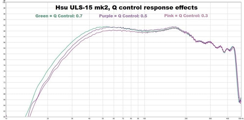

Hsu ULS-15 mk2 Q Control Effect on Frequency Response
The measured effect of the Q control is not dramatic but it does change the response. By de-emphasizing deep frequencies, bass can be made to sound tighter, since deep bass isn’t as readily perceived as higher frequencies. The Q control may also be helpful in adjusting the amount of room gain to desired levels.

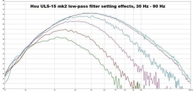

Hsu ULS-15 mk2 Internal crossover response effects
The internal crossover is based on a simple Linkwitz-Riley filter and uses a 24 dB/octave slope. Internal crossovers in subwoofers still have their place in systems without bass management, such as systems using integrated amps, or simple computer audio systems that use the computer as the pre-amp for active speakers. Since the crossover in the ULS-15 mk2 seems to affect the gain, level matching will have to be done after the internal crossover is set. Note the ULS-15 mk2 does lose its ruler-flat response with the crossover engaged in EQ2 mode.

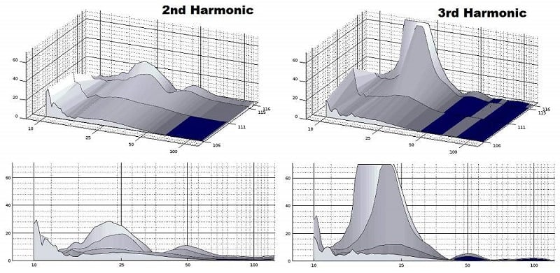

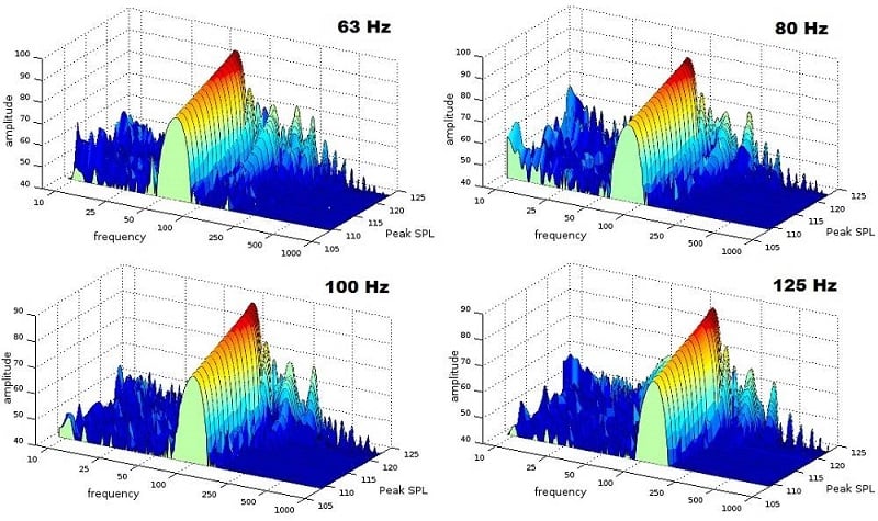

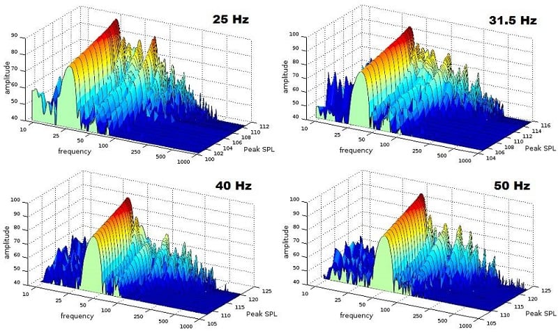

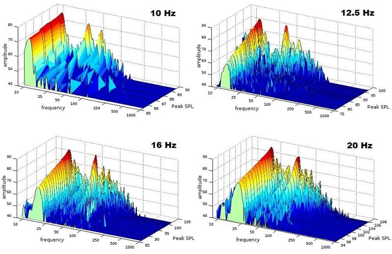

Frequency Breakdown of CEA-2010 Burst Measurements for the ULS-15 mk
The above graphs show the frequency spectrum of the increasing CEA-2010 bursts as reproduced by the ULS-15 mk2. Essentially, it depicts the behavior of the subwoofer reproducing short burst tones at successively louder levels, with each test tone raised by boosting the input gain by 1 dB until either no more output was to be had from the subwoofer or the subwoofer started making too many mechanical stress noises for the tests to be safely continued. The frequency marked above the graphs note the fundamental tone being tested, and this can also usually (but not always) be discerned in the graphs by the horizontal axis frequency point of the “main ridge,” the highest levels on the vertical axis. The noise below the fundamental (that random spikiness to the left of the main ridge) should be ignored. What should be looked at are the smaller ridges to the right of the fundamental. These are the distortion products of the fundamental, and it is here where we see how cleanly the subwoofer handles a given output level. These are mostly harmonics: whole number multiples of the fundamental.
Some noteworthy features emerge from these graphs. We can see that there are levels of 10 Hz output that are not completely swamped by harmonic distortion, so the ULS-15 mk2 does permit some relatively clean 10 Hz output, to a point. This is even more true of 12.5 Hz, where there is relatively clean output until just past 90 dB, where the third harmonic rapidly increases. When pushed to large excursions, the driver ends up producing a lot of third order harmonic distortion. Since higher frequencies don’t need as much throw, we see much less distortion at nominal levels as the test frequency rises. One characteristic that can be seen are the different ways 2nd and 3rd harmonics rise. 2nd order harmonics maintain a more consistent increase that almost correlates with the increase in gain in the fundamental. The 3rd harmonic tends to erupt after a point, and this would be an indicator that the driver is reaching the end of its linear excursion.
It should be said here that anyone looking at all of these ridges of distortion and drawing the conclusion that this is somehow a highly-distorted sound or poor performance showing would be wrong. For the vast majority of the dynamic range of the ULS-15 mk2, distortion is inaudible. Until the loudest levels, there is a very large power delta between the fundamental and distortion products. Just because distortion products can be seen in these graphs does not mean it can be heard. Most of this distortion will be totally masked by the fundamental; for those readers who want to know more about the audibility of distortion at bass frequencies, we point you to this Audioholics article.

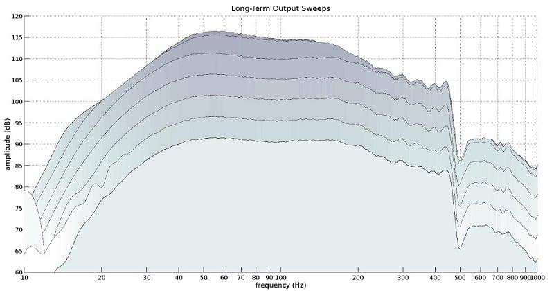

Hsu ULS-15 mk2 Long-Term Output Compression
Testing for long-term output compression was done by first conducting a sweep tone where 50 Hz hit 90 dB, and then we conduct further sweeps by raising the gain by 5 dB until no more output could be rung out of the subwoofer. As with the CEA-2010 measurements, the long-term measurements show the ULS-15 mk2 is a force to be reckoned with, roughly averaging 115 dB from 40 Hz to 150 Hz. We do see the natural response compress a bit at the highest two sweeps around 20 to 30 Hz and also from 200 to 400 Hz. The slope of the band of compression would seem to suggest that pushing the gain even more would have resulted in more output at lower frequencies but not anywhere else, and this is also hinted by the 12.5 Hz CEA-2010 burst measurement, where the angle of that compressed slope would have intersected 12 Hz at around 90 dB which correlates with the 90.7 dB CEA-2010 measurement at 12.5 Hz.

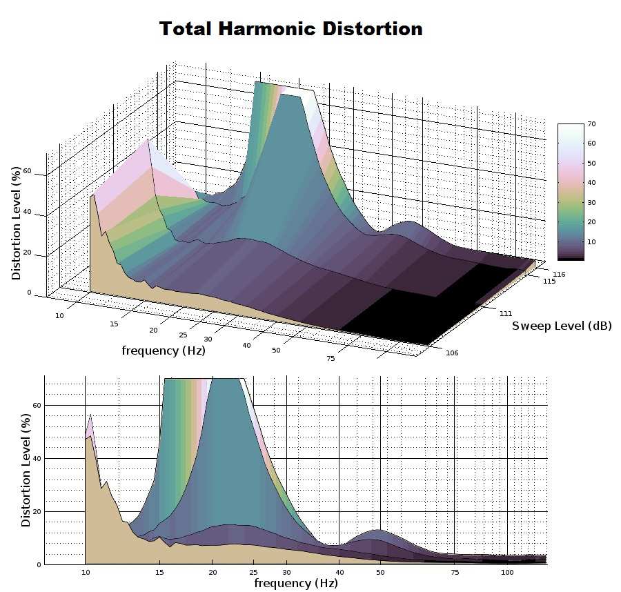

Total Harmonic Distortion of the ULS-15 mk2 as a percentage
The total harmonic distortion measurements in the above graphs correspond to the long-term compression sweeps; they are the harmonic distortion measured during those sweeps. The distortion is presented here as a percentage of the fundamental, or how much of the sound produced by the subwoofer is distortion versus intended test tone reproduction. The graphs show the ULS-15 mk2 to be a very clean subwoofer until pushed to the very edge of its performance envelope, where a spike of distortion erupts from 15 Hz to 25 Hz. Distortion subsides below 15 Hz due to a filter that gives the low end a parabolic slope. The 15-25 Hz spike of distortion is the woofer over-driving the filter, and this can also be seen in the long-term compression sweeps, where the shape of the response changes from curved to flat in that frequency band at that output level. The distortion crest in the deepest frequencies in the lower power 106 dB and 111 dB sweeps is partly caused a lower signal-to-noise ratio at those frequencies and output levels; in more ideal testing conditions it would be lower like the same frequency range in the 115 dB and 116 dB sweeps. Overall a picture emerges of a highly linear subwoofer, especially ideal for music since it can pound out an average of 115 dB output levels from 40 Hz to 150 Hz with less than 10% THD. If you like your bass clean and loud, the ULS-15 mk2 is a solid choice.

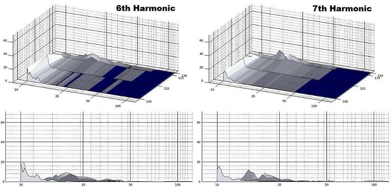

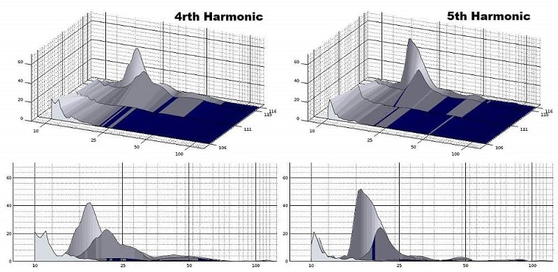

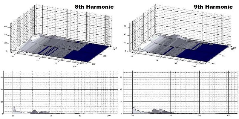

Hsu ULS-15 mk2 Harmonic Distortion Components as Percentage
The above graphs break down the composition of the harmonic distortion into individual harmonics. The most notable feature that can be seen is that the dominant distortion is the 3rd harmonic. Odd-order harmonics such as the third, fifth, and so on are typically the result of a symmetric non-linearity that affects both directions of a driver’s throw, so it stands to reason that the heavy spike in third-order distortion is due to the driver running past linear excursion. The shape of the low-end filter prevented the driver from over-extending below 15 Hz in our testing, so the spike of distortion ended there, but if we had pushed it even harder at low frequencies, we could probably have induced more distortion below that point.

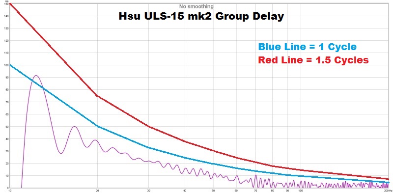

Hsu ULS-15 mk2 Group Delay
Group delay is the measurement of how much time it takes for individual frequency bands of an input signal to be produced by the speaker. It can indicate that some frequency components are developing slower than others or are taking longer to decay. It is generally thought that 1.5 sound cycles are needed for group delay to be audible at bass frequencies, although there is an argument that group delay should remain under 20 ms to be completely unnoticeable, but that is likely meant for mid and upper bass frequencies. Either way, the ULS-15 mk2 presents nothing to worry about. Group delay stays under 20 ms down to around 30 hz, a frequency low enough that it is certain that group delay would not be discernable at or below it. The rise in group delay as frequencies descend hints at the subsonic filter guarding the low end of the response, but there is nothing measured here that would come close to being audible. Altogether, this is a good showing.

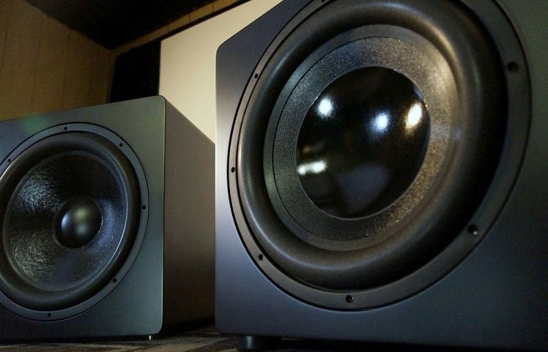

How much of an upgrade is the ULS-15 mk2 over the ULS-15 mk1?
ULS-15 mk1 (left), ULS-15 mk2 (right)

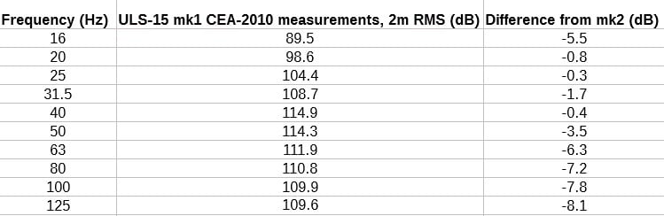

Since I happened to have a ULS-15 mk1 on hand, I decided to hold a mini-shootout between the mk1 and mk2 to see how much of an improvement, if any, was to be had. On the base specifications, I would not have predicted much of an improvement. The mk1 was a much more expensive subwoofer at $1099 and weighed a good deal more. Most of the weight difference occurred in the driver, where one would expect the additional weight to add up to a performance advantage; the mk1 driver weighs 41 lbs and the mk2 driver weighs 22 lbs. The extra weight of the mk1 seems to come from the massive top plate which is needed for strength and long stroke of the XBL^2 design.
ULS-15 mk2 driver (left), ULS-15 mk1 driver (right)
So how does the mk2 fare against the mk1?
Hsu ULS-15 mk1 CEA-2010 measurements and difference between the mk2’s measurements
From 20 Hz to 40 Hz we see the two models are very close to each other in performance, but at 50 Hz and above the mk2 pulls away, as the mk1’s output begins to drop as it enters mid bass frequencies. At 63 Hz and above, the mk2 is more than fully doubling the mk1’s output. This is perhaps due to the split gap in the top plate that is characteristic of the mk1’s XBL^2 design which may lessen sensitivity around the rest position of the voice coil. This would reduce output as the frequencies increase, since less stroke is needed as frequency increases, so the voice coil isn’t moving out as far from its rest position. However, this does not explain the difference at 16 Hz. Furthermore, what isn’t shown is the difference at 10 Hz and 12.5 Hz, where the mk1 was not able to post a passing measurement. In fact, at these deep frequencies, the mk1 produced substantially more distortion than the mk2 for the same output level. This ran contrary to my expectation that the mk1 XBL^2 design would exhibit less distortion than the overhung mk2 at very high excursions.
Overall, the ULS-15 mk2 is a major improvement over the mk1, despite costing much less. It has much more composure at very deep frequencies and far more headroom at higher frequencies. This isn’t to say the original ULS-15 was a bad sub- far from it. Its 20 Hz to 50 Hz performance still rivals and exceeds more expensive sealed subwoofers. The mk2 slightly improved on all of its strengths and massively improved on its weaknesses.

as well; this is a sub that does not take two people to move around. One person
of average build can carry the 65 lbs ULS-15 mk2 around without too much of a
strain. Since the enclosure is just an 18” cube, it does not eat up a lot of
room. Some people might not consider that a small sub, but for the firepower it
packs, it is remarkably small. Another point for the ULS-15 mk2 is that its
amplifier has a lot of flexibility for different setups, so this is a subwoofer
that can be integrated into a variety of systems, and with its adjustable
response, its sound can be tailored to suit a variety of tastes.
