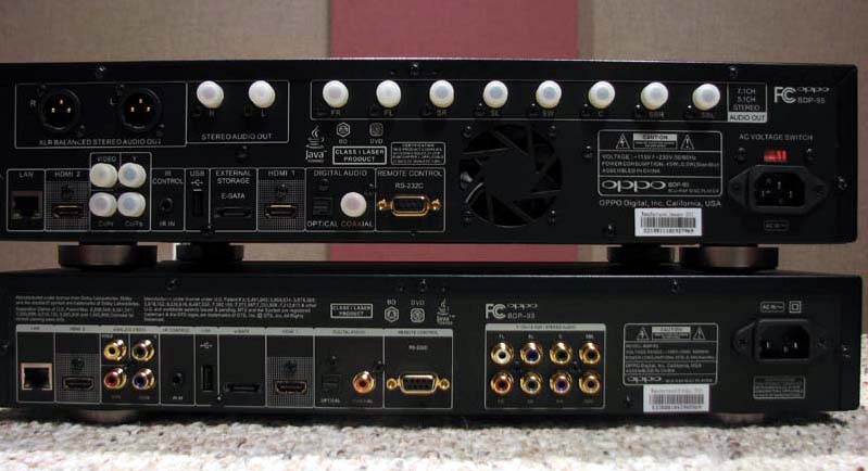

Both players have the same complement of I/O's (two HDMI, one component, composite, toslink, coax, Ethernet, etc) though the BDP-95 adds dedicated unbalanced and balanced stereo analog outputs.  The Oppo BDP-93 does NOT have dedicated stereo analog outputs.  Users wanting to run analog stereo to a second zone from the Oppo can do so only if they are not already utilizing the dedicated multi channel outputs.
The 8 channel preouts of the BDP-95 are also spaced further apart and horizontally arranged into one long row instead of two rows like the BDP-93.  Both players analogue outputs are color coded to better mark corresponding channels.  Both players also sport detachable power cords, though the BDP-95 is of three-prong type while the BDP-93 is two-pronged.  The BDP-95 grounding scheme requires a 3 prong power receptacle for its balanced analog outputs to maintain a truly differential signal path from input to output and thus improving Common Mode Rejection and further reducing the noise floor.
As you can see in the above photo, the BDP-95 is slightly taller than the BDP-93.  Both players measure 16-7/8" wide by 12-1/4" deep while the BDP-93 is 3-1/8" high and the BDP-95 is 4" high.  The BDP-93 also weighs in at 10.8lbs while the BDP-95 weighs an impressive 16lbs.

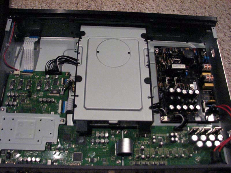

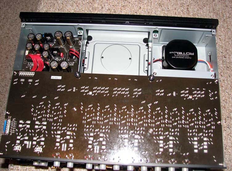

We honestly weren't expecting such differences in build quality between the two players.  Once we popped their hoods, the BDP-93 seemed hollow in comparison.  It was almost as if they were two completely different players.   Both players utilize identical video circuitry while the BDP-95 gets a significant audio upgrade by implementing premium ES9018 Sabre32 DAC's and a dedicated analog power supply with a Rotel built toroidal power transformer.  Both players share the exact same transport which was kind of a bummer to us.  We would have liked to see a slightly beefed up disc drawer for the BDP-95 if for no other reason than high end appeal.
We asked Oppo to provide us a complete list of differences between both players which is tabulated below.
BDP-95 BDP-93
ESS Sabre32 Reference DAC for the 7.1ch analog output Cirrus CS4382A DAC for the 7.1ch analog output
A second ESS Sabre32 Reference DAC for the stereo analog output No dedicated stereo output (The 7.1ch output can be set to stereo mode)
Fully balanced XLR output for stereo No XLR balanced output
Linear power supply with Rotel-made toroidal transformer for the audio section Switching power supply
Higher grade op-amps and passive electronic components Regular audio grade op-amps and passive electronic components
Bigger and heavier chassis
A lot more engineering hours put into the design

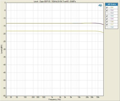

 With all speakers set to "large" we used a 0dBFS Dolby TrueHD 96kHz/ 24 bit 8 channel test signal to measure frequency response which was ruler flat from 20Hz all the way to the Nyquist frequency (1/2 sampling rate 44kHz).

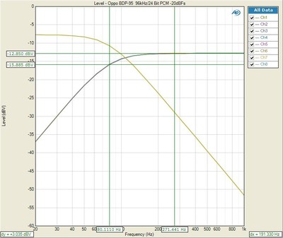

Setting all speakers to "small" and selecting 80Hz as our choice crossover point, we measured the analogue bass management capabilities of both players.  Unlike the Oppo BDP-83 model with a fixed 80Hz crossover point, the newer BDP-93/95 models offer variable crossover settings from 40-250Hz (20Hz increments from 40Hz to 80Hz, 10Hz increments from 80Hz to 120Hz, 50Hz increments from 150Hz to 250Hz).
BMGMT Xover  BGMT SPK
Oppo BDP-93 & BPD-95 Analog Bass Management System
BDP95 Bass MGMT
Oppo BDP-93 & BPD-95 Analog Bass Management Measurements
We measured the filter slopes using a -20dBFS 96kHz / 24 bit PCM test signal.  Setting the crossover to 80Hz, we in fact measured an 80Hz -3dB point for the HPF and LPF with a 12dB/octave slope.  We personally prefer to see a 24dB/octave slope for the LPF like THX recommends, but Oppo said their goal was to meet the minimum Dolby requirement of at least a 1st order filter (6dB/octave) for the HPF and at least a 2nd order filter (12dB/octave) for the LPF.  Considering THX informed us they don't even test the analogue outputs of Blu-ray players, we are just picking nits here.
