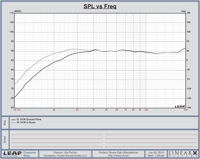

The first thing that caught our eye with Power Sound Audio was not the size, shape, or performance of their subs. It was that they test their subs using the CEA2010 (2 meter ground plane) standard. Most subwoofer manufacturers are happy to give you a frequency response specification with no indication of how they arrived at it (there are times we think they just sit in a room and say, "Yeah, that probably goes down to 20Hz"). Not so with Power Sound Audio. They not only use rigorous testing but also publish the results. Take a look at this graph from their largest sub, the XV30:
XV30_room_gain
This is a 1/6th octave smoothed ground plane measurement paired with a simulated in-room response. We didn't have to pin down the manufacturer to find this out - they state it directly on the product page. Not only that, but they have Frequency Response and Long Term Output Compression graphs. As you can see in the above graph, in the ground plane measurement, the XV rolls off softly starting at 30Hz but doesn't really reach its -3dB point until around 21Hz. This is an excellent response and leads to a simulated in-room response of 16-18Hz -3dB. If that doesn't have the bass-heads in the crowd salivating, this will: the MSRP is $1249.
