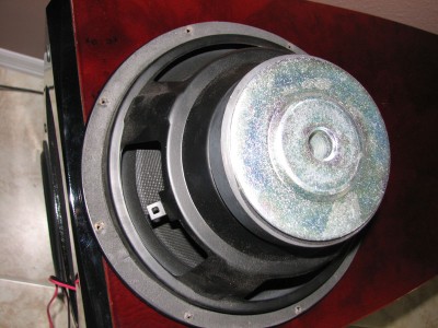

The ES1010i employs two 10” poly matrix cone (fancy term for a type of plastic construction) drivers each with a 1” wide butyl rubber surround, a stamped frame with a fairly hefty motor structure (40 oz) and vented pole piece, and a 2” voice coil. This driver is similar to the one found on their ES10i subwoofer but is 8-ohms instead of 4-ohms and has a slightly higher complaint spider to the lower resonance frequency allowing the sub to play down lower thus increasing its extension. While this driver is rather generic in construction, strength in numbers helps by placing two of them into the enclosure to increase output while also lowering distortion.

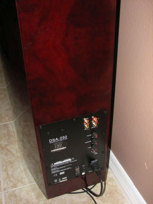

The ES1010i plate amp model # DSA-250 is a 250 watt linear Class D amplifier with continuous variable phase and crossover control (surprising at this price point). The subwoofer crossover is adjustable from 50Hz to 150Hz but can also be defeated by utilizing the LFE input of the sub. The ES1010i also has stereo L/R inputs and outputs. The sub has auto-on capability and a detachable power cord. It also features an analog limiter to ensure that, no matter how hard you drive it, you cannot cause it to misbehave or destroy itself.
