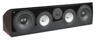

E56Ci
  • Dual 6-1/2" Polypropylene Woofers
  • Dual 5-1/4" Aluminized Poly-matrix Woofers
  • 1" (25mm) Fabric Dome Tweeter
  • Recommended Power: 50-175 Watts
  • Impedance: 6 Ohms
  • Frequency Response: 40Hz-20kHz ±3dB
  • Crossover Frequency: 600 Hz, 3,000 Hz
  • Sensitivity: 87dB (2.83V@1m)
  • Dimensions: 31" W x 8½" H x 10½" D  (787mm W x 216mm H x 267mm D)
  • Weight: 28 lbs. (12.70 kg.)
  • Available in High-gloss Red Burl or High-gloss Black Ash

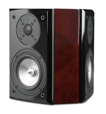

E55Wi Surround
  • Dual 1" (25mm) Fabric Dome Tweeter
  • Recommended Power: 50-130 Watts
  • Impedance: 6 Ohms
  • Frequency Response: 65Hz-20kHz ±3dB
  • Crossover Frequency: 3,000 Hz
  • Dimensions: 11-1/2" W x 12" H x 6" D  (299mm W x 301m H x 152mm D)
  • Weight: 12 lbs. (5.44 kg.)

E56Ci

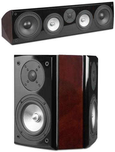

This is now a problem of the past. The EMPtek has released the new E56Ci Large Center Channel. Where the E5Ci had two 5.25" aluminized poly-matrix coned midranges and a 1" fabric dome tweeter, the E56Ci adds two additional 6.5" polypropylene cone woofers. This takes the low end of the frequency response from the E5Ci’s specification of 60Hz down to the E56Ci’s specification of 40Hz! That's a huge improvement and will allow a much lower crossover point if needed and a lot more output (which is especially needed in larger rooms.) The placement of the tweeter should reduce off axis lobing errors as well. Of course, the extra drivers required a modified enclosure. Where the E5Ti was 21-3/4" W x 7-1/4" H x 7-3/4" D, the new E56Ti is 31" W x 8-1/2" H x 10-1/2" D. That's nearly 10" in width alone! The weight has also more than doubled, from 11.5 pounds to 28 pounds.
E55Wi
The second thing we had put on our EMPtek wishlist was a dedicated surround speaker. Sure, you can use a bookshelf as a surround, but we much prefer a dedicated on-wall surround. The new E55Wi is a much-needed addition to the EMPtek line. These on-wall speaker measures 11-1/2" W x 12" H x 6" D and weigh in at 12 pounds. While it doesn't have a di-pole option, it is pre-wired for bi-pole performance. The speaker wall-mounts through included keyhole brackets and is rated down to 65Hz. While we would have preferred a switch for di-pole performance and a dedicated mounting solution rather than simple keyhole brackets, the $500 price point per pair sort of negates our complaints. Each speaker is trapezoidal in shape with a tweeter and a 5.25" midrange on each angled face.
