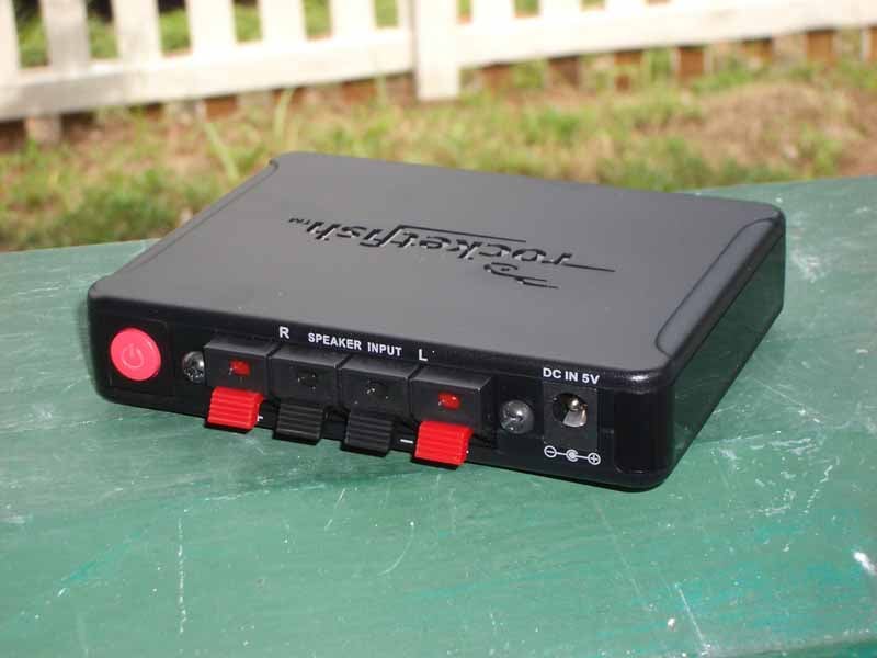

rocketfish-rear.jpgBuild quality is always important to me. It's a real quick way to assess the quality of a product and determine how it might perform once everything is properly connected and configured. In this case my first impression was that Rocketfish cut some corners – but they also dropped the cost of entry so low I found it hard to complain. OK, for $99 it's almost impossible to complain. The transmitter unit is about the size of a couple deck of cards laid side-by-side. It's powered by a 5VDC adapter (included) and weights almost nothing. You feed the speaker-level inputs to the plastic spring clips of this unit via the included pair of 24-inch ~20-gauge speaker cables. The box feels cheap, but so do most wireless systems we've seen. I have yet to experience one targeted towards the serious home theater consumer – in a sense it's an oxymoron. If you were serious, I suppose you'd find a way to run the wires (or pay someone else to do it).

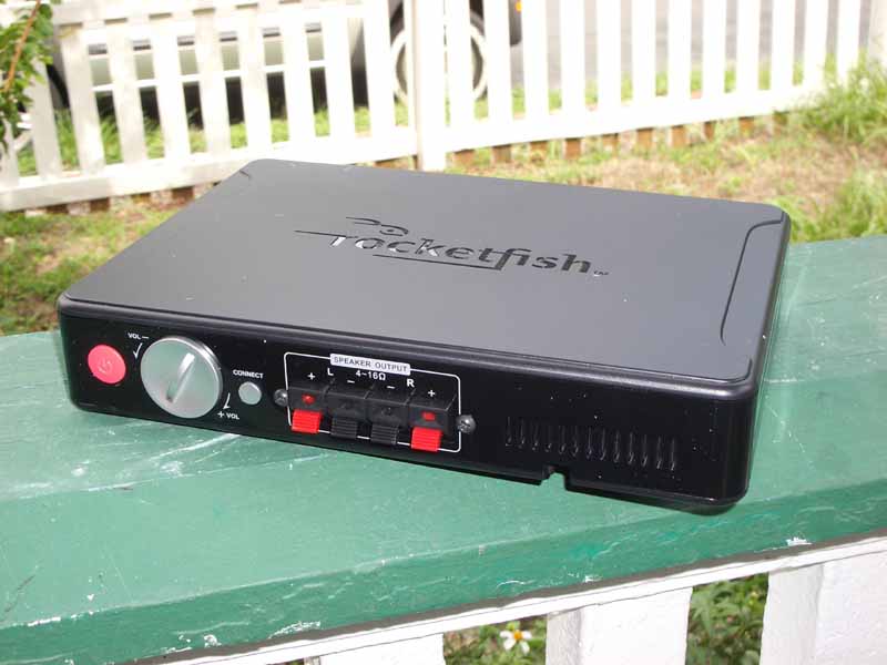

The receiver unit is where the “magic” happens. This box is larger, about the size of medium-sized hardback book and features the same spring clips (this time for speaker-level outputs) along with a volume dial and integrated power cord. Both units have red power buttons and the receiver has a large LED on the front that shows when it is powered on. While the transmitter is meant to be set on top of a table or your AV gear, the receiver can be oriented horizontally, vertically (using an included stand) or even wall mounted.

rocketfish-transmitter1.jpgSetup is simple, but there were a few catches. The transmitter goes with your main equipment. The output for your surround speakers (taken from your receiver/amplifier) feeds the transmitter. This is a speaker level signal, so you won't use or require any preamp outputs. This is a good thing and opens up this product to even the most entry-level AV surround receivers in the marketplace. If you have a $199 AV receiver, you can use this system. After connecting the transmitter I plugged it in and made sure it was receiving its 5VDC power from the wall. I used the included cables because, well, they were included. I also quickly realized that no terminated speaker cables were going to stay in the cheesy plastic spring clips for long. Bare wire is your best bet. As long as you match your right and left you should be fine during this step.

For the wireless receiver you'll also want to use bare wire – or if your speakers come hard-wired you can use those cables. If you have Bose or some other brand that terminates into a funky connector you'll either need an adapter or a simple pair of wire cutters/strippers. Bottom line is that the positive and negative connections are easily identified on the wireless receiver and you can always use a AA battery to test your speakers to make sure they are firing in phase (the positive pushes the cones out.) Now realize that there is only one wireless receiver. This is a design flaw in my opinion, though I realize the costs would be higher otherwise. Since you have two surround speakers, it makes more sense to me that there should be two discrete amplifiers and receivers. There are a number of issues associated with this and I'm certain someone over at Rocketfish made an executive decision to keep the street price under $100. What this means to the consumer is that you'll be running your surround speaker wires from a unified centrally-located source. It's still not as bad as running them from the front of the room, but it could be better.

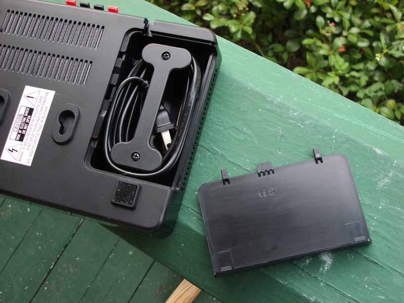

rocketfish-cord.jpgOnce the speakers are connected, plug the unit into the wall (the cable is cleverly storable within the unit itself and you don't have to remove all of it if you're only going a short distance), power it up and prepare to send it signal. I always recommend starting with test tones. It will tell you if everything is functioning correctly and it allows you to set up your levels to make sure that the surround field is properly balanced. You'll want to almost max out the amplifier in the Rocketfish system so that you are using most of the amplification power allocated. At that point you can use the level setup system in your AV receiver to configure the proper levels from the front of the room. A RadioShack meter or similar will help you do this more accurately – especially if you aren't using the same speakers all the way around the room. One thing I found, by using an audio test disc, is that there is indeed a 15-20ms delay caused by transmission from the sender to the receiver. That's the rough equivalent of moving your speakers 15-20 feet away from you. With this in mind, note three things:
