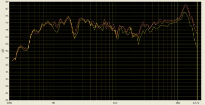

For laboratory measurements I used the Sencore SP395A FFT Audio Analyzer and a Sherbourn 2/75B amp, I measured the A6-6T6's in room on and off-axis frequency response with 1/12th octave resolution. Like most speaker manufacturers, eD lists the frequency response of their speakers on their site. Also like most speaker manufacturers, their graph resembles mine in a "had the same father but different moms" sort of way.
A6-6T6 1 watt/1 Meter Frequency Response (1/12th Octave) On Axis
The 15kHz peak we see in the frequency response is caused in part by the diaphragm ringing.  This is an issue with the geometry of the tweeter.  It can likely be mitigated or eliminated by choosing a different diagraph radius and/or material.  The manufacturer would be wiser to select a smaller dome tweeter of proper design as its more challenging to make larger dome tweeters retain linearity to the frequency extremes of human hearing.
A6-6T6 1/2 Meter Frequency Response (1/12th Octave)
Pink - On axis, Orange - 15 degrees off axis, Yellow - 30 degrees off axis
A6-6T6 Impedance
The Sencore consistently measures impedance one ohm low. From a close examination of the above impedance magnitude, it is clear the A6-6T6 low passes the woofer at 2000hz, while the tweeter is crossover over considerably higher, closer to 6000 Hz. This may be for a number of reasons, but the resultant frequency response both on and off axis clearly shows a significant droop in the overall output between 1000 and 4000 Hz. The problem with errors in this part of the frequency range is that human hearing is particularly acute in this region, and not terribly forgiving of mistakes.
The octaves on either side of 2000hz result in the greatest contribution to intelligibility more than any other two octaves in the audible range. As Paul Klipsch was known to say, “We live in the midrange”. A better crossover design would likely have minimized if not eliminated this problem entirely.
