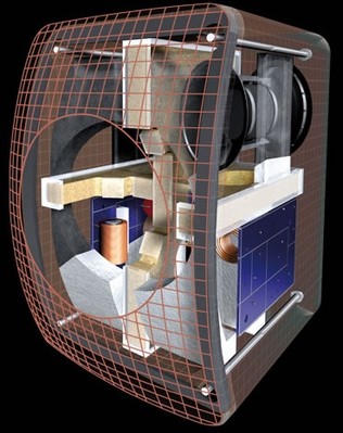

KEF-ls50-exploded
As is clearly visible from the exploded view provided by KEF, the LS50s are, in fact, well braced. A vertical and horizontal brace keeps the cabinet inert with the crossover placed on the two side walls. KEF used computational fluid dynamics to model and design the rear port allowing for greater airflow with less turbulence (reducing port noise/chuffing). The rounded front baffle is designed to smooth on- and off-axis dispersion. The back of the speaker has a pair of five-way binding posts and the entire speaker is wrapped in the ever-popular gloss black veneer.
