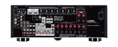

rx-a830_back
Glancing at the back, we find nine pairs of speaker terminals. The seven internal amps can power a 7.2 system or 5.2 system with the last two amps powering presence speakers or Zone 2. They can also be used to bi-amp the front speakers. There are two component video inputs, five composite video (one on the front) inputs, and one output for each. The RX-A830 can upcovert and scale all video to HDMI to 4K resolution.
