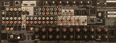

back Presence channels in your home theater. Check out how they laid out the 11
pairs of speaker binding posts:
You can hit up the system to drive 7 to 11 channels in one room, or automatically wire it up to switch to 5.1 and power a second or even third Zone with the push of a button. But wait until we get to the menu system and you see all of the configuration options Yamaha has in store.

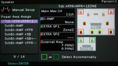

Speaker Set-Up![menu-speaker-size.jpg](menuspeakersize.jpg/image_mini)

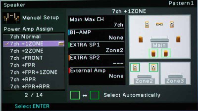

This is where you engage the Auto setup using the included multi-point microphone, and also where you configure the speakers with the manual setup function. We have beat YPAO to death in the past, so we're not going to waste valuable real estate rehashing that system here. What we are going to talk about is the new design of the manual Speaker Setup menu, which operates under a new "Select Your Speaker Configuration" methodology. In the past, Yamaha had you select how the amplifiers were going to be used, and select the way the Surround Back and Presence channels were to be allocated, often without any provision for utilizing both a second or third Zone and the Presence Channels. In short, Yamaha was severely limited in the past. With the RX-A3000, the on-screen GUI interface literally shows you what your options are, and you can pick and choose how you want to run your speakers and how you are planning to amplify them in the various situations. The amplifier assignments are automatically selected when you scroll through the configuration options - and you have only to observe the notation and graphical representation to understand what is possible. In this way, the complexity of selecting amplifier routing is removed and all possible permutations are granted simultaneously. This is the first time we've seen this in an AV receiver.

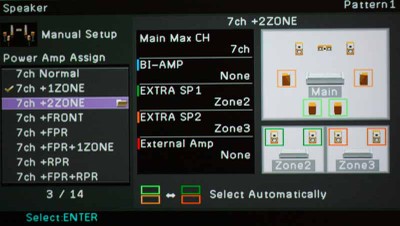

Take this scenario, for example, which is my favorite: I am operating a 7.1 system + a second Zone. In this configuration I am not bi-amping the mains, but I am using an external 2-channel amplifier to power my Zone 2 speakers. This is designated as EXTRA SP1: Zone 2. It also gives me the flexibility to select how I am using my last 2 channels of amplification - as Surround Back speakers, or in Zone 2. The beauty is, with 11 pars of binding posts, I don't have to do any fancy rewiring; everything is all set. Here is how it looks:
Now, suppose I wanted, instead to opt for pulling both the Surround as well as the Surround Back amplifiers in order to power two additional zones? No problem, Yamaha's RX-A3000 can allocate amplifiers as needed to do that as well. Here's how that particular configuration looks:
But I want to use my Presence channel speakers, you say. You know what, that's a great idea. Yamaha allows you to configure those for use with an external amplifier (they have dedicated preamp outputs) and now you can opt to allocate the internal amplifier between Surround Back channels and the optional Zone 2 you configured. This is how that scenario would look on the setup menu:
We complained (OK, whined) about that for years, and finally Yamaha seems to have taken the hint and allocated enough processing power and preamp outputs to handle even the most difficult configurations. It seems that if you can add external amplifiers, you can truly harness the power of this 11.2-channel receiver. Not since their flagship RX-Z11 selling for more than 2 ½ the price, was this possible.
OK, so that's just the speaker allocation and power amp assignments. You still have the ability to configure the speaker levels (0.5dB steps), distances (0.2 ft/.05m increments), and Extra Bass (where the receiver can send fullrange information to the front speakers and bass from the front speakers to the subwoofer). You can also, and this is a BIG deal for a receiver at this price point, connect two subwoofers with independent level and trim control and set the subwoofers for either mono, stereo (left + right), or front/rear. We typically recommend Mono, but some audiophiles may want to experiment with the stereo setting. We don’t recommend the front/back setting since it only sends LFE info to the rear sub.

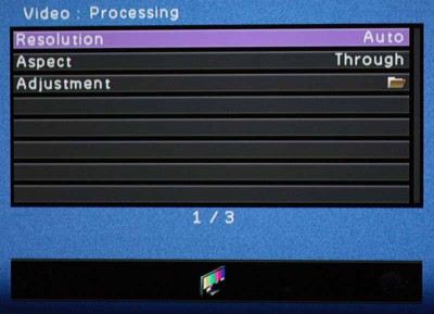

The Video setup menu has some very unique and helpful settings. In particular, we felt it was wise of Yamaha to allow users to disable analogue-to-analogue conversion. In that way you can force your expensive display to do the work and maintain the purity of your video signal (it's also an excellent way to troubleshoot analogue video compatibility problems). You can also disable the video processing features for the HDMI video - also helping you to determine exactly who is doing the video processing: the receiver, the player, or your display. If you enable it, you can set the output resolution to 480p, 720p, 1080i, 1080p or Through (same resolution as what is being input).
Please read: Video Processing in Blu-ray Players, Receivers and Displays
Aside from processing and conversion, this menu provides for scaling options of converted video, and picture controls such as Contrast, Brightness, and Resolution Enhancement. Unless you have a deficient source component, we recommend largely leaving these options alone with one exception. We found that the various Noise Reduction circuits were handy in reducing mosquito noise and the analogue noise found on older program material. In either case, it's a truly advanced feature with six configurable Presets which allow adjustment over:

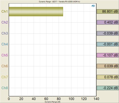

Yamaha RX-A3000 Preamplifier Measurements
I did some quick spot-checking on the RX-A3000 pre-amplifier gain structure to ensure it could be properly drive a wide assortment of power amplifier. My personal criteria for amplifier gain structure is that it should be able to hit full power when driven with 2Vrms. The RX-A3000 was able to deliver 3.3Vrms unclipped out of the analog multi channel outputs. Once I exceeded this output level, the auto protection circuits shut the receiver down. This is more than enough clean output voltage to drive any audio amplifier to clipping.

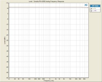

Yamaha RX-A3000 Analog Frequency Response
Frequency Response was ruler flat from 10Hz to 80kHz (the limit of the APx585 test equipment) with +-.025dB variation. The preamp gain (Av) = 13.6dB similar to what I measured on the RX-Z7.

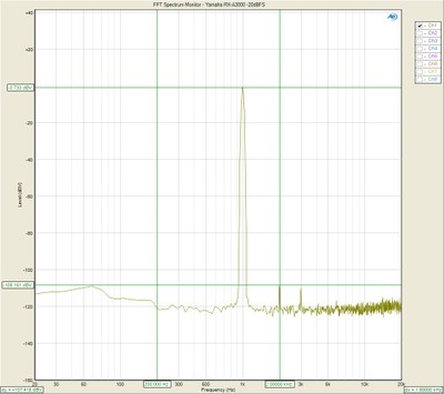

Yamaha RX-A3000 FFT Distortion (HDMI In, -20dBFS, 1Vrms out)
Driving the RX-A3000’s HDMI input with a -20dBFS signal, I adjusted the
volume control until I measured 1Vrms via the preamp outputs., The RX-A3000
displayed an excellently clean FFT distortion profile with the magnitude of the
2nd harmonic of (-.733 +108.15)dBv = 107.4dBv or
100*alog^-1(-107.4/20) = .0004% THD + N.
As you can see in the output, residual noise products are virtually
nonexistent.
Yamaha RX-A3000 SNR (pre-amp driven via HDMI)
Using the HDMI input driven at -20dBFS with 1Vrms out of the preamp analog outputs, I measured 86dB (unweighted). This is a pretty clean measurement. I repeated this test via the analog inputs and noticed an elevated result likely due to clock noise or just digital artifacts well above the audio band corrupting the measurement. Engaging “Pure Direct” made about a 3dB improvement to this measurement coming close to the SNR performance I measured when driving the RX-A3000 via an HDMI input source.

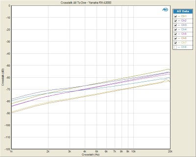

Yamaha RX-A3000 All-to-One Crosstalk (HDMI
In, Preamp Out 1Vrms)
The RX-A3000 exhibited commendable channel to channel crosstalk performance. With all channels acting as the noise source or disturber driven via the HDMI input, I measured each idle channel one at a time to determine the worst case channel to channel crosstalk. At 1kHz the RX-A3000 yielded -70dB @ 1kHz dropping lower with frequency (odd but true) and still maintaining -70dB at 20kHz for its noisiest channel. I consider anything less than -40dB @ 10kHz acceptable so the RX-A3000 met that minimum requirement with 30dB to spare! With only one channel driven at a time, channel to channel crosstalk performance was about 10dB better across the board putting it on par with what I measured on the RX-Z7 two-channel crosstalk tests.

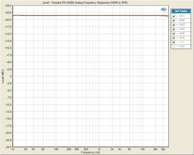

Yamaha RX-A3000 Frequency Response (HDMI In, Speaker Level Outputs)
With the RX-A3000 driven by a -20dBFS input signal via HDMI, I measured all channels driven at 8 ohms via the speaker outputs at 10 watts power level. Frequency response was again ruler flat from 20H to 80Khz (the bandwidth limit of my AP test gear) +-0.04dB variance which was incredibly linear.

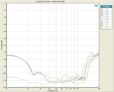

RX-A3000 All-to-One Crosstalk (HDMI In, Speaker Level Outputs 20watts)
I measured all-to-one crosstalk from the preamp input of the RX-A3000 all the way to the speaker outputs with each channel driven at 20 watts (except the channel under test). Channel to channel crosstalk was excellent (80dB @ 1kHz, 55dB @10kHz). Again this is a worst case crosstalk measurement. Simply measuring channel to channel crosstalk with only one channel acting as a disturber at a time would produce numbers 10dB or lower across the board. This is how most publications measure crosstalk but we tend to be harder on the products and test them in the worst case scenarios like these.

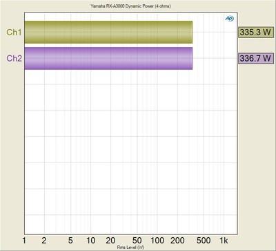

Yamaha RX-A3000 Dynamic Power Test (1kHz) 2CH Driven, 4 ohms

1 | Dynamic PWR | 217wpc | 8-ohms | 1% |
1 | Dynamic PWR | 386wpc | 4-ohms | 1% |
2 | Dynamic PWR | 205wpc | 8-ohms | 1% |
2 | Dynamic PWR | 330wpc | 4-ohms | 1% |
7 | Dynamic PWR | 153 wpc | 8-ohms | 1% |

program material will never trip this limiter circuitry. Thus we conducted dynamic burst power
measurements simulating real world program content. Interestingly enough the RX-A3000 delivered
similar dynamic power output ACD into 8 ohm loads and slightly more power two

# of CH | Test Type | Power | Load | THD + N |
2 | CFP-BW | 140 watts | 8-ohms | 0.1% |
2 | CFP-BW | 238 watts | 4-ohms | 0.1% |
7 | 1kHz Psweep | 108 watts | 8-ohms | 0.1% |
7 | 1kHz Psweep | 117 watts | 8-ohms | 1% |
2 | 1kHz Psweep | 240 watts | 4-ohms | 0.1% |
2 | 1kHz Psweep | 252 watts | 4-ohms | 1% |
7 | Dynamic PWR | 156 watts | 8-ohms | 1% |
2 | Dynamic PWR | 320 watts | 4-ohms | 1% |
Emotiva UPA-7 Power Measurement Table
It's clear that the
Yamaha RX-A3000 delivers more than rated power with up to two channels driven
and tons of dynamic headroom (1.9dB for 8 ohms based on their 140wpc power
rating). Let no skeptic tell you
otherwise, the RX-A3000 has a darn respectable amplifier section not only for a
receiver but for a modestly priced seven channel power amplifier.
