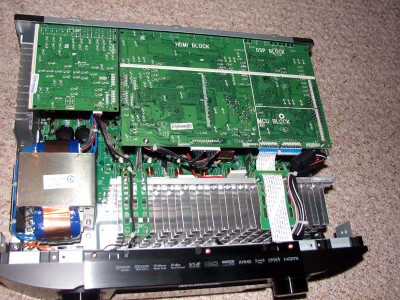

SR6004-no-cover
Marantz SR6004 No Cover
Marantz engineering also informed me that all of their SR series receivers (including the SR6004) were designed to maintain 70% (77wpc) power output under a 5 channel load and 50% (55wpc) power output under 7 channels driven against its two-channel driven spec.  Of course I planned on validating this claim which you will see in the measurements portion of this review.

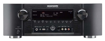

Marantz-frontcover
Marantz SR6004 Front panel View
The SR6004 doesn't have the typical boxy feel you get with most receivers.  Instead it sports some sexy curves given it the feeling of a high end gear not dissimilar to their beautifully crafted two-channel reference gear.  The front panel has an array of buttons and inputs.  Oddly, there is an S-video connection which in my opinion would have been better to be an HDMI connector instead.  The front panel also includes a phono input, USB connector for use with flash drives, or music streaming devices such as an iPod, analog audio and composite video and Toslink for digital music sources.

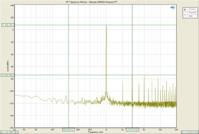

SR6004-FFT-preamp
Marantz SR6004 Preamp FFT Distortion Analysis
With 0dBFS in, the SR6004 was able to output a whopping 7Vpp unclipped (<.1%THD +N) or 2.49Vrms.  The 3rd order harmonic component was over 80dBv below the fundamental which was very good.  Adjacent channel to channel crosstalk produced 81dB @ 1kHz, 65dB @ 10kHz which again is excellent.

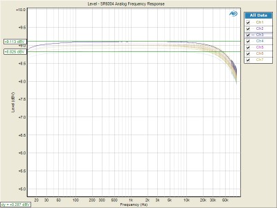

SR6004-Freq-analog
Marantz SR6004 Frequency Response
Using the HDMI input, measured frequency response was within +/- 0.25dB from 20Hz to 20kHz with -3dB of 43kHz (limit of Nyquist, 1/2 sampling rate of 96kHz).  Channel to channel variation was within .5dB within the entire audio bandwidth.
Using the analog inputs produced a ruler flat frequency response beyond the bandwidth of my Audio Analyzer (80kHz).  With plenty of clean output drive and excellent distortion and crosstalk figures, the Marantz SR6004 is more than capable of serving as a dedicated A/V processor in the event you wish to bypass its amplifiers for more powerful external amplification.

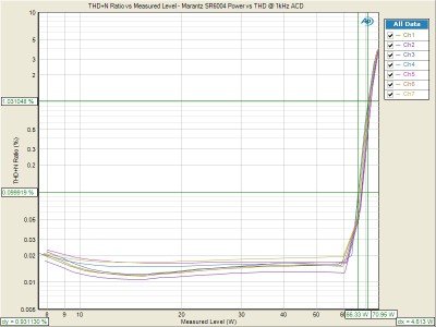

SR6004-PWR-7CH1kHz
Marantz SR6004 Power vs Distortion

The Marantz SR6004 power reserves were quite impressive for a receiver of its price and size.  Not only did they exceed their 110wpc rating for up to two channels driven but they also exceeded their engineering spec of 50% power under 7 channels driven by outputting 66wpc at 0.1% THD +N and 71wpc at 1% THD +N.

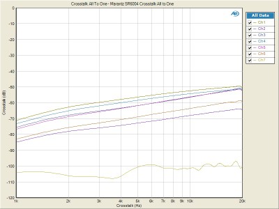

Crosstalk
SR6004-Xtalk
Marantz SR6004 Crosstalk Measurement at Full Rated Power vs Frequency
 Running a full range frequency sweep from the preamp all the way through the power amp at full rated power (110wpc @ 8 ohms), I measured all-to-one crosstalk where all but the channel under test acted as the noise source or disturbers.  This is the worst possible crosstalk test scenario. The other was the DUT. The Audio Precision plotted crosstalk for each channel under these circumstances and showed that the worst channel exhibited around 61dB at 20hz, 70dB at 1kHz with a gradual increase with frequency (50dB @ 20kHz) due to capacitive coupling.  These were good measurements.

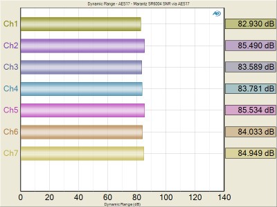

Signal to Noise Ratio (SNR)
SR6004_SNR-1wattAES17
Marantz SR6004 SNR per AES17
We measured the SNR at 1 watt power using no weighting for the worst possible measurement.  It's important to know how quite a product is at low power levels to ensure the noise floor of the product isn't masking sonic detail.  A number greater than 60dB at 1 watt is acceptable while a measured response above 80dB is considered excellent or very quiet.  The SR6004 yielded 82.9dB for the worst channel which is an excellent measurement.  It's no wonder why the SR6004 sounds so clean and detailed at low power levels.
