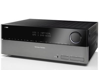

harman kardon HK 3490 Introduction
3490-front.jpgThere comes a time in everyone's lives where one needs to reboot and get back to the basics.  We see this all the time in the movie industry with successful remakes such as Batman Begins, as well as the car industry by revitalizing the classic spirit of models that seemed to lose their way over the new generation of successors (ie. Mustang, Camaro).  Getting back to the basics is usually a good thing and something I often yearn for in the overly complex home theater world laced in HDMI mishaps, and MP3 compression.  Harman/kardon understands this well as their products have traditionally been more audiophile focused than many of their competitors.  Enter the HK 3490 Stereo A/V Receiver.  On paper, the HK 3490 seems to have great performance and features that would please the audiophile and techno-geek alike.  With a nice meaty amplifier section rated at 120 watts per channel and 4 ohm rated to 150 wpc, we are talking some serious speaker drive capability.
When one of my close friends was looking for a two-channel receiver for his bedroom system, I selfishly suggested this model simply because I wanted the chance to test it first hand.  Little did I know, the HK 3490 would dazzle me with a performance and feature set not found on any of its peers.

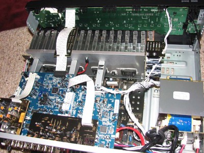

harman/kardon HK 3490 Top View
The HK 3490 power supply is sized like a typical mid to high priced 7.1 receiver yet it's only sporting two channels of amplification!  I couldn't read the ratings of the power supply capacitors but they were quite thick and hefty.  The power transistors were not the typical run of the mill ones found on most A/V receivers.  These babies had some real size to them reminding me of how high end two-channel receivers used to be made when companies cared more about audio quality over cutting corners for profit margins.  What was surprising to find in this two-channel receiver was a pair of AKM PCM DAC's.  That's right, the HK 3490 has digital inputs and internal D/A converters on-board, a critically useful feature I've not been able to find on any other two-channel receivers.

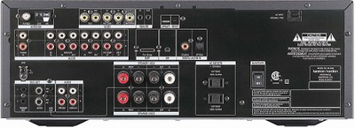

harman/kardon HK 3490 Back View
The HK 3490 back panel is cleanly laid out.  There are two pairs of speaker outputs utilizing 5-way binding post connections.  They are wired in parallel so no sound degradation will result by running two-pairs of speakers simultaneously.  We do however caution users to stick with 8-ohm speakers if running two sets simultaneously.  Otherwise, feel safe running a pair of 4-ohm speakers for stereo.  As you will see in my measurements, the amp section of the HK 3490 is very stable at 4-ohms.   The HK 3490 provides composite video switching, analog RCA audio connections and two digital inputs (1 coax, 1 toslink).  It also provisions for dual subwoofer output connections but with no bass management provisions, which is typical of two-channel receivers.  There is a Bridge II connector for iPod users and a master on/off power switch on the back, two switched outlets, and a non-detachable power cord

You can tell at first glance of the HK 3490 front panel, that this product means business. The chassis has a solid feel and heft to it and the layout of the front panel is quite elegant and simple.   I have only a few cosmetic gripes which include the flimsy O-ring volume control, lack of backlighting on the input buttons and the tiny pop out balance and tone controls underneath the removable front panel flaps.  I found it quite difficult to adjust the bass/treble controls but they luckily had a center click detent to make it easier to set to the zero or neutral position.  Honestly if you've got really linear speakers and high quality amplification, you should have very little need to use tone controls which typically only color the sound and make it less accurate.

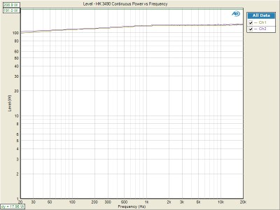

Using our Audio Precision APx585 8-channel HDMI analyzer, we conducted a full barrage of multi-channel amplifier tests on the harman/kardon HK 3490. We tested power using three methods all of which were taken at < 0.1% THD + N:
  • Continuous Full Power Bandwidth (CFP-BW) from 20Hz to 20Khz into 8 and 4-ohm loads (up to two-channels)

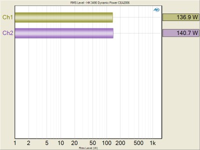

  • Dynamic PWR - 1kHz CEA-2006 Burst Method testing. This is a dynamic power measurement adopted from the car industry similar to IHF method only a bit more difficult for an amplifier and more representative of real musical content.

harman/kardon HK 3490 Continuous Power vs Frequency ( 2CH driven, 8-ohms)

harman/kardon HK 3490 Dynamic Power (1kHz, 8-ohms, 2CH driven)

2 Dynamic PWR 140 watts 8-ohms 1%
2 Dynamic PWR 227 watts 4-ohms 1%
Tabulated Power Test results for the HK 3490 Receiver
The harman/kardon HK 3490 power reserves were quite impressive for a receiver of its price and size.  It came very close to running both channels at continuous full rated power (120watts) and held up well for the 1kHz 8-ohm and 4-ohm power vs. distortion tests.  In fact, the amp section in this receiver was so stable that I ran all of the power tests with both channels driven and the HK 3490 never complained or broke a sweat during my torture tests.  Into 4-ohm loads, the HK 3490 exceeded its 150wpc power rating by putting out 167wpc x 2 @ 0.1% THD + N and a whopping 227wpc of dynamic power with both channels driven.

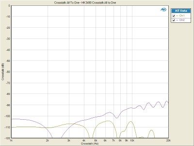

 Crosstalk
harman/kardon HK 3490 Crosstalk Measurement at Full Rated Power vs. Frequency
Running a full range frequency sweep from the preamp all the way through the power amp at full rated power (120wpc @ 8-ohms), I measured channel to channel crosstalk where the channel under test was at idle while the adjacent channel was running and vice versa.  The Audio Precision plotted crosstalk for each channel under these circumstances and showed that the worst channel exhibited around 90dB at 20 kHz which is a phenomenal result.  Anything greater than 60dB at 20kHz is considered inaudible by even the most critical ears.  There is no doubt that the stereo separation in this receiver is superb.

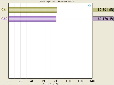

Signal to Noise Ratio (SNR)
harman/kardon HK 3490 SNR per AES17
 We measured the SNR at 1 watt power using no weighting for the worst possible measurement.  It's important to know how quite a product is at low power levels to ensure the noise floor of the product isn't masking sonic detail.  A number greater than 60dB at 1 watt is acceptable, while a measured response above 80dB is considered excellent or very quiet.  The HK 3490 yielded around 80dB which is an excellent measurement.  It's no wonder why the HK 3490 sounds so clean and detailed at low power levels.
