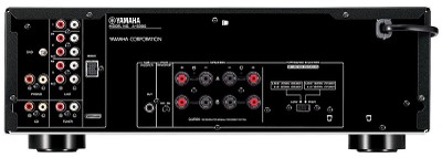

What really drew our eye to the S300 offerings was the A-S300 integrated amplifier. At 17-1/8” by 6” by 15-1/4” and nearly 20 pounds, this is no lightweight offering. Sporting six analogue (RCA style) inputs and two (rec) outputs, there are plenty of connections for you. There is a dedicated Dock connection for adding one of Yamaha's aftermarket iDevice docks, a subwoofer output, and two sets of speaker connections for each of the two channels (labeled A and B).
Yamaha_A-S300_back
At 60 watts per channel, the A-S300 has more than enough oomph for most applications. There is an impedance switch for 4 or 8 ohm speakers plus a Power Management switch for automatically powering down the system after a period of inactivity. Aside from input and volume controls, the A-S300 has variable Bass, Treble, Balance, and Loudness controls. The Pure Direct mode bypasses all of these controls for the cleanest possible sound.
