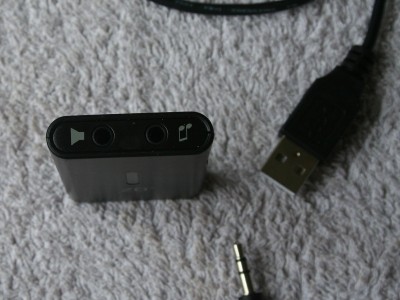

Personal Subwoofer is not what the ZO2 is. In reality, it is a tiny headphone amp with a built in bass-boost. According to the designer, the ZO2 is a "analog sound enhancement device that happens to have high power headphone drivers at its outputs." This means that everything is kept in the analogue domain negating need for ADCs and DACs within the device If that doesn't sound like something you might be interested in, I beg you to read on. This is the sort of product that I didn't think could even exist.
Measuring 2.75 by 1.5 by 0.38 inches, the ZO2 has a smaller surface area than a credit card and is just thick enough to mount a 3.5mm input and output. There is a front mounted light and a small button on the side. The button can be depressed or clicked (it doesn't make a noise but it isn't a scroll wheel) up or down. There is a side-mounted mini-USB port for charging with a very small red light on the side to let you know when it is charging (red light illuminated) and fully charged (red light off). The Li-Polymer battery has a recharge time of under an hour but will last for up to 17 hours of playback.
The top has a 3.5mm port for input and output. Inside is a Class-A headphone amplifier that uses an ultra-low noise pre-amp. The ZO2 has two settings - headphone out and line-out. The main difference is that the headphone out uses the volume control of your device. The Line-out (designed to be used when connected to a 3.5mm-to-dock connector cable or source without volume control) allows the ZO2 to control the volume. The ZO2 has a 32 step volume control.

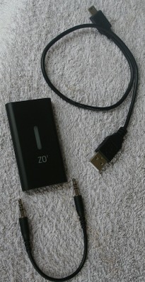

The ZO2 is tiny and light. It really doesn't feel like it should be capable if amplifying anything. At less than an ounce, the cable on your headphones probably weighs more. The case has a "soft-touch" coat on the plastic which feels, for lack of a better word, weird. Not bad, mind you. Even after weeks of testing, I occasionally find myself looking at it to see if there is any sort of velvet on the outside.
The digiZoid ZO2's front light is color coded. When you first turn it on, it will be in headphone mode. It's color-coded pink. Insert "why-the-heck-did-they-go-with-pink" joke here. In all honesty, once you select the mode, you never see the pink again so it isn't a big deal. Line out mode is color-coded purple though that color changes based on what volume you chose. After you set your volume, you go into bass-boost mode.
Integrating the ZO2 into your system is a snap. digiZoid includes a small 3.5mm jumper cable for your use. You plug the jumper into the headphone out on your phone/player and into the input (labeled with a musical note) on the ZO2. You then plug your headphone into the output on the ZO2 and you are good to go. digiZoid did well to flush-mount the 3.5mm jacks on the ZO2 so as to not impede use of headphones with larger connectors. Since they intend (based on their marketing material) the ZO2 to be used with high-end headphones, that was a smart design choice.

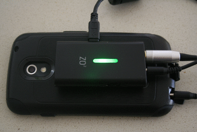

There are two ways to install the ZO2 Personal (not a) Subwoofer. You can use the 3.5mm jumper cable from your source to the ZO2 or you can use some sort of line out cable that terminates into a 3.5mm jack. In the latter case, you'll have to provide your own cable as digiZoid only provides the 3.5mm jumper. This seems reasonable considering the multitude of uses a consumer might have for the ZO2.
While the obvious use is between your headphones and your phone or portable music player, there are tons of other applications. If you connect your phone to your car stereo via a 3.5mm cable, you can easily integrate the ZO2. Between your computer and headphones or desktop speakers? No problem. With the size of the ZO2, the problem is not going to be portability (other than possibly losing the thing) as it goes everywhere. Plus, it is so light you can leave it dangling on the cable and not have to worry about any damage to your ports.

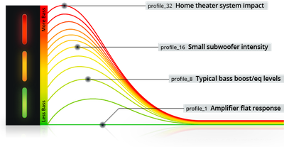

Once you've installed it, you need to press the button to turn it on. It will default the first time to the typical bass boost in headphone mode. This is signified with a yellow light on the front. Pressing the button again will sent it into mode select. As it defaults in Headphone mode, the front will glow pink. Press the button down (roll it toward the bottom of the ZO2) and you'll switch to a blue/purple color. This is Line mode where you have volume control. Up and down on the button will control your volume. To switch back into Headphone mode, hold the scroll button up for about 10 seconds until the light turns pink again.
When in mode select, a single button press will send you back to the bass boost selection mode. Here you have 32 degrees of bass boost from nothing (flat) which will show green to maximum bass boost which will glow red. The levels of bass boost vary and become less dramatic as you go up (meaning at first you get a big difference between the amount of boost with each level while at the top a level up represents much less boost). You can press the button for each level or hold it down to scroll through the levels faster. One long press turns the ZO2 off and a single press turns it back on. After you adjust the settings on the ZO2, it stores those settings.

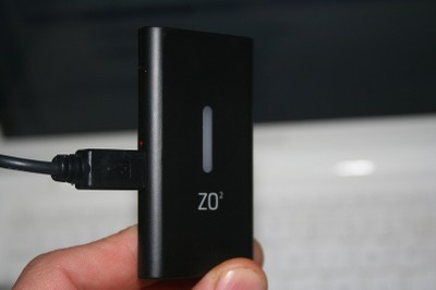

Charging the ZO2 took very little time and the run time is so long that I didn't think to charge the thing for days at a time. There is a secondary red light at the bottom of the light bar on the front that will blink when your battery gets low but that rarely happened to me even after days without a charge (and I was using the ZO2 nearly constantly). Charging the ZO2 while in use adds no audible noise to playback (unlike charging and using my phone at the same time) unless your source and the charging connection are the same (charging the ZO2 with the same computer that is providing the musical output).
While the ZO2 is very light and portable, I did wish there was some way of securing it to your phone. While it wasn't too much of a hassle to stick it in your pocket with your phone, I wanted a way to connect it to the back of my phone case. In what was probably a fit of madness, I attached a piece of Velcro to the back of my Samsung Galaxy Nexus Otterbox Commuter case and to the back of the ZO2. This created the perfect way to store the ZO2 when I was out and about and the ZO2 was thin enough that I could still stick the phone with the ZO2 attached in my back pocket. Since then, I've racked my brain for a solution that digiZoid could include with the ZO2 but I've come up empty. The Velcro works well but the connection is so strong that you have to be careful removing the ZO2 as you can feel the case flex if you put too much pressure on it.
