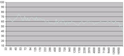

Real Time Analysis (RTA) from the Sencore SP295C Audio Analyzer ( updated 4/12/04 )
Figure 1. Quasi Nearfield (1 meter) 1/12 th Octave FFT Frequency Response
The overall frequency response of the VR-2 is uniformly flat and smooth with perhaps a slight emphasis in the highs. However, some of the bumps and dips in this response graph may be partially attributed to room acoustics especially since the room treatment is most effective in the mid bass to upper midrange area where the response is extremely smooth and flat, but de-emphasized slightly due to absorption.

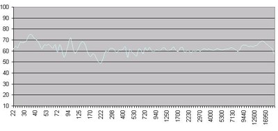

Figure 2. Quasi Nearfield (1 meter) 1/12 th Octave Low FFT Frequency Response
The VR-2's exhibited impressive bass response. However, since they seemed to be a bit energenic in the lower bass region (27Hz - 40Hz), I recommend placing them a few feet away from side and back walls to avoid excessive boundary gain. It appears the VR-2's had no problem reaching down to 25Hz and then some.
The VR-2's appeared to integrate well within our sound room with impressive low frequency bass response, smooth midrange and upper frequencies. I initially positioned the speakers with no toe-in (as in this measurement), thinking the slightly elevated high frequencies would best be minimized. However, it was apparent that they rolled off very smoothly off axis. If a little more energy at the high frequencies is desired, I recommend slight toe-in.
