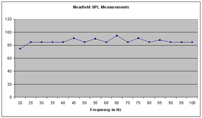

For theatrical soundtracks, the punch and dynamic power of the SPL-1200 will leave you feeling like you are part of the action. While lesser subwoofers struggle to reproduce true LFE content, the Velodyne's 10dB point was measured at 20.4 Hz using near-field microphone placement- impressive indeed for such a compact speaker.
