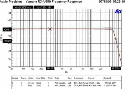

Power Bandwidth
Yamaha RX-V659 Frequency Response at 1 watt
The Yamaha RX-V659 possesses a wide bandwidth amplifier topology with a -3dB point in excess of 100kHz.
Yamaha RX-V659 Frequency Response at Full Power
At full continuous unclipped power (132wpc x 1; 8 ohms, 120wpc x 2; 8 ohms; full bandwidth with less than 0.1% THD+N), the RX-V659 still maintained excellent bandwidth linearity with a -3dB point of 65kHz despite we were driving the receiver way beyond its rated 100wpc power specification. Into 4 ohms, the RX-V659 was able to deliver continuous power levels at a whopping 200wpc x 1 and 170wpc x 2 with less than 0.1% THD + N. The amplifier section of this receiver is truly underrated. I never encountered a budget A/V surround receiver that could deliver this kind of power before. Truly amazing.

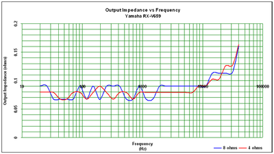

Amplifier Output Impedance & Damping Factor
The amplifier output impedance fell right within our desired 100 mohm or less mark for the entire audible bandwidth up to 10kHz with just a slight increase above at the upper 20kHz frequency range. This is the type of performance I like to see in an A/V receiver and not expected for a product of this price class.
Amplifier Damping Factor
The amplifier damping factor is about what I expected based on the measured output impedance. It is uniformly good across the entire audio frequency range and falls slightly under the 90 mark above 1kHz we like to see on uncompromising designs. All in all, this is quite an impressive result and rivals some of the earlier and more costly Yamaha receivers we have reviewed in the past while also exceeding our minimum 50 value we like to see in amplifiers for 8 ohm loads and even does so with 4 ohm loads as well. We've never seen such stellar results in a receiver of this price class.
