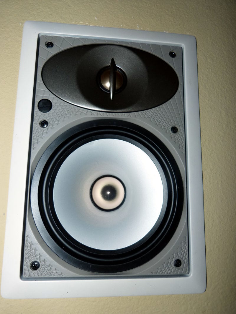

The Paradigm SA-25 is a two-way design with 1” gold anodized aluminum tweeter and 6.5” aluminum cone woofer with phase plug. The woofer features a heavy-duty 1.5” voice coil for increased power handling and the driver employs a cast basket with a large extruded heatsink to improve cooling. The woofer features a real phase plug which physically separates from the cone and instead is attached to the pole piece. This reduces the moving mass of the driver slightly, allowing it to extend its usable frequency response and also acts as a heat sink to cool the voice coil and increase power handling. It also slightly reduces on-axis beaming by dispersing the high frequencies the driver is producing. The 1” aluminum dome tweeter also has a heatsink to reduce thermal compression. The crossover is a 3rd-order electro-acoustical response with a 2kHz cutoff. It contains a mixture of air core inductors and mylar caps on the tweeter circuit along with a large heavy gauge iron choke on the woofer. The padding resistor on the tweeter is mounted on stand-offs to reduce heat buildup by increasing air circulation. Everything about this product demonstrates Paradigm going to the extreme to ensure high power handling and low compression. Even the front baffle is extremely rigid and constructed out of aluminum instead of plastic as found on lesser products. The SA-25 is rated for 8 ohms though my measurements reveal a different story. The frequency response is rated from 58Hz to 22kHz +- 2dB (notice the tight tolerance indicating again good parts quality). Sensitivity is rated at 88 dB at 2.83V/meter which is what I measured. The SA-25 is rated from 15-160 watts. Feed these babies quality amplification, they can take it!

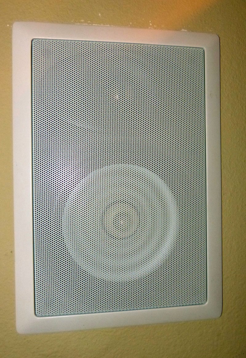

Once the speaker is secured to the wall, you can install the grille. Paradigm claims the scrim cloth behind the metal grille is acoustically transparent and intended to remain in place for customers wanting to conceal the drivers from view. In my experience these cloth coverings have acoustical losses. If you can’t shine a flashlight through it, how could you expect no loss of fidelity? I took off the cloth on the grille before installing as I didn’t want to hinder the performance of this fine speaker and defeat its very purpose. I wasn’t able to get one of the speakers completely flush mounted to my wall thanks to the shoddy drywall work of my home builder. So, I took a bead of caulk and ran it through the seam of the speaker for a better seal. Carefully inspect the speakers after installation to address any potential leakage paths.

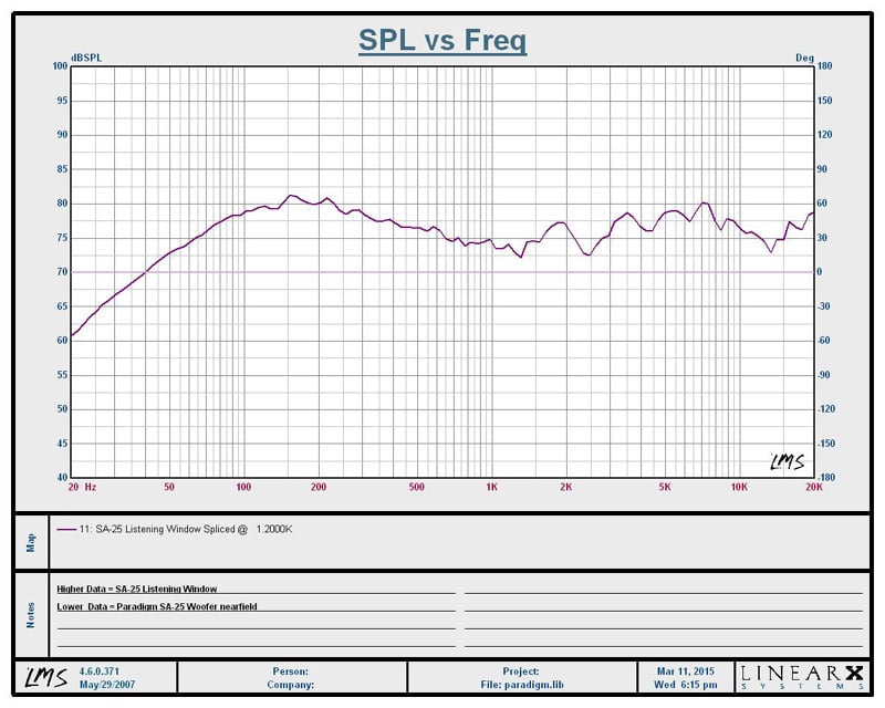

Paradigm SA-25 Listening Window Response – 1/2 meter in-room spliced @ 1kHz, no smoothing
I measured the Paradigm SA-25 speaker at 1/2 meter in-room installed in my wall on-axis, +-30 deg off-axis horizontal and +- 15 deg vertical off-axis to derive the listening window response. There was a pronounced dip in the 500Hz to 1kHz region when I measured on-axis but it was likely a result of the speaker being in close proximity to my large Armoire as it didn’t show up in a nearfield measurement of the woofer. Thus I spliced my listening window response with a nearfield measurement of the woofer below 1kHz to yield the result you see in the graph above.
The SA-25’s measured as expected, very linearly. While my listening tests revealed the SA-25’s appeared to have the tweeter level set a bit hot, I didn’t see this in my measured results.

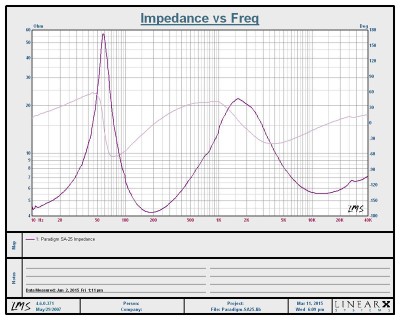

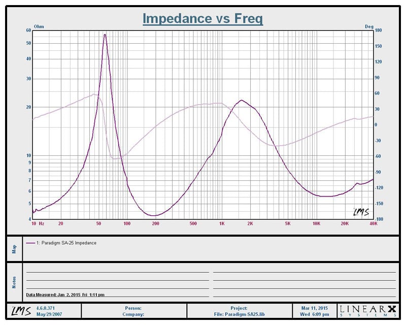

Paradigm SA-25 Impedance and Phase
The SA-25’s are rated at 8 ohms but in reality they are a 4-ohm speaker. There is no hiding this fact. I suspect Paradigm rated them 8 ohms for marketing purposes and because of their high sensitivity making them an easy load to drive. Care should be taken to use solid amplification when mating to these speakers as the 4-ohm dip in the 100-300Hz region can be problematic for low end receivers with inadequate power supplies.
