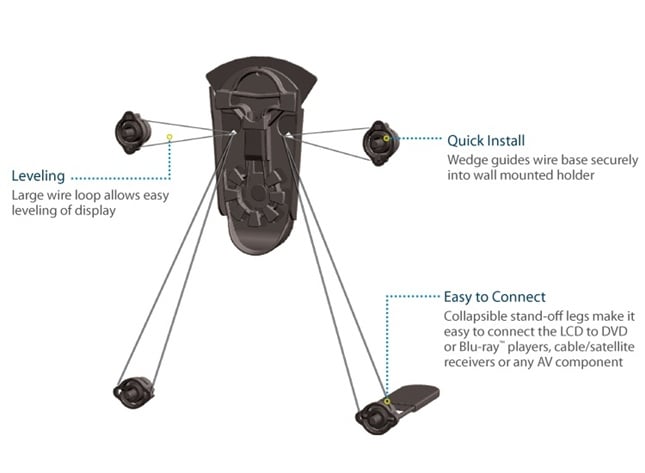

Looking like some sort of ancient spider fossil, Premier Mounts has released their new cable-based flat panel mount solutions. There are two, the CMT and the CMF (I'm pretty sure these stand for Cable Mount Flat and Cable Mount Tilt). I've seen solutions like these before but never one with a tilting function. For that reason, I'll be taking a closer look at the CMT rather than the CMF.
There is just about zero information on these mounts on the Premier website but expect that to change soon. Both of the mounts are designed to be installed on a single stud with displays up to 55" or 65 pounds (which ever comes first). They can be used with VESA mounting patters from 200x200mm to 600x400mm. The connection points (all four of them ont he CMT, only the top two on the CMF) are connected to the base by cables. When you want to level your display, all you need to do is pull on one of the cables.
mount

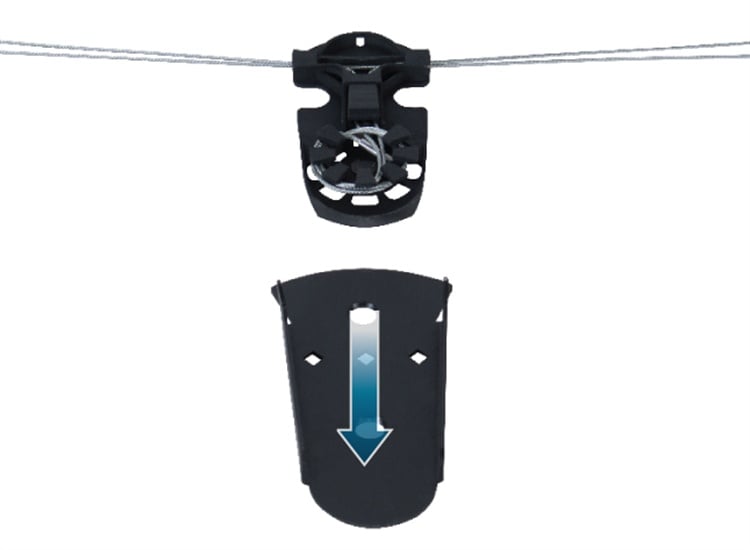

The "V" shaped mount back plate is only 6 by 3 inches and mounts to a wall stud. The flat panel anchors are mounted to the back of the display and the excess cable is pulled tight and wrapped around the adapter's teeth. That adapter is then snapped into the back plate. There is a locking screw to hold the adapter and back plate together. There is a small kickstand on one of the bottom anchors that can be extended up to 4.28 inches so that you can access the inputs on the back of the display.
The additional cables on running to the bottom two anchors on the CMT allows for tilting. Basically, all you need to do is pull the top of the display toward you (away from the wall). This will pull the cables through the mounting plates leaning the display down. This allows for tilt but no swivel. This means that your display will always be on the same plane as your wall (usually not a problem). The anchors look like they have some sort of rubber nub on the back to protect the wall. Premier also says that they include spacers with the mount for pushing the display even further off the wall or to prop up one side for a bit of swivel.
