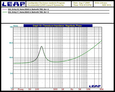

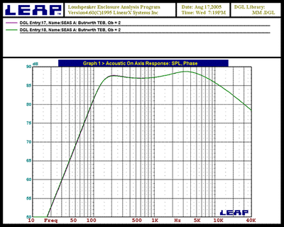

Modeling the mid-range driver in LEAP, allows us to see the amplitude response of the system pre- and post-break in. This was accomplished by designing a totally enclosed cabinet for the pre-break in driver, deriving the system amplitude response, then substituting the broken in driver and the re-running the simulation, with both plots displayed in the same graph for comparison. The results are shown in Graphic 1.
Clearly, the differences in amplitude response between the pre- & post-break in systems are negligible. Indeed, maximum amplitude difference within the passband of the system is on the order of .09 dB! In passing it should be noted that it was the broken in system that exhibited the down .09 dB amplitude response at resonance. Also included for comparative purposes are the impedance curves for both systems.
Note the impedance peak frequency for the burned in system was slightly higher than that of the non-burned in system.

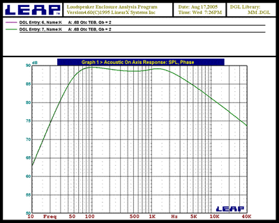

Next, a series of simulations were run this time using the 10" woofer. As in the preceding case, this was accomplished by designing a totally enclosed cabinet for the pre-broken in driver, deriving the system amplitude response, then substituting the broken in driver and re-running the simulation, with both plots displayed in the same graph for comparison. The results are shown in Graphic 3.
Graphic 3
As in the preceding case, the differences seen between the amplitude response plots of the pre- and post- broken in systems is negligible, the maximum magnitude difference occurring within the passband being .02 dB. Although difficult to tell given the graphic's resolution and the very small amplitude differences to begin with, it was the burned in system's amplitude response that was .02 dB down at resonance. In Graphic 4 we see the impedance plots of both systems, showing results similar to those seen in the mid-range simulations.

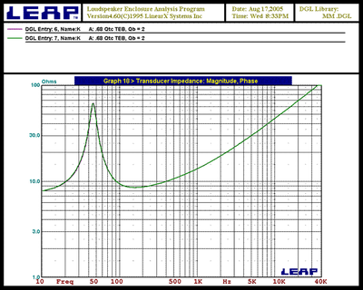

Graphic 4
The compliance of the air enclosed within the enclosure is significantly less than the driver's suspension compliance, therefore the enclosure has the dominant influence where it comes to determining things such as system resonance. Thus, owing to the physics of the enclosed box loudspeaker system, any pre/post differences in driver suspension mechanical compliance are constrained from having as large an effect on parameters such as resonance frequency, etc as intuition might lead one to believe it should.
Taken together, it's clear the volume of air confined within the sealed cabinet of the enclosed box loudspeaker system moderates any measurable and/or audible changes that might arise as a consequence of driver compliance changes.

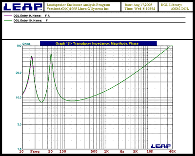

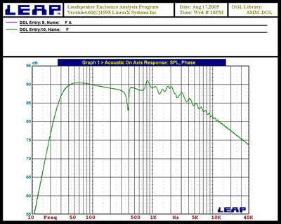

What about the case of a vented box loudspeaker system? What sort of pre/post break in changes in amplitude response occur?
Graphic 5 & 6 illustrate that pre/post-break in amplitude response and system impedance differences are, much like that for the totally enclosed box, very small indeed. This comes as no surprise. Just as in the case of the totally enclosed box, the compliance of the vented box (for most common, practical implementations of that design now in production) has the dominant influence, minimizing the effect of variations in driver suspension mechanical compliance.

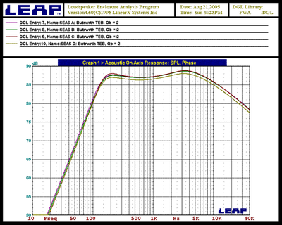

Four mid-range drivers, selected from the same production run, were measured and the data taken were used to work up the simulations. A totally enclosed system was designed for the first of the four drivers. The amplitude response of that system was selected as the baseline to which all others would be compared. Then the simulation was run again, each time substituting one of the remaining three drivers for the first in the cabinet designed for the first driver.
When the test series was run to completion, the resulting amplitude response graphs indicated that an end user would likely encounter larger system-to-system amplitude response differences (~1.04 dB Spl) owing to normal driver variances than would be encountered breaking in raw drivers. In Graphic 7 we see the results of that run.
Graphic 7

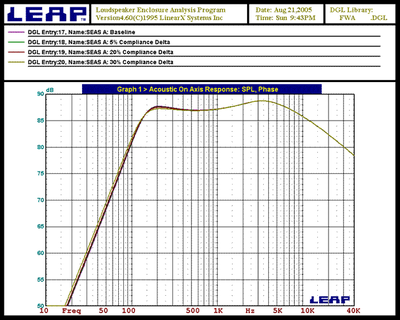

Further perspective was gained by running four additional simulations, this time modeling amplitude response variations arising as a consequence of altering suspension compliance 5%, 20% and 30%. The amplitude response in each case was compared with a baseline response, derived from the system designed around the data pulled from direct measurement of the first driver. From the resulting plots it can be seen that even compliance changes on the order of 20% - 30% have very little (~.65 dB spl @ max. passband variance) effect on a system's amplitude response.
From the foregoing analyses, it's reasonable to conclude that suspension compliance changes arising as a consequence of initial driver burn in has little effect on the performance of a loudspeaker system.
