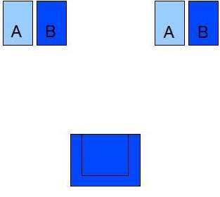

The physical positioning of speakers will have a big effect on your listening experience. Stores have limited space, so they shove as many speakers as possible into a room. Unfortunately, because of the laws of physics, two speakers cannot sit in the same space, so one or two sets of speakers may be in great locations, and the rest of them might be way too close together or too far apart (for satellite and bookshelf speakers, they may be too high). If they are too close together you will have a small sound stage. Too close to the back wall and the bass may be boomy. Not toed in properly and the imaging will not be precise.
When comparing more than one set of speakers they should be placed in as similar position as possible. Ideally, they are symmetrical and alternating. The image below shows an example of this using set A and set B of speakers.

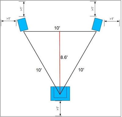

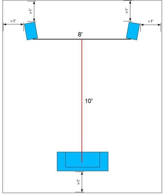

Once in the right locations, you will need to fine tune their positions. Set up the speakers and listening position in a triangle. When the distance between each speaker and the listening position is the same, an equilateral triangle is formed (Fig. A). The diagram below demonstrates this setup, showing a distance of 10’ between each speaker and the listening position, but notice that the listener is really only 8.6’ away. This “golden triangle” is often considered the ideal setup; however, the problem with this arrangement is that the speakers are toed in quite far, which focuses the sound for only one position (‘toe in’ is how far the speakers are angled in). We prefer closer to an 70-80% rule where the speakers are spaced out about 70-80% of the distance to the primary listening position, i.e. you are sitting 10ft from the speakers that are placed 8ft apart (Fig. B). This usually results in less toe in needed and thus more listeners can have a better experience. Ultimately, you will want to experiment with the toe in of the speakers and how far back you sit.
Fig. A - The Golden Triangle
Fig. B
You will also want to make sure the speakers are approximately the same distance from the back and side walls. At the very least, try to make sure they are at least 1 foot from any walls. If you want, bring along a tape measure to position the speakers precisely. People will look at you funny, but what the heck.
Once they are in the right positions, you can put in some music and listen to see how accurate the imaging is. As you sit and listen, you should be able to close your eyes and visualize where the performers are in the soundstage, this is called imaging. You will need to adjust the toe in until the imaging is precise. As you spend more time listening to speakers and demo material you will get better and better at speaker setup.
