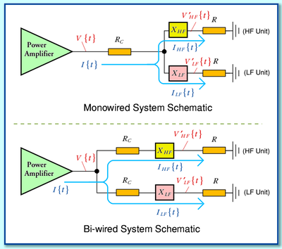

We can represent the conventional (‘monowired’) and ‘bi-wired’ systems by the arrangements shown in the above diagram. The loudspeaker is assumed to consist of a an HF unit (‘tweeter’) and LF unit (‘woofer’) which are intended to deal with distinct frequency bands. For the sake of simplicity we can assume each of these units behaves, electrically, like a resistive load, and give them the same resistance value, .
The loudspeaker is assumed to operate with the HF unit dealing with all frequency components in the signal above a chosen frequency, and the LF unit dealing with all frequency components below this frequency. This means we have to place appropriate networks or filters in between each unit and the input signal to ensure they are only presented with signal components in the desired frequency range. Ideally the filters should not lose any of the intended signal, but should also completely block any frequencies which are not in the band which the unit is intended to handle.
In order to ensure this, we have to employ a pair of networks which have frequency-dependent properties. These are represented in the above diagrams by the items labelled with and
We can then define the required behaviour of these networks by saying that
and
where is an appropriate value for the frequency which represents the boundary between the high and low frequency bands which we wish to direct to the HF and LF units respectively. The above definitions mean that the
filters act like direct links in the desired frequency bands, but like open circuits outside that band. This ensures no ‘leakage’ of current or power into the ‘wrong’ unit.
In practice the networks employed in a real loudspeaker can only approach the above ‘ideal’ behaviour. This means they will generally have a non-zero series impedance in the frequency range they are designed to pass, and a finite impedance in the band they are designed to stop (block). That situation, with an example of a simple choice of a real pair of networks, has been examined on other webpages. So here I will examine this ‘ideal’ case where the networks behave as defined above...

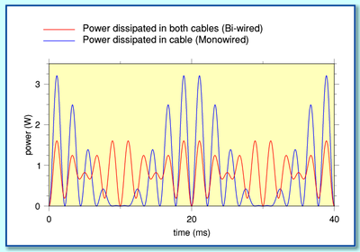

Using these values we can plot the above graphs showing how the resulting cable dissipations vary with time for the monowired and bi-wired arrangements. The shapes are clearly different, confirming that the patterns of dissipation are not identical.

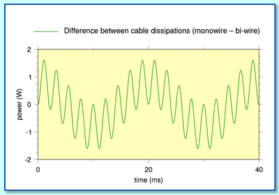

If we subtract total the cable dissipation in the bi-wired arrangement from that in the monowired arrangement we can define this difference to be
which, using the example of a signal with an HF and a LF sinusoid as above becomes
Using the same example as above we can plot a graph like that shown below.
This displays the difference between the cable dissipations for the two arrangements when they are driven by the same test waveform.
The above results do seem to present us with an anomaly or paradox, as described in the web thread. The signal power level and current injected into the system by the amplifier is identical in both arrangements. Each speaker unit has the same power, current, and voltage delivered to it with both arrangements. Yet the cable loss patterns are different! The monowired case shows a ‘cross product’ term involving both signal frequencies which is absent when the system is bi-wired. Does this not mean that the monowired system has a problem which is avoided by bi-wiring?

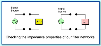

These networks have some interesting properties. If we look back to their defined impedance behaviour we find that they cannot have any power dissipation behaviour (i.e. resistance). The reason for this can be explained as follows.
Imagine the situations shown below where we take each of our filter networks and use a signal generator to check out their impedance properties. If we apply a test sinusoid with a frequency then we find that
behaves like it has an impedance of zero, and
behaves like an impedance of infinity. This means that no matter what magnitude of current we apply, we can’t get any voltage difference between the terminals of
. And no matter what magnitude of voltage we apply, we can’t get any current to flow through
. This all follows from the ‘ideal’ properties we defined these filters to have earlier on.
Since the power dissipated in a resistance is equal to the the product of the voltage and the current we find that neither network actually dissipates any power. In one case because the current is zero, and in the other because the voltage is zero. If we now try a frequency the roles of the filters swap over, but we get the same end result. Neither filter dissipates any power.

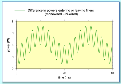

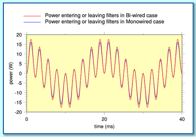

Using the same waveform with two frequency components as previously we can now plot the power levels for the filter networks in the two arrangements. This is illustrated above. Looking at the above plots we can notice two points. Firstly that these power levels can have either a positive or a negative value. Secondly, that their values for the monowired and bi-wired cases are similar, but not identical.
It is important to remember that – unlike the situation where we are considering resistances – the above power levels do not represent dissipation losses. This is because the filter networks, as a consequence of their defined properties, have no resistance so cannot dissipate any power. Hence when the above values are positive this represents the rate at which energy is stored within the filter network(s), and when they are negative it represents the rate at which energy stored within the filter network(s) is released back into the rest of the system. This behaviour is normal for ‘reactance’ and reactive elements (e.g. inductors and capacitors) generally exhibit this behaviour.
We can now define the difference
where the subscript ‘M’ indicates the monowired values and ‘B’ the bi-wired values. From this we obtain the result
For our chosen example signal the above illustrates this difference in filter network power levels between the monowired and bi-wired arrangements.
Now, if we now look back to the difference in cable dissipation levels between the monowired and bi-wired arrangements we discover that
What this tells us is as follows:
That although the monowired and bi-wired cases show patterns of cable energy dissipation levels which vary with time in different ways, this difference is equal and opposite to the difference in their patterns of energy storage and release in the reactances of the filter networks. In reality, the two arrangements differ in the details of temporary energy storage and release, and this alters the time variations in the power dissipation in the cables.
As a result, the two behaviours cancel out, and the two arrangements behave identically so far as the amplifier and speaker units are concerned. Thus if out interest is in comparing the arrangements for the task of conveying signals from the amplifier to the speaker units, then they are indistinguishable. The ‘internal’ details differ in terms of how energy is stored or dissipated, but this has no consequence so far as using the system is concerned.
The ‘conundrum’ outlined earlier – that the systems are the same so far as amplifier and speaker units are concerned, but the cable dissipation patterns differ – can now be seen in terms of the way the filter networks temporarily store and release energy as a consequence of their defined properties. No energy is mysteriously ‘lost’ or created out of nothing. All that is happening is that, as is usual with circuit elements with frequency dependent behaviour, some energy storage and release is involved.
