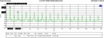

Top Left pic (clipped sinewave) ; Top right pic: amplifier power vs distortion
Bottom Pic: FFT Analysis of Amplifier in Clipping
As you can see in the left image above, the middle peak and dip of the sine wave is clipped or flattened once the rail voltage of the amplifier is exceeded. The pic to the right shows an amplifier power vs distortion measurement I conducted. As the amplifier starts to visibly clip, it approaches 1% THD. This is clearly an audible amount of distortion that can also be seen with an oscilloscope. (The oscilloscope shows us the voltage versus time). If you do an FFT analysis of the spectrum (showing us the frequency components in the time signal displayed by an oscilloscope), you can see all of the nasty harmonic byproducts (Multiples of the original frequency or harmonics for short) that are added to the original 1kHz fundamental. This system is producing severe distortion due to clipping. This not only sounds bad, but it's bad for the speakers too.
If a receiver's power supply has sufficient current supplying capacity, and the amplifiers output impedance is low enough, then it can operate fairly closely to an ideal voltage source doubling available output power as the load impedance halves and the voltage output remains the same. (see Eq2) (Remember, in a good amp the same voltage is present at the loudspeaker terminals for an 8 ohm, 4 ohm, or a 1,000,000 ohm loudspeaker is present, and is dependant on the signal input amplitude and gain of the amplifier., and NOT the load attached) So when a 100 Watt per channel receiver is driving an 8-ohm load, it delivers 28.3Vrms. (28.32/8 = 100) which into a 4-ohm resistive load would produce 200 watts. (23.82/4 = 200) Most receivers don't operate so ideally however, so while they all will try to deliver more power into a lower impedance, they may first run out of voltage, or worse yet, available current. This lack of available current will cause the voltage rails to shrink, clipping the signal, and thus generating more heat as losses in the process.

As a professional reviewer and President of this website, I am constantly
evaluating amplifiers and A/V receivers in my 6,000ft^3 theater room using my 4-ohm reference speakers playing at very high levels
(>100dB at the listening area) using the high impedance setting and have
never run across a situation that warranted me to flip to low impedance mode.
In fact, when I've tried the low impedance mode, I noted significantly more
audible distortion as the amplifiers prematurely entered voltage clipping due
to the power limiting. Remember the
impedance rating is NOT an average, but rather a warning of about how low the
speaker's impedance can drop over the whole audio range.
