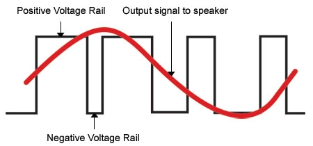

Basically, a digital (Class D) amplifier takes an incoming analog signal and converts it into a digital representation comprised of pulse widths. Although there are a number of different design variations, Class D amplifiers are essentially switching amplifiers or Pulse Width Modulator (PWM) designs. The incoming analog audio signal is used to modulate a very high frequency Pulse-Width Modulated (PWM) carrier that works the output stage either fully on or off. Later on, this ultra-high-frequency carrier must be removed from the audio output with a reconstruction filter so that no ultra-high frequency switching components remain to corrupt the audio signals.
Differences in Pulse-Width and Pulse-Code Modulation
A digital amplifier’s operation is a little like the way a CD or digital recorder works with PCM (Pulse Code Modulation), the basis of all digital audio-recorded media. In PCM digital recording (a CD, for instance), the digital sampling ADC (analog-to-digital converter) “describes” the incoming analog voltage and frequency with a digital code of ones and zeroes. But in a digital amplifier, the Pulse-Width Modulator describes a low-frequency audio signal as the “widths of a pulse” so many milliseconds wide. (A high frequency would be a narrower pulse, fewer milliseconds wide -- see diagram). Once the analog audio signal (the curving red sine wave overriding the pulses) is “described” in terms of pulse widths, it is amplified and then converted back to analog form. During that process, a reconstruction filter must remove all the on-and-off pulses, leaving only the lower frequencies that represent the audio signal.
Voltage Rail
As Axiom’s chief R&D engineer Tom Cumberland describes it, a digital amplifier is a “power DAC”, and of course a DAC (Digital-to-Analog Converter) is the basis of all digitally recorded media, whether we’re talking about CDs, hi-res audio, Blu-Ray soundtracks, DVD video, and so on. The view of some that “all digital amplifiers are crap” is not true. In fact, the clock rate of a good digital audio amplifier is typically in the range of 350 to 500 kHz (that’s 500,000 Hz). (Axiom’s A1400 digital amplifier uses a 450-kHz clock frequency.) By contrast, even the highest-resolution digital audio system (DVD-Audio and a variant used for Blu-ray soundtracks) runs at 192 kHz, which is far below the clock rate of a good digital amplifier.
