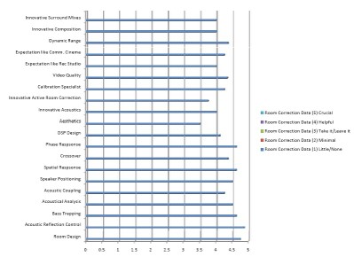

Jeff, Here are you answers!
| Responder: Russ Miller | Answer ranking 1 - 5 |
| 1. Room design including sound isolation, room dimensions, and surface finishes? | 5 |
| 2. Use of acoustical reflection control devices such as absorption and diffusion panels? | 5 |
| 3. Use of acoustical low frequency control devices either passive or tuned? | 5 |
| 4. Acoustical measurements of the room actual or predicted? | 3 |
| 5. Acoustical coupling of speakers to surfaces, i.e mounting options (stands, in-wall, shelves, etc.)? | 3 |
| 6. Speaker positioning? | 4 |
| 7. Spatial response, meaning how the room responds at various positions not just a single location. | 4 |
| 8. Crossover adjustments. | 5 |
| 9. Phase response of speakers including subwoofer(s). | 5 |
| 10. DSP design: number of filter points, measurement points, etc… | 5 |
| 11. Aesthetics including surface finishes, furnishings and lighting? | 4 |
| 12. Consumer demand for innovative acoustical treatment products? | 4 |
| 13. Consumer demand for innovative active room correction products? | 4 |
| 14. Use of specially trained room calibration specialists? | 4 |
| 15. Video Quality? | 5 |
| 16. End user expectation is similar to control room environment? | 5 |
| 17. End user expectation is similar to a commercial cinema? | 4 |
| 18. Dynamic range of content | 5 |
| 19. Changes in musical composition and sound effect elements in relation to the advances in residential theaters? | 5 |
| 20. Changes in surround mix techniques due to advances in residential theaters? | 5 |

| Responder: Gavin Haverstick from Auralex | Answer ranking 1 - 5 |
| 4. Acoustical measurements of the room actual or predicted? | 5 |
| 5. Acoustical coupling of speakers to surfaces, i.e mounting options (stands, in-wall, shelves, etc.)? | 5 |
| 7. Spatial response, meaning how the room responds at various positions not just a single location. | 5 |
| 8. Crossover adjustments. | 3 |
| 9. Phase response of speakers including subwoofer(s). | 4 |
| 10. DSP design: number of filter points, measurement points, etc… | 2 |
| 11. Aesthetics including surface finishes, furnishings and lighting? | ----- no reply |
| 12. Consumer demand for innovative acoustical treatment products? | 5 |
| 13. Consumer demand for innovative active room correction products? | 2 |
| 14. Use of specially trained room calibration specialists? | 5 |
| 15. Video Quality? | 2 |
| 17. End user expectation is similar to a commercial cinema? | 5 |

When the answers to the questions are compiled, one can quickly note that the items a “lay-person” may desire most in a home theater are inversely rated to the experts. Aesthetics are key because who wants an uninspiring room. However, a correct room is not directly related to how the room looks. Now in terms of the experience a room that is comfortable, visually appealing and has superior video can offer a fantastic theater experience…the psychoacoustic intangibles can help offset audio issues.
On the cautionary side, expect a growing onslaught of marketing spin on this topic from all sides. As more speaker and receiver manufactures embrace and offer ARC, the message that you can correct all room issues digitally will be loud. It certainly is easier to get wife approval on a black box than “bulky” things on the walls. Please understand that as great as the advances are in ARC, you have to put all results into perspective. I’ll restate there is no definitive “correct” room, only rooms where the compromises are known and addressed appropriately.
On a personal level, I greatly appreciate the input of all the participants. These pros offer tremendous insight. Don’t be fooled by the brevity of some. In fact, the response from Chris at Audyssey sums up the whole topic in my opinion. Also take to heart the depth of others, the carefully chosen words from Curt of Trinnov or the approach oriented comments from Bryan at GIK. Each of these individuals has a stake in your space, each wants your experiences to be tremendous, and each influences the advancements and tools that are available.
