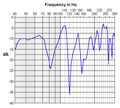

Standing waves
Standing waves (also called room modes) are low frequency resonances that take place between two parallel reflecting wall surfaces. They result from the interaction of wavelengths (λ) and the distance between the surfaces. So in the low register, standing waves cause: a level boost at some frequencies, an extent of the duration of sound at those same frequencies (resonance) and some profound dips at other frequencies.
low end response
A typical listening room low frequency response.
The phenomenon does not produce itself the same way at different locations in the place. This is why low frequency response vary from place to place in a room.
