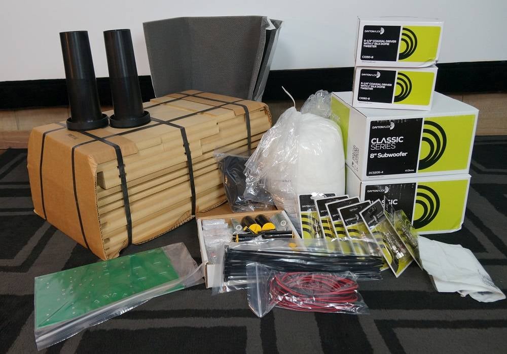

The parts for the Orian arrived in two boxes. A large box contained the enclosure panels and the other contained all other components. Both boxes used a generous amount of crumpled paper to protect the items inside, and it should be sufficient to survive the typical abuses of parcel shipping. The packages contained all the parts needed for the two loudspeakers. The kit does omit loudspeaker feet, but that isn’t mission-critical for a fully functioning loudspeaker, and people have a wide variety of preferences regarding speaker feet, so it isn’t a bad idea for Parts Express to skip that component. Of course, the user will also have to supply any paint, primer, or finishing items.

Orion parts4
The good news is that the Orian assembly manual is very thorough and clear. There are a lot of steps toward completing this speaker, but each step is covered carefully. Unlike directions for Ikea furniture where a dozen steps are grouped into one, each step described by the Orian manual is mostly an individual action, so there isn’t as much confusion as with many other consumer products that require assembly. Nonetheless, I would urge buyers to carefully read over the instruction manual in its entirety before beginning the kit; I did this and it helped me understand the logic of the assembly process which possibly helped to prevent mistakes later on.

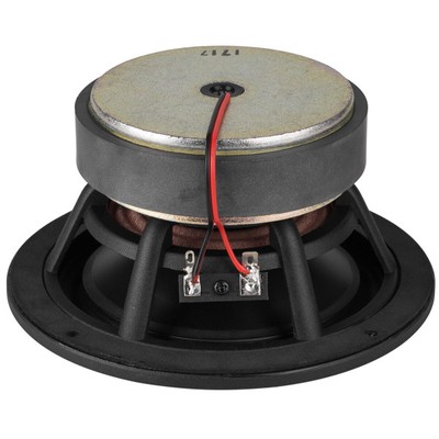

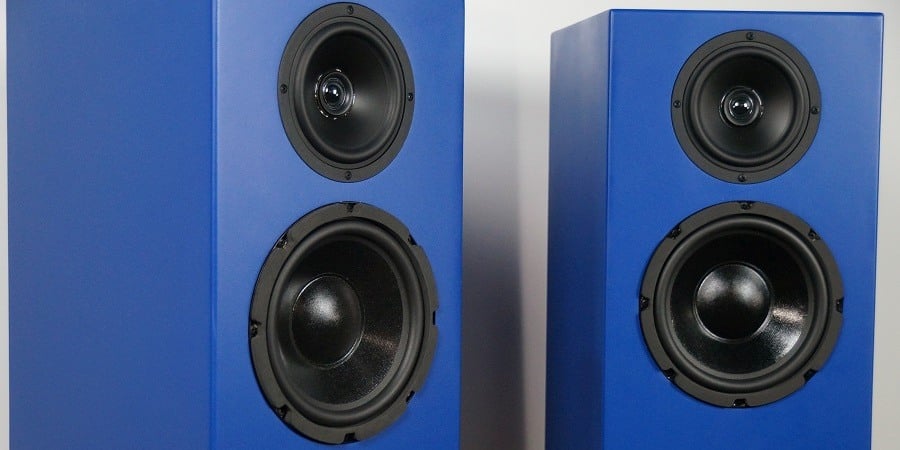

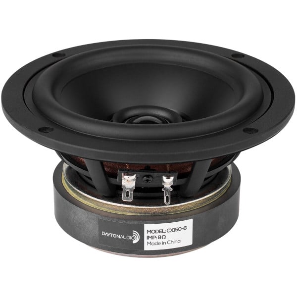

As stated above, the Orian is a 3-way stand mount speaker that uses a coaxial driver in an open back cabinet. The coaxial driver is the Dayton Audio CX150-8, which has a 1” silk dome tweeter nested in a 5 1/4” diameter polypropylene midrange cone. The midrange uses a 1 ⅕” diameter voice coil in a large ferrite magnet and is spec’d to have 5 millimeters of one-way linear excursion, which is a healthy amount of throw for a midrange. The tweeter has a neodymium magnet and uses the cone shape of the midrange as a waveguide. The driver has a thick, cast aluminum frame and a very substantial feel.

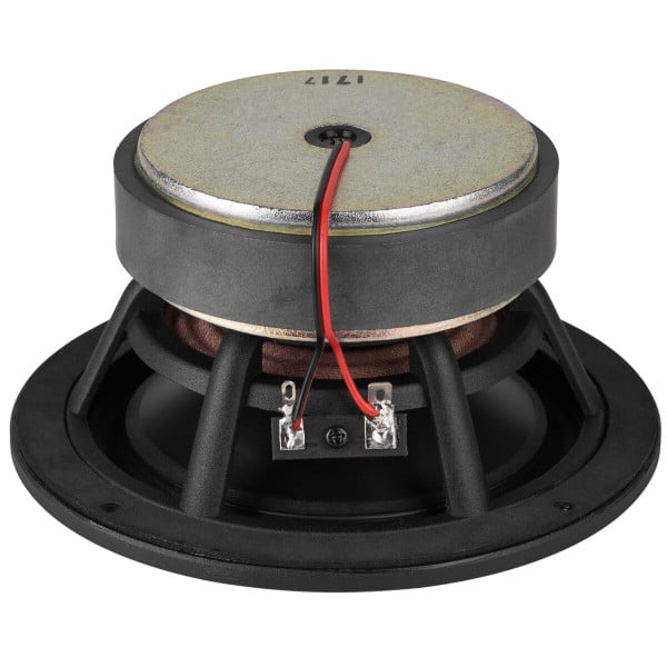

Dayton Classic 8 motor side Dayton Classic 8 cone side

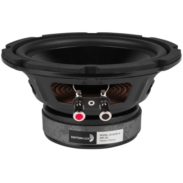

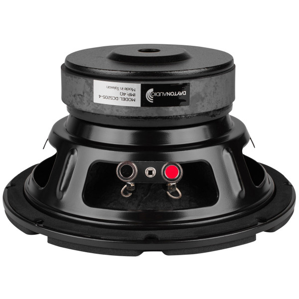

Bass is provided by the Dayton Audio DCS205-4. This 8” bass driver has nearly 9mm of one-way linear excursion. It uses a 4.7” diameter magnet with a 1” thickness. The back plate is bumped out to make room for more excursion. Venting is done through the pole piece which also has a copper cap to help reduce inductance. The voice coil has four layers and is wound around a 1 1/2” polyimide former. This is a much beefier bass driver than what typical bookshelf loudspeakers have and is something you would expect to see on a brawny tower speaker.

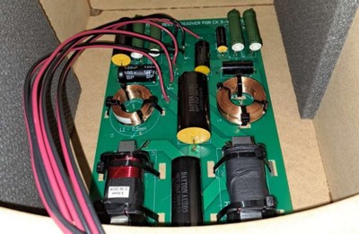

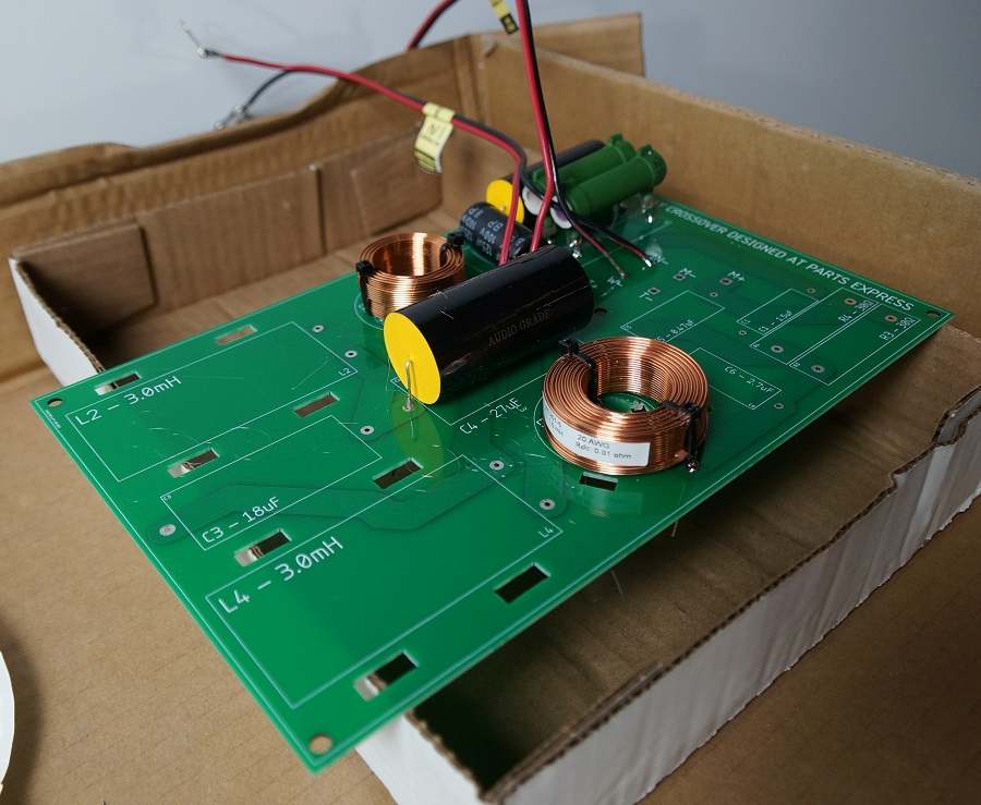

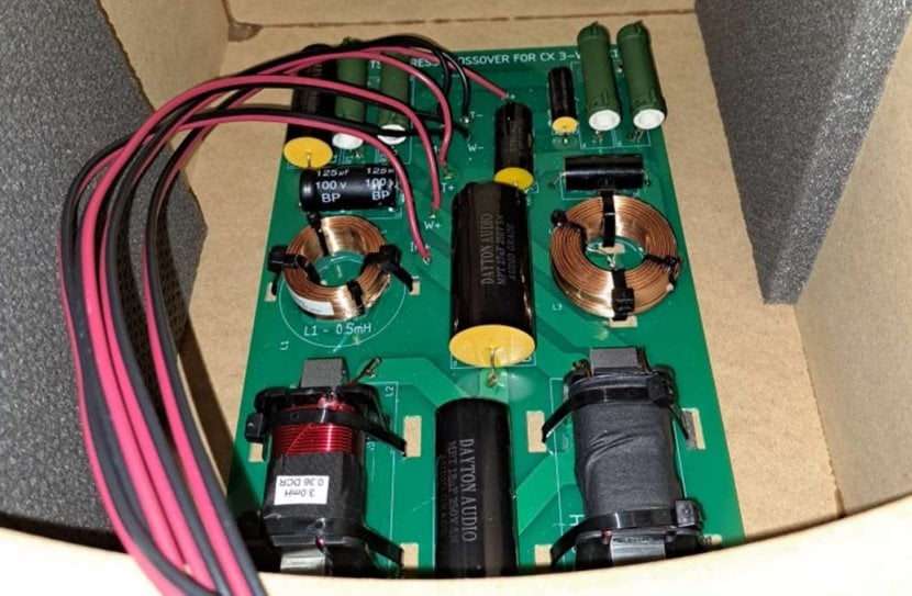

cx3 crossover assembly   cx3 crossover
The crossover circuit is a hefty 15-element piece that uses high-quality components usually seen in high-end speakers. Assembling it is a bit painstaking but not too difficult. The capacitors are mostly Dayton Audio units that have 5% tolerances. We get two chunky iron-core inductors and two air-core inductors. The included resistors are much more substantial than the tiny things I usually see in loudspeaker crossovers. What is very convenient is that Parts Express has included a printed circuit board with the conductive traces already laid out instead of blank breadboards, so all the user has to do is glue the components on the board and then solder them to the solder pads on PCB. Special attention should be paid to how the solder adheres to the board and wire. For those who do not have much experience in electrical soldering, I strongly recommend that they look over some tutorials before attempting this. The crossover frequencies are 500Hz from bass driver to midrange driver and 4kHz from midrange driver to tweeter.

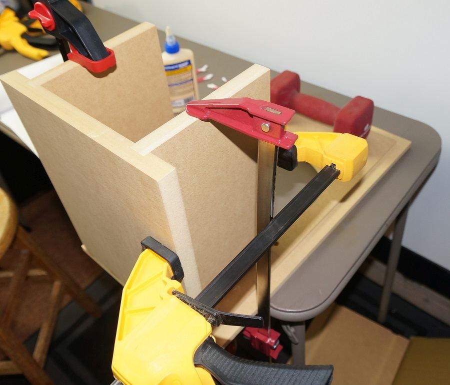

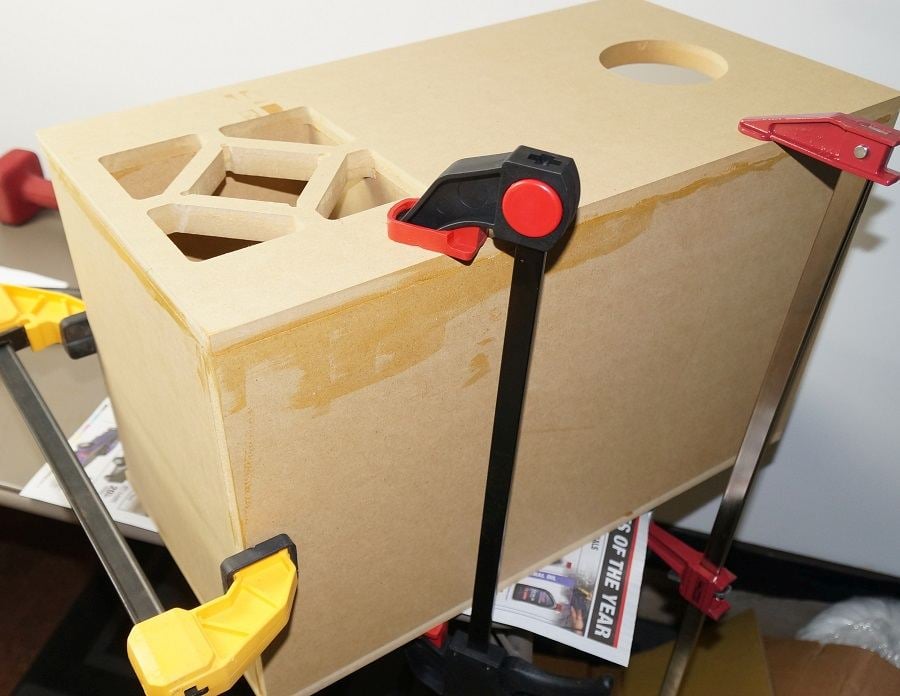

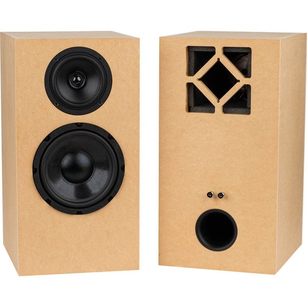

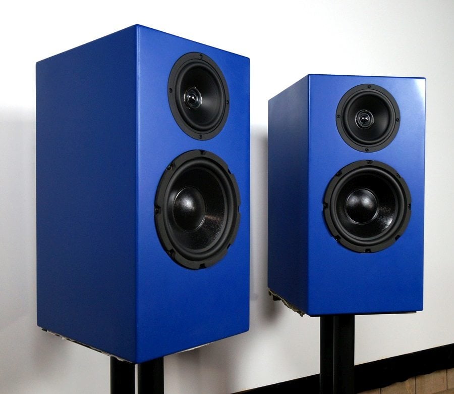

cx3 mid chamber assemblyAll of the enclosure paneling is made from ¾” thick MDF. The complex dado and rabbet joints that are CNC’d into the panels mean that duplicating this kit with your own woodworking skills would be very difficult unless you had a CNC machine as well as the plans. In order to assemble the enclosure, users will need wood glue and 2-foot clamps. I had a bunch of 1-foot clamps and thought I was covered but unfortunately found out that the enclosure had a greater depth than 1 foot. The good news is that users will not need clamps with really powerful clamping forces, and the light -light-to-medium-force clamps that will suffice for this kit are not expensive. I was able to get everything done with two 1-foot clamps and two 2-foot clamps. Before starting to glue everything together, I would advise users to test fit all the panels together to ensure all the panels conform nicely. Some of the dado joints were pretty tight, and I found it did require a bit more force than I expected to get everything together; I am glad I found that out before I started gluing anything so I knew what to expect.
I decided to round all of the edges of the Orian speakers that I built because I thought it would be easier to paint evenly than the hard 90-degree edges of the MDF. Sharp edges also dent much easier if they make contact with anything, and I wanted something that wouldn’t dent or chip the finish so easily. For this, I bought an edge chamfer with a rounding bit that made it easy to round the corners. I also decided to put internal edge braces in the speaker to help reinforce the enclosure to make it sturdier — not that the cabinet wasn’t sturdy as is, but I decided to make it extra durable in case I ever wanted to ship it anywhere.

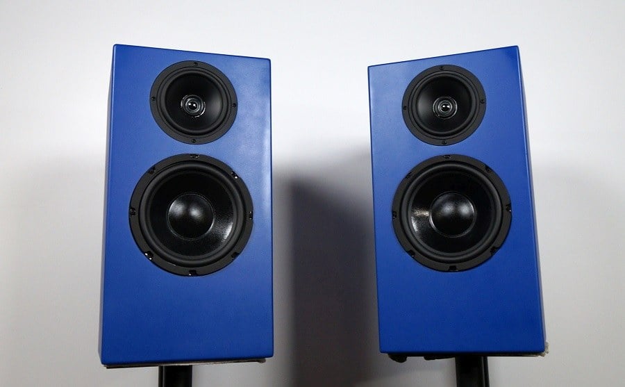

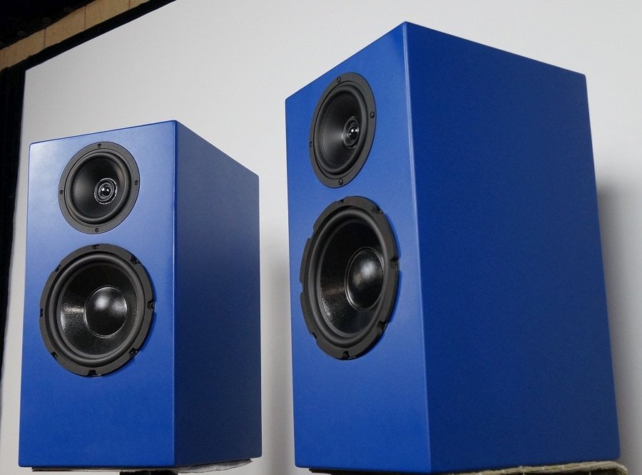

Orian pair bareThe most difficult part of constructing the Orian was painting it, but that was a difficulty I brought on myself due to the finish that I desired. On this point, I strongly urge buyers to look up tutorials on how to properly paint MDF. It is not a wood that will give you fabulous results from just going over a couple of times with a primer-and-paint-in-one finish. For my speakers, I gave them a couple of layers of Zinsser FastPrime oil-based primer/sealer and sanded down the wood for a very smooth surface before applying each coat. I decided to paint the speakers blue because nearly every speaker that I have reviewed is either black or wood veneer, and I wanted something unique, so I went with a dark blue. Rust-Oleum’s ‘Sapphire Blue’ satin protective enamel was the closest approximation to what I had envisioned. I ended up using four cans since I made my fair share of mistakes and had to sand off quite a few sections to redo them. It is important to allow for enough drying time for each coat of paint, and since I had applied many coats, it took about a week of applying a new coat daily to get the nice, uniform finish that I wanted. While the final results weren’t perfect, I was still pretty happy with them, and I wasn’t expecting perfection anyway since I was a novice at this kind of painting.
cx3 pair12

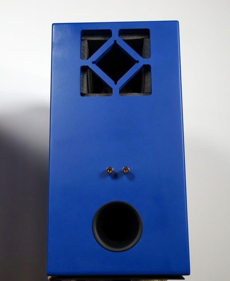

Once the cabinet finish is complete, the next step is to install the acoustic damping and then the crossover circuit. Parts Express gives you just enough acoustic stuffing to cover the interior of the enclosure. I had some extra acoustic stuffing of my own on hand, so I applied some on the back panel as well as in the space between the midwoofer chamber and side panels. The extra that I applied probably doesn’t make a significant difference, but I wasn’t doing anything else with it, so I figured why not. Installing the crossover circuit on the bottom panel was a bit tricky because there was not a whole lot of space to work in the enclosure itself. Wiring up the crossover to the drivers and input terminals is easy, but it really pays off to have all of the wires, as well as binding posts, clearly labeled with stickers, or else that process will become very tedious. It’s very important to make sure the tweeter wire is going to the tweeter and the midrange wire is going to the midrange. The tweeter can be destroyed very quickly when amplified if the leads are accidentally swapped out of the crossover and it is being fed the midrange signal.
It will be around this point when users decide whether to put damping in the rear chamber or let it emit all of the rear midrange energy. The purpose of the open back to the midrange cone is to add more late acoustic reflections, which add a sense of spaciousness and depth to the sound. We will get into the audible differences, both subjective and objective, further on in this review, for those who want a more informed choice in this decision, but it is also easy enough to just install and uninstall the ‘Acousta-stuff burrito’ that damps the rear energy output, so users can hear the difference for themselves.
cx3 rearBefore powering up the speakers, users may want to double-check the impedance to make sure everything is working properly. The easiest way to do this is to use the Dayton Audio DATS V3 test system from Parts Express ( Dayton Audio DATS V3 Product Page) and compare their impedance plot to the measured response in this review. However, that is $130 for something that the user may only use once if they are only interested in this kit and do not already own the DATS V3 system. A less expensive but much more involved process to measure impedance can be done with Room EQ Wizard and a 100-ohm resistor (Impedance Measurement using REW), but that isn’t really a method I would recommend to anyone who doesn’t have any training as an electrical technician. Alternatively, users with measurement microphones could perform on-axis acoustic measurements of the speakers and compare their measurements with our acoustic measurements or the measurement shown in the Orian assembly manual.

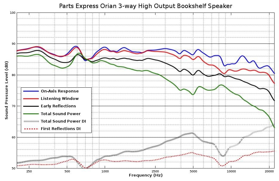

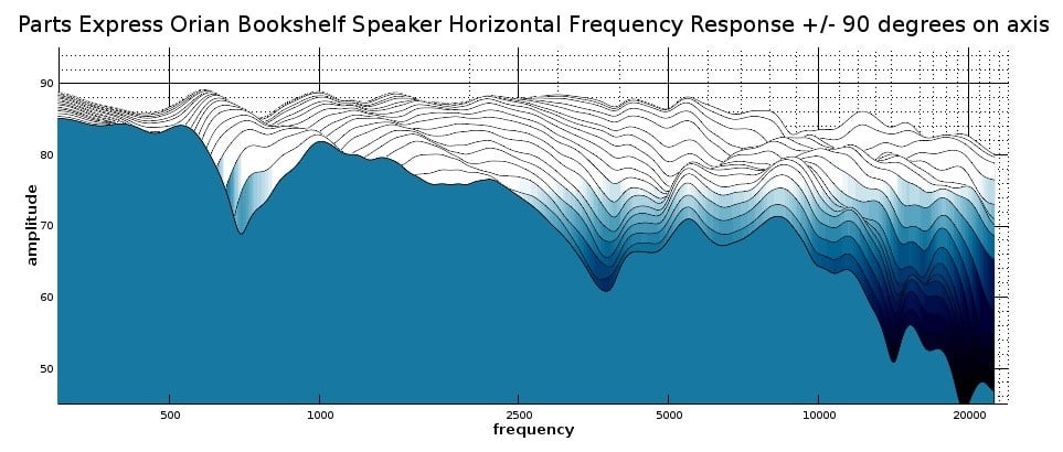

The above graph shows the direct-axis frequency response and other curves that describe the Orian’s amplitude response in a number of ways. For more information about the meaning of these curves, please refer to our article Understanding Loudspeaker Measurements Part 1. The results here are fairly smooth until we get into the tweeter’s band which looks to be a bit lower than the midrange’s. While I thought the Orian speakers were on the warm side, I didn’t notice much missing treble, and I think the explanation can be seen in the directivity indexes. As the on-axis and listening response declines in treble, which looks to start around 6kHz, the directivity index also declines, meaning that the dispersion in that range widens out. In other words, more acoustic energy is being spread out over a wider angle, at least out to 10kHz where the dispersion narrows down again. That means that the lowered on-axis treble is being supplemented by acoustic reflections from elevated treble at far off-axis angles. Since a significant chunk of higher frequencies is composed of late reflections, one byproduct of this approach is that precise imaging is pretty much impossible, and this is what I heard. We get a very broad and deep soundstage in exchange for pinpoint imaging; some listeners will enjoy the broad imaging that this serves, but others will prefer a more focused soundstage. I can appreciate both approaches, and I would say this is purely a matter of personal preference. It makes for a strange graph, but I enjoyed the sound that it resulted in.
cx3 3D waterfall response
cx3 2D waterfall response

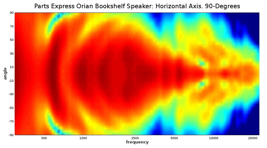

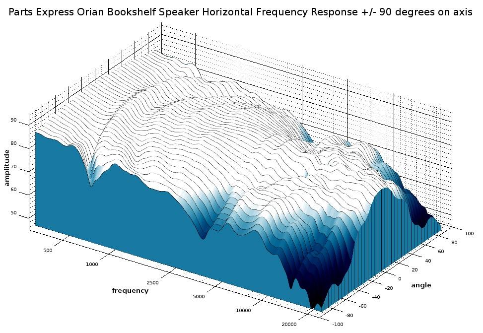

The above graphs depict the speaker’s lateral responses out to 90 degrees in five-degree increments. More information about how to interpret these graphs can be read in this article: Understanding Loudspeaker Review Measurements Part II. In these graphs, we get a closer look at the story that was only hinted at in the previous ‘spin-o-rama’ family of curves. A splurge of off-axis treble begins to shore up a decline in ‘listening window’ treble above 5kHz or so. I think this is the result of the way that the tweeter dome interacts with the midrange cone as a waveguide rather than the dipole design in which the midrange is mounted. The on-axis response is admirably linear until 8kHz or so, and that is the frequency band in which most content lies. We do see some mild off-axis cancellation lobes above 500hz, and this is likely a consequence of the dipole design; I was expecting more severe off-axis nulls from the dipole cancellation, and these artifacts are probably not audible in any normal listening situation. They are not particularly wide nulls and also shift in frequency per angle, so acoustic reflections will likely fill in any dips in the in-room response at a listening position in a normal room. We can see in the far off-axis response that the midrange doesn’t have perfect directivity matching with the tweeter, but perfect directivity matching was never in the cards for a loudspeaker with a dipole midrange, so I don’t think that matters too much.
CX3 polar map
The above polar map graphs show the same information that the preceding graphs do, but they depict it in a way that can offer new insight regarding these speakers’ behavior. Instead of using individual raised lines to illustrate amplitude, these polar maps use color to portray amplitude, and this allows the use of a purely angle/frequency axis perspective. The advantage of these graphs is that they can let us see broader trends in the speaker’s behavior more easily. For more information about the meaning of these graphs, we again refer the reader to Understanding Loudspeaker Review Measurements Part II.
As can be seen in the above graph, the Orian speakers constrict in dispersion as the midrange crosses over to the tweeter. The tweeter expands dispersion again but in a somewhat erratic manner. This polar map makes it look like the speaker is beaming like a laser above 8kHz or so and thus would have a very small ‘sweet spot’ where listeners must be on-axis to hear treble, but in practice, I found the speaker did not greatly change its tonality within a somewhat broad angle — I would say +/- 25 degrees is about the range I experimented with. Nonetheless, I did settle on having the speaker aimed directly at my listening position, and that is what I would recommend for most listeners for the most even tonality. Outside of that range, listeners might get hit with some sharp nulls, but I don’t think they have a wide enough frequency band to have a major effect on the sound, although they probably do have an overall effect of softening the sound of the speaker.

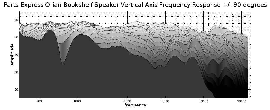

cx3 2D waterfall response Vertical
The above graph shows the Orian’s response behavior along its vertical axis where zero degrees is directly in front of the tweeter, negative degree values are below the tweeter, and positive degree values are above the tweeter. One of the charms of a coaxial design is that it doesn’t change its acoustic behavior much if the speaker is standing upright or lying on its side. Laying the Orian on its side may increase some baffle reflection and diffraction effects along the horizontal axis, but I wouldn’t guess that would make a major impact on the sound character. The vertical axis response of the Orian is going to be roughly similar to its horizontal axis response, so those users who have a wide space for a standmount speaker — but not a tall one — have a very interesting choice in the Orians. Traditional bookshelf speakers are two-way speakers that are simply not suited for use on their side since they are engineered for a much better horizontal response over a vertical one, and a sideways orientation flips these axial behaviors. The problem with that is the horizontal response is almost always much more important unless the listener has to be seated way above or below the speakers. This is not a dilemma for the Orian, and it has wider vertical and more even coverage than traditional stand-mount speakers.

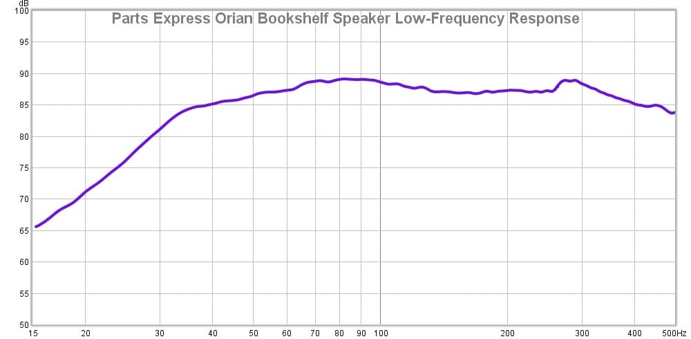

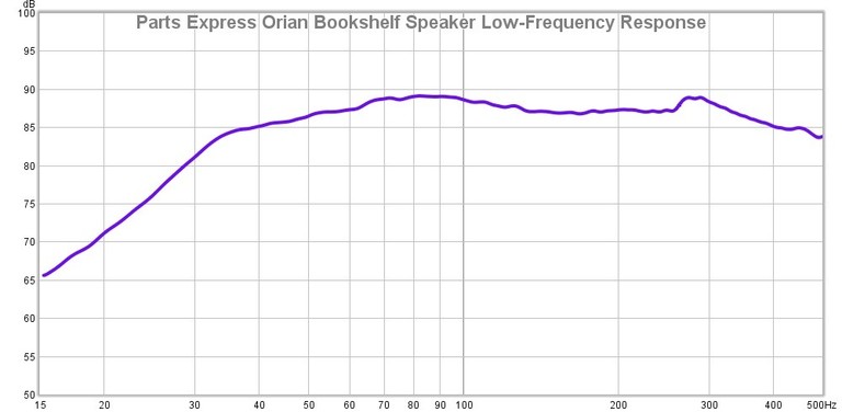

cx3 low frequency response
The above graphs show the Orian’s low-frequency responses that I captured using groundplane measurements (where the speaker and microphone are on the ground in a wide-open area). In my listening, I did get a sense that the bass region was overall a tad elevated compared to higher frequencies, and we do see that here, although not as much as I was expecting. On the whole, the woofer level looks to be maybe two to three decibels hot on average, and this contributed to the warmth of the sound. While I thought it did pull the sound away from a more neutral signature, I didn’t mind it, nor did I find it obtrusive. For my own tastes, hot bass can be intrusive, but more so in cases where port tuning is very hot to make some bookshelf speakers sound bigger than they really are. These end up having big spikes in lower mid-bass, and that can give those speakers a monotonous hum that makes their bass a one-note wonder. In the Orians, the subwoofer driver’s entire range has a slight elevation, and this lends it a weightiness without hammering on a narrow range. While my ideal is bass that is even with the rest of the range, the voicing of the Orians doesn’t bother me, and most people seem to like it. The bass range can be easily tamed by equalization for those who prefer a more balanced presentation.
As for low-frequency extension, this bookshelf speaker impressively digs down to about 34Hz before the roll-off begins. Room gain should net a solid response down to 30Hz or even a bit lower unless the room is very large. That kind of extension matches what we see in most tower speakers.

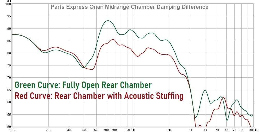

cx3 rear damping difference
The above graph shows the difference that applying the acoustic damping to the rear chamber will make to the Orians. The most affected frequency band starts at 400Hz and ends around 3kHz. The stuffing doesn’t fully stop rear acoustic radiation but rather attenuates it by about 6dB on average. 6dB is not an insignificant reduction, although the Orians will still produce enough sound out of the rear chamber to have an audible effect. As would be expected, the affected region is primarily just the midrange. Above that range, the output is too low to matter at a 20dB drop-off. As was stated in the listening sessions section, the difference between damped and undamped operation was audible. While imaging was not razor sharp with the damping installed, it was considerably tightened from a fully open midrange chamber. When fully open, the soundstage was extremely wide but the imaging was very broad, at least in my listening room. Those who want “bigger-than-life” imaging will enjoy the sound character of these speakers with the rear chamber fully open. It can produce a pretty epic sound that is appropriate for the right content. The acoustic stuffing ‘burrito’ is easy to insert or remove, so it’s not hard to dial back the rear radiation to minimize this “big” sound character on content where it’s not wanted.

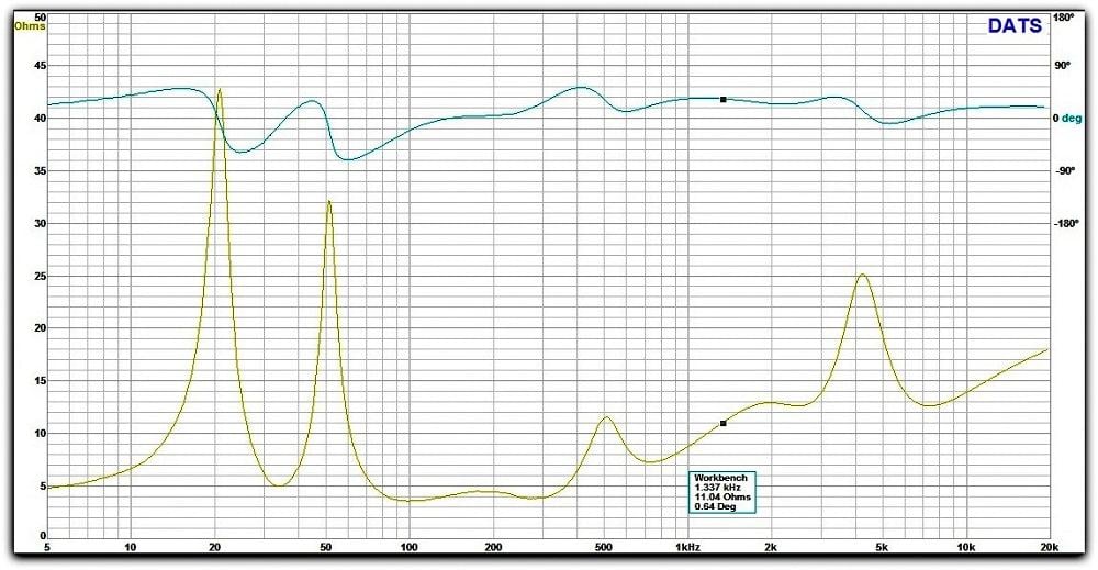

CX3 impedance
The above graph shows the electrical behavior of the Orian speakers. This has to be considered a 4-ohm speaker since most of the mid-bass dwells in that range, but it’s a relatively benign load on the whole. Few amplifiers would have trouble driving these speakers. We can see from the dip in the low-frequency saddle that port tuning seems to be about 34Hz, which matches what we see in the low-frequency amplitude response.
I measured sensitivity to be 85.5dB for 2.83v at 1 meter, and that would seem to be significantly above Parts Express’ sensitivity specification of 83dB for 1 watt at 1 meter, but when we factor in how the relationship between impedance and voltage affects power as measured in wattage, the difference makes perfect sense. Hoffman’s Iron Law dictates that the Orian can not be a particularly sensitive speaker; in the trade-off between small size, high efficiency, and low-frequency extension, Parts Express opted for low-frequency extension and small size over high efficiency. As was said before, it has the displacement to produce high output, but the required power must be supplied. For some nice dynamics, I would recommend at least a 100-watt amplifier.

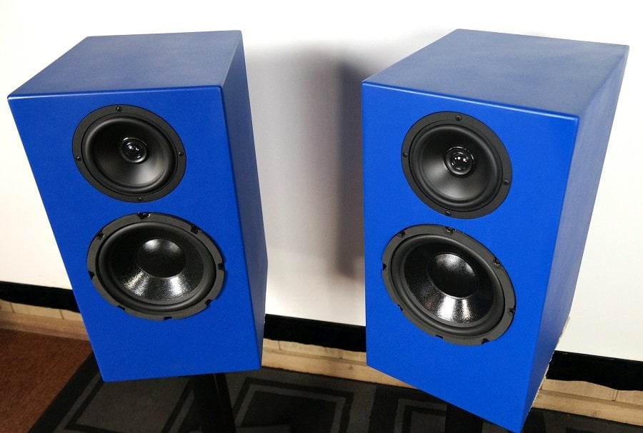

cx3 pair10
As a DIY kit, I think that while this is a rather complex loudspeaker, a huge plus is that the instructions are very clear and easy to follow. The instructions are so well done that even though I was new to loudspeaker building and this is considered a higher-difficulty kit, I was still able to get it right in the end with few mistakes. It also helped that there weren’t really any curveballs, and the assembly process worked just as the instructions had anticipated, so I never felt confused or like I was missing something at any point.

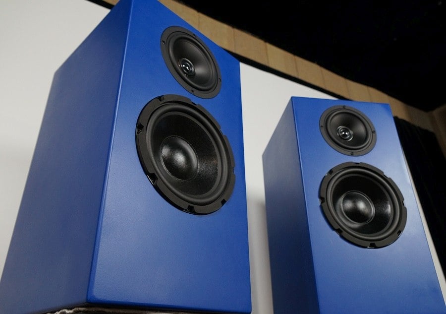

cx3 pair5
The Orian speaker kit from Parts Express largely accomplishes what it promises. Those willing to put in a bit of elbow grease will be rewarded with full-range bookshelf speakers that have a big soundstage and lots of placement flexibility, and they would save a lot of money over purchasing a finished loudspeaker with the same capabilities. A comparable bookshelf speaker completed with a nice finish from a traditional manufacturer would easily cost multiple thousands of dollars for a pair, but the base cost for the kit from Parts Express is $675 shipped (currently on sale for $540/pair shipped). I probably spent an additional $120 for the paint, primer, and extra tools that I didn’t have, and that would have put my pair just south of $800. That is still a phenomenal value in light of the abilities of these speakers. I normally return review units to the manufacturer after the review, but, of course, that is not possible with a kit speaker that has been built, so they are going to be staying with me, and I am happy to have them because they sound great and look cool. While assembling these particular speakers was a bit involved, it was still an enjoyable process overall. If you are looking for a unique loudspeaker and have the time and patience for a project, I think even novice builders should consider the Orian kit. It took me some time to complete, but I think the time and effort were well worth it in the end, not just for the speaker itself but also for the experience of building it.
