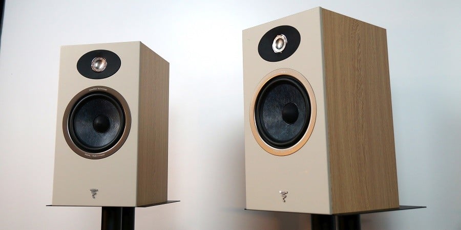

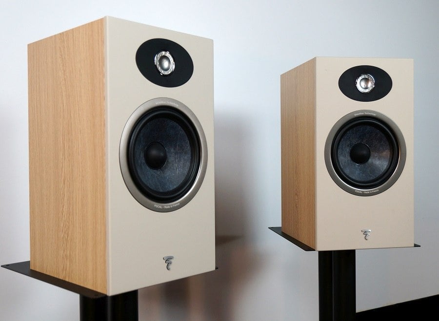

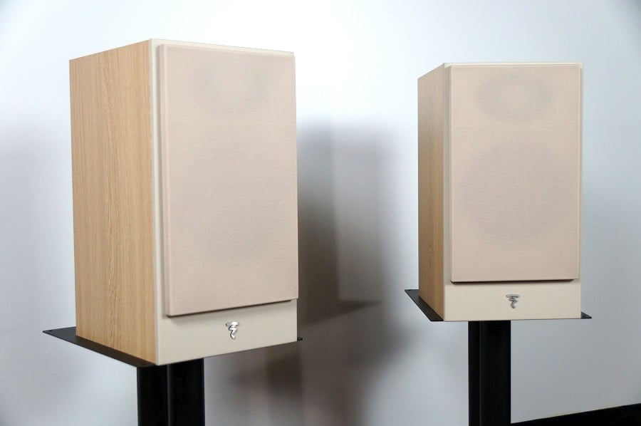

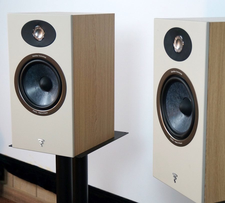

Focal has always been good at making their loudspeakers look stylish, and the Thevas are no exception. They don’t do fancy cabinet curvature on these models, but the finishes and color choices give them a tasteful appearance. I received my pair in the ‘Light Wood’ finish, which uses an alabaster-type off-white color in a satin finish on the front baffle and a light oak vinyl veneer on the side panels. The edges are not rounded at all, so the speaker does have a somewhat boxy appearance. With the grille on, the Theva No.1s have a fairly minimal look as the front baffle is turned into a blank surface aside from the exposed Focal logo at the bottom. With the grille removed, the drivers are revealed, giving these speakers more character. Focal’s Slatefiber cone has an interesting fibrous texture, and it is surrounded by an metallic trim ring that hides the mounting screws. The tweeter dome is an inverted metallic button surrounded by an elliptical waveguide. The grille uses magnetic adhesion, so there are no visible grille guides, which gives the speakers that much cleaner appearance. I think the No.1s look better without the grilles, but the grille might be a good idea to use in instances where pets or children (or irresponsible adults) might damage the drivers.

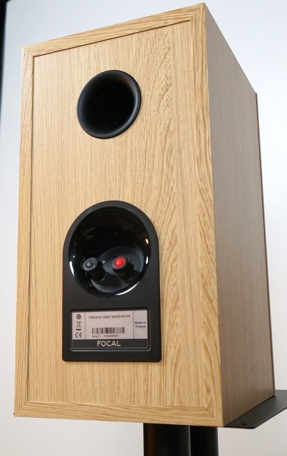

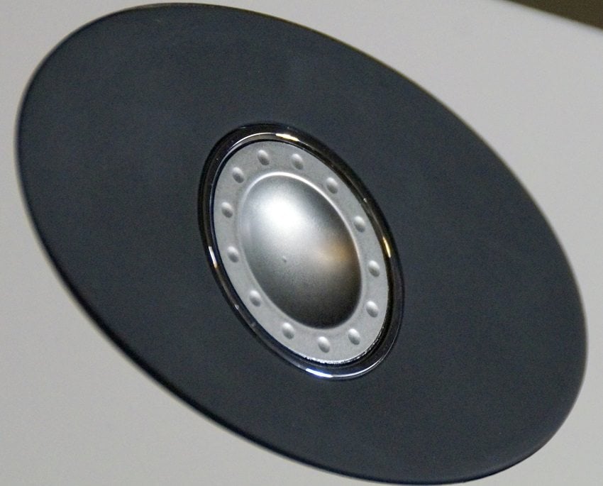

Theva tweeterThe Theva No.1 is a typical 2-way bookshelf speaker that has been given some usual Focal touches. Let’s start a discussion of the details of its design analysis by talking about the tweeter, another inverted 1” dome that is the norm for Focal. They term this tweeter the TNF tweeter, which is Focal’s Aluminum/Magnesium dome plus a couple extra touches. One touch is the use of Poron, a material with shape memory, as the surround. Focal claims that the Poron surround reduces distortion in the 2-3kHz range by a factor of three. That is where distortion would be highest for the tweeter given the crossover frequency in the Theva No.1s, so this element should be beneficial. Focal has also given the TNF tweeter a waveguide that optimizes its horizontal directivity. Focal claims the inverted dome shape already has a lower directivity than normal convex domes, and Focal enhances this on the horizontal plane with a shallow waveguide that has some mild shaping on the vertical plane.
 Theva cone

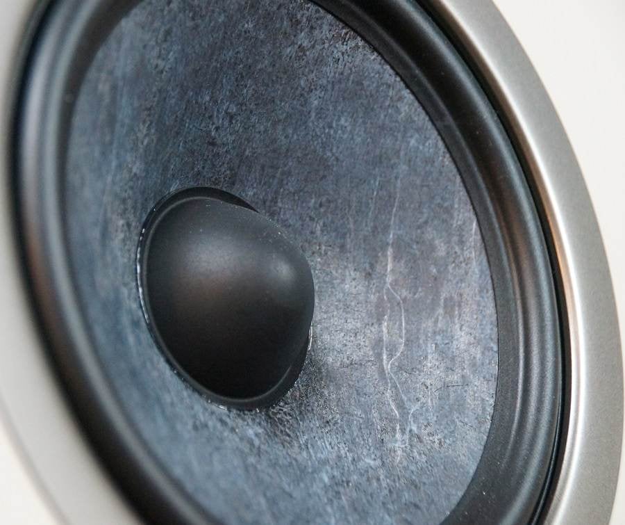

The woofer is a 6 ½” cone that uses Focal’s Slatefiber cone material that was developed for the Chora loudspeakers that the Theva series now replaces. Slatefiber is a composite of non-woven carbon fibers with a thermoplastic polymer. It offers a good combination of rigidity and damping, and this should enable the cone to hold a uniform shape up to high frequencies.
Theva rearThe tweeter crosses over to the woofer at 3kHz, which is a somewhat high crossover frequency for a 6 ½” woofer. However, if the woofer is well-engineered, it may be able to take those upper frequencies without hitting bending modes in an audible manner. It’s probably not an ideal frequency for a perfect directivity match with a 1” dome tweeter, but the directivity mismatch may be too mild to matter, and other factors will have an effect here as well. Such a high crossover frequency will benefit dynamic range by lifting the tweeter’s bandwidth above frequency ranges that it would struggle in. A 6 ½” woofer barely has to move at all to reproduce anything above 2kHz loudly, but for that same range, a 1” dome would be heavily taxed at loud levels. Focal has moved the tweeter’s bandwidth into a very comfortable range, so the Theva No.1 should be able to play nice’n’loud. I would expect its dynamic range to be limited mainly by the low end of the woofer’s bandwidth.
I wasn’t able to get a look inside the enclosure of the No.1s because I wasn’t sure that I could access it without damaging the speaker. It’s an MDF construction, and the side panels look to be ⅝” thick with the front baffle adding a quarter-inch on top of that. It feels like a reasonably solid bookshelf speaker, but it doesn’t feel as boulder-ish as some other pricier bookshelf speakers. The feet are some half-dome rubber pieces that should do well in damping vibrations from affecting the resting surface. These feet are optional to install, and you can just leave them off. The binding posts are just a simple 5-way pair that is set in a terminal cup. Thankfully, Focal has opted for sanity and only has one set of posts per speaker, so there is no bi-wiring or bi-amping with the Theva No1s, and that is a good thing.
Much of the success of the Theva No.1 will depend on how the drivers behave and how well the crossover circuit controls them, and these aren’t something that can be seen but rather heard and measured. So then let’s take them for a spin to see how they sound…

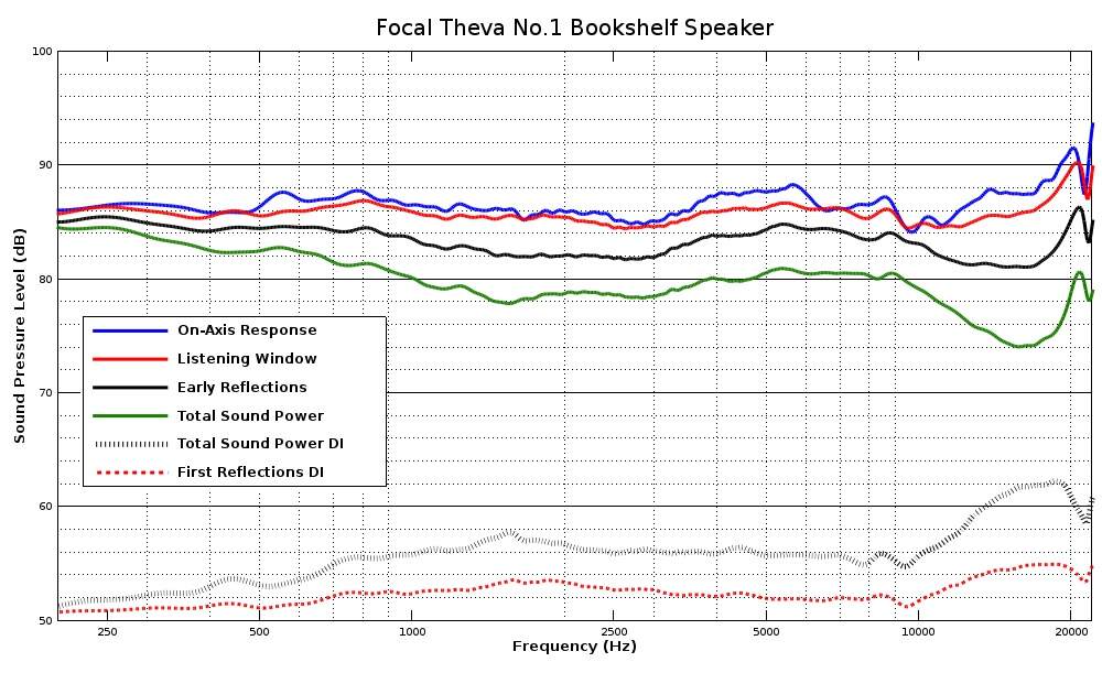

The Focal Theva No.1 speakers were measured in free air at a height of 7.5 feet at a 1-meter distance from the microphone, and the measurements were gated at an 11-millisecond delay. In this time window, some resolution is lost below 250 Hz and accuracy is completely lost below 110 Hz. Measurements have been smoothed at a 1/24 octave resolution.
Theva spin o rama
The above graph shows the direct-axis frequency response and other curves that describe the Theva’s amplitude response in a number of ways. For more information about the meaning of these curves, please refer to our article Understanding Loudspeaker Measurements Part 1.  The measured response here is good overall. The on-axis response has a few rises and dips, particularly at 4kHz and above, but the listening window curve, a far more important metric, is smooth all the way up to nearly the top end of the speaker’s bandwidth. Likewise, the early reflections curve is also quite linear, and that means the sound reflected off of in-room surfaces from this speaker will have a balanced tonality (so long as the surface absorption response is even). In other words, this speaker is friendly to a wide variety of acoustic situations and does not need any special acoustic treatments to sound good in normal rooms. The directivity indexes are also fairly even, and this indicates that the sound radiating outward at all angles is very uniform. That makes the Thevas especially amenable to equalization.

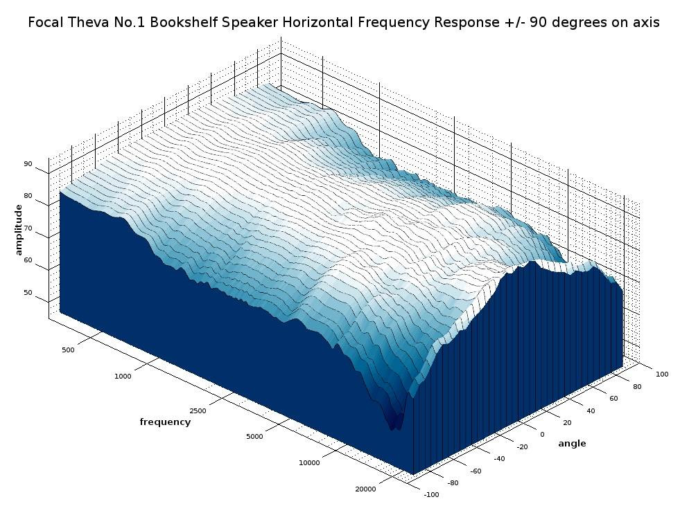

Theva 3D waterfall response2
Theva 2D waterfall response

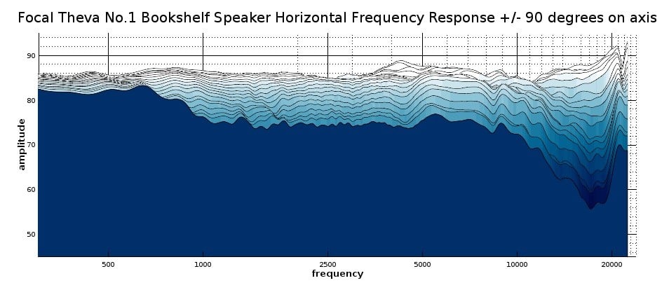

The above graphs depict the speaker’s lateral responses out to 90 degrees in five-degree increments. More information about how to interpret these graphs can be read in this article: Understanding Loudspeaker Review Measurements Part II. In these graphs, we get a better look at how the on-axis response and nearby angles compare to the off-axis responses. We can see how the on-axis response is a bit more rugged than the off-axis responses, which overall are fairly even. One interesting feature is the very slight elevated region from 5kHz to about 8kHz in some of the further off-axis responses. We also see the high treble response shoots up a bit above 12kHz near the on-axis angles but has almost an inverted response at off-axis angles. At around the 20 to 30-degree angles, this all levels out, and you get a nicely flat treble response in that region. The most even response for all angles occurs at around the 20 to 30-degree angle range, and this is about where a listener would be if seated in an equidistant triangle position with the speakers facing straight ahead in a parallel direction. I listened with the speakers facing straight toward me and thought they sounded fine, but the best response for most listeners would probably be had with no toe-in. The bottom line is that the Thevas provides a nicely flat response for most listening angles, especially in the all-important midrange, which is extremely neutral.

The evenness of the dispersion be the Thevas is very impressive. It’s not perfect, but the flaws do more to highlight the strengths than call out defects. The beamwidth hovers around 60 degrees with some deviations. There seems to be a bit of excess dispersed energy from 5kHz to 8kHz, as we saw before, and some slight waistbanding around 2kHz. These don’t occur in large amounts, so I don’t expect them to seriously skewer the in-room response. One remarkable aspect of these measurements is how the tweeter behaves above 5kHz. Most 1” dome tweeters start to collapse their dispersion at around this point, but Focal’s inverted dome tweeter doesn’t even start to beam until above 11kHz. That means this speaker will hold a very full sound out to a wide angle, so there is a lot of flexibility where listeners can be positioned without losing much in the way of balanced tonality. If you want to get hit with high treble, you should probably be seated within a 30-degree angle of the front-facing direction of the speaker. The bottom line for this graph is that the flaws of this speaker’s dispersion are minor but the strengths are major.

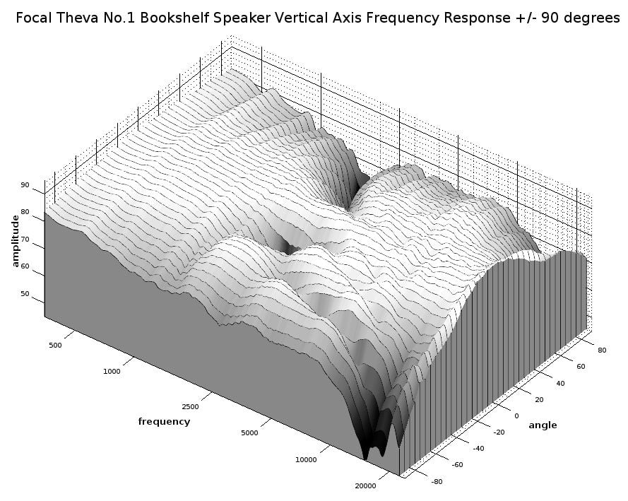

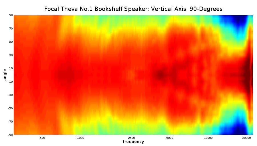

Theva 3D vertical waterfall
The above graph shows the Theva’s response behavior along its vertical axis where zero degrees is directly in front of the tweeter, negative degree values are below the tweeter, and positive degree values are above the tweeter. The crossover nulls where the woofer and tweeter start fighting don’t take very long to happen as we move off-axis on the vertical axis. For a balanced sound, listeners should be seated within a 5-degree angle below the tweeter to a 15-degree angle above the tweeter. Interestingly, the flattest response actually occurs just above the on-axis angle, at a 5 to 10-degree rise. That means that the most neutral sound from the Thevas happens just above the tweeter’s height. Those who are using these as front left/right pairs should opt for a shorter speaker stand, not a tall one. If you can just barely see the top of the Theva enclosure, you are probably listening around the optimum angle. Make sure you are not listening at lower angles than the tweeter as the crossover cancellation is already taking a big bite out of the midrange at 10 degrees down.

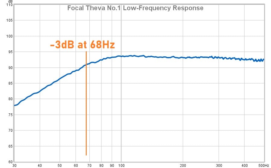

Focal Theva LF Response
The above graphs show the Theva’s low-frequency responses that I captured using groundplane measurements (where the speaker and microphone are on the ground in a wide-open area). There is pretty much just good news here unless you are looking for low-frequency extension. This knee of the response is right below 80Hz, but it is a very gradual decline, almost like what we would see from a sealed loudspeaker. I imagine that this speaker is a bit underported so as not to have too much of a bass boost at port tuning, a fact for which I am grateful since I don’t care for the sound of small speakers that make up for low-frequency extension with lots of port output. As I stated before, I managed to get a good response down to nearly 50Hz with these speakers, and I would attribute that to the gradual slope of the roll-off. I would expect other users to get a bit more than that because my room doesn’t get a lot of low-frequency gain. The response down to the knee is beautifully flat and neutral. This is an excellent bass response for a bookshelf speaker, and there is not much else to say.

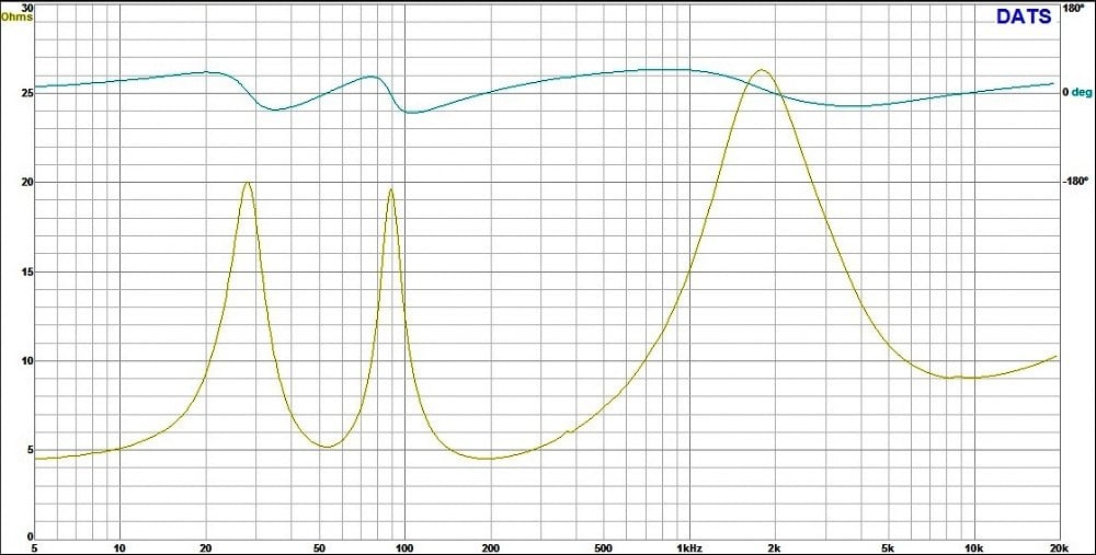

The above graph shows the electrical behavior of the Focal Theva No.1s.  Focal specifies this speaker as being 8-ohm nominal with a 4.6-ohm minimum, and I largely agree with that. This is an extremely benign electrical load. The impedance minima almost but not quite touches 4 ohms at about 200Hz and then shoots up to 35 ohms at 2kHz. Any amplifier, even very inexpensive ones, could handle these speakers with no problems. We can see from the dip in the low-frequency saddle that the port tuning is just above 50Hz. We can also see from the peaks in the saddle that the resonant frequency of the enclosure is well-matched with the resonant frequency of the bass driver. This impedance and phase response is nearly ideal for a two-way bookshelf speaker.
I measured sensitivity to be 88.5dB for 2.83v at 1 meter which is a touch below Focal’s sensitivity specification of 90dB, but they don’t specify watts or volts or any other criteria for their measurement. Despite the ambiguity of their sensitivity spec, we have good agreement, so I would imagine that the standards by which we are reporting are very similar. The Thevas have an unusually high sensitivity given their size and low-frequency extension, especially given their nominal impedance. It doesn’t take much for an amplifier to get these things loud, and the Thevas don’t take a major toll on the amp to do so as well. Focal is pushing Hoffman’s Iron Law to the limit here, and this engineering is excellent!

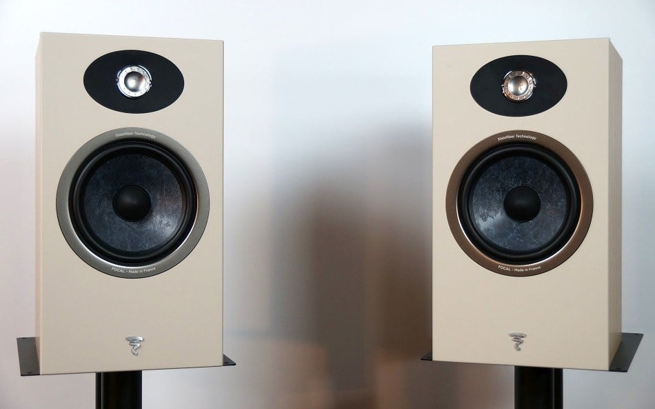

Theva pair19Before bringing this review to a close, I will quickly go over the strengths and weaknesses of the product under evaluation, and I will start with the weaknesses. The Focal Theva No.1s don’t have many weaknesses to speak of, a good thing considering their $1k/pair pricing. While we have reviewed bookshelf speakers plenty more expensive than $1k/pair, it is still not a sum that most people can spend on a whim. So it’s good to see that those who spend their hard-earned cash are rewarded be something that is so well-rounded.
So are there any flaws? If I am being really nit-picky, I would say that the asymmetry of the phase coherence of their vertical lobe can be a slight problem for anyone listening under the tweeter axis. That can be a problem with tall bookshelf speaker stands for front left/right or raised wall mounts for surrounds. These speakers should be listened to at or just above the tweeter’s height. Another very minor nitpick would be that they don’t feel as substantial as some other speakers in their price class when you pick them up or handle them. I would have expected speakers of this pricing to have a bit more heft, although weight or mass doesn’t necessarily translate into better sound quality. The finish is OK, but I would rather have had a solid painted color rather than an imitation wood vinyl veneer at this pricing. However, these are all small matters, and I don’t have any complaints of real substance against the Theva No.1s.
Moving on to their strengths, their best attribute is their sound quality. They have an accurate sound that doesn’t do much to color the recording, so listeners get a balanced presentation of the source content. This even sound character extends over a wide horizontal angle, so the speakers have a good level of coverage over a broad area. In other words, there isn’t a bad seat in the house with these speakers (within reason). They have a good level of dynamic range for such reasonably sized bookshelf speakers as well, and they can get louder than would be expected for their size/price class. The bass extension is good for this category although not extraordinary. The low 50Hz range is about what would be hoped for and that is fine for most acoustic music but for deep bass, users should add a subwoofer.
One surprising aspect is their relatively high sensitivity yet easy electrical impedance load. That means these speakers will work great with just about any amplifier out there. They are a great candidate for a surround sound system all running off of a mid-tier AVR amp, because you could put a lot of these speakers on the amp without causing strain, a real advantage in an era of shrinking power supplies and growing channel counts. Many smaller speakers achieve higher sensitivity through low impedance but not the Theva No.1s. Remarkably, they manage to pull off such a feat yet still retain decent bass extension.
Aesthetically, they are fine, and with the finish options available, there should be something from the Thevas that fits well in a wide variety of interior decors. Their reasonable size is a real bonus too to get a passing grade in spouse approval. While they are not tiny speakers, they aren’t large ones either, and they pack a lot of punch for their size.
 Theva pair18
As with many other products that I have reviewed from Focal, the Theva’s are an eminently competent design and are sure to please. There are no significant missteps with these speakers, and they have aspects where they really shine. For many regular folks, $1k is a lot of dough for a pair of bookshelf speakers, but the Theva No.1s have earned their pricing. Were I looking for a pair of bookshelf speakers in this price class, I would strongly consider them.
