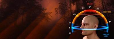

Auro 3D presents a "dome of sound" to the listener.
Auro-3D is all about a totally new sound experience that surpasses anything you’ve heard before. By fully immersing the listener in a cocoon of lifelike sound, Auro-3D creates the sensation of actually 'being there,” along with the best reproduction of color/timbre using the most efficient speaker layouts. The Auro-3D format is designed as a cross market solution with fully compatible and scalable speaker layouts based on the size of the room, and built on the specs of today’s 5.1 and 7.1 surround standards for professional cinema as well for home cinema. The groundbreaking Auro-Codec® technology is a key part of the Auro-3D format, and allows an easy integration in all audio markets (film, games, music, broadcast, etc.) without any need for changes in specs, bandwidth or delivery formats (existing Blu-Ray format etc.). This unique technology allows us to bring an “Immersive Sound” experience to all markets with high resolution audio in all channels.

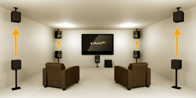

The next differentiator is that our Height Layer uses speakers in front of and beside the listener. Ceiling speakers are only needed for the” Voice of God channel” (directly above the listener), which is not a necessity in smaller home theaters. Installing height speakers thus far has never been a problem, in many hundreds of locations. At home, there is often room above the corner speakers of a standard 5.1 surround setup. Of course, if people don’t want to see cables on the wall, we have solutions for that, including wireless powered speakers.

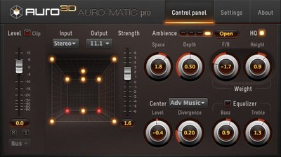

Quality of Auro-Matic up-mixing
The Auro-3D Engine also includes Auro-Matic®, which allows legacy content that people have at home in mono, stereo, or 5.1/7.1 to be automatically up-mixed in the Auro-3D format. Developments since 2006 have made this algorithm into what we feel the most natural sounding up-mixer available. It is impressive how even mono up-mixed to Auro-3D sounds incredibly natural, without changing the artistic intent of the original mix. There is no addition of distracting reverbs or changing the tonal spectrum or dynamics like other up-mixing algorithms typically do.
Auro-matic up-mixes legacy content into the Auro-3D format.

Wilfried: First of all, to create the most immersive sound, you don’t need sound from the ceilings but a vertical stereo field in front, sides and behind the listener between ear-level and a height of about 30°. The sound bouncing off the ceiling can never create the same quality of sound reproduction. Of course we looked into that as well, but we don’t like to make false promises. This doesn’t mean the effect won’t work, but it is not comparable with the real thing.
Elevated sounds cannot be created as vertical phantom sources without the use of psycho-acoustic effects like those used in the horizontal plane by using ‘sound bars.’ The quality of sound bars in the horizontal plane is not comparable with a 5.1 or 7.1 speaker system, and it will be even worse using that technology for the reproduction of height. The use of such psychoacoustic effects (like notch filters) will always have a bad influence on the original sound quality of those height channels. The modes of the low to mid frequencies down to less than 300 Hz are key for our brain in spatial sound processing. The material of the ceiling has to reflect all those frequencies in the same way, as if the sound were coming from a height speaker. That is impossible. For that reason, above the ear-level layer we use a Height layer with speakers around the listener to enable the reproduction of the elevated source sounds as well as the most important native true 3D reflections around those source sounds.
Auro-3D supports various speaker layouts for the home, ranging from their Auro 9.1 setup for most home installations, up to Auro 13.1 for larger home cinemas. Auro 9.1 is based on a standard 5.1 Surround setup for the lower layer, augmented with four height speakers, sometimes referred to as the quadrophonic sky, positioned at 30º above the front left and right speakers. This setup is considered to be the minimum setup for real “Immersive Sound”, with a level of realism that can barely be surpassed by any other system given that the majority of the immersive effect is created by the interplay of the lower and height layers. From Auro 10.1 onwards, the speaker setups also have the third layer on the ceiling, to complete the ‘dome of sound’ all around the listener. This top channel is then mostly used for special effects such as fly-overs, similar to what happens in reality. The well-defined and fully compatible speaker layouts of the Auro-3D format for cinema and home guarantees the same immersive sound experience as it was originally intended by its creators.
